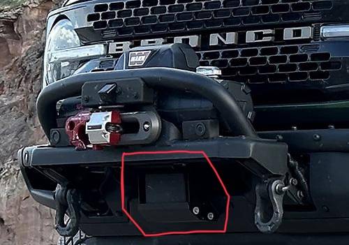

Additionally, the Factory55 Superhook sales material has this image (highlighting my own)….
Ford Bronco Factory Winch Kit + ACC Relocate Question IMG_0057
What gives? Anyone ever seen or know about the highlighted ACC relocation (that is obviously well engineered). Searching turned up nothing… Is it out there somewhere? Is it a one time mockup that Ford decided wasn’t cost effective? Anyone got some inside baseball here? Failing information about this, or success with stock ACC mounting, I’m leaning toward a custom mount for the ACC radar under the winch that can pivot up when I need the clearance for wheeling. Thanks in advance and look forward to seeing you all on the trails… (Anyone doing Off Roadeo in TN on 7 Nov?)

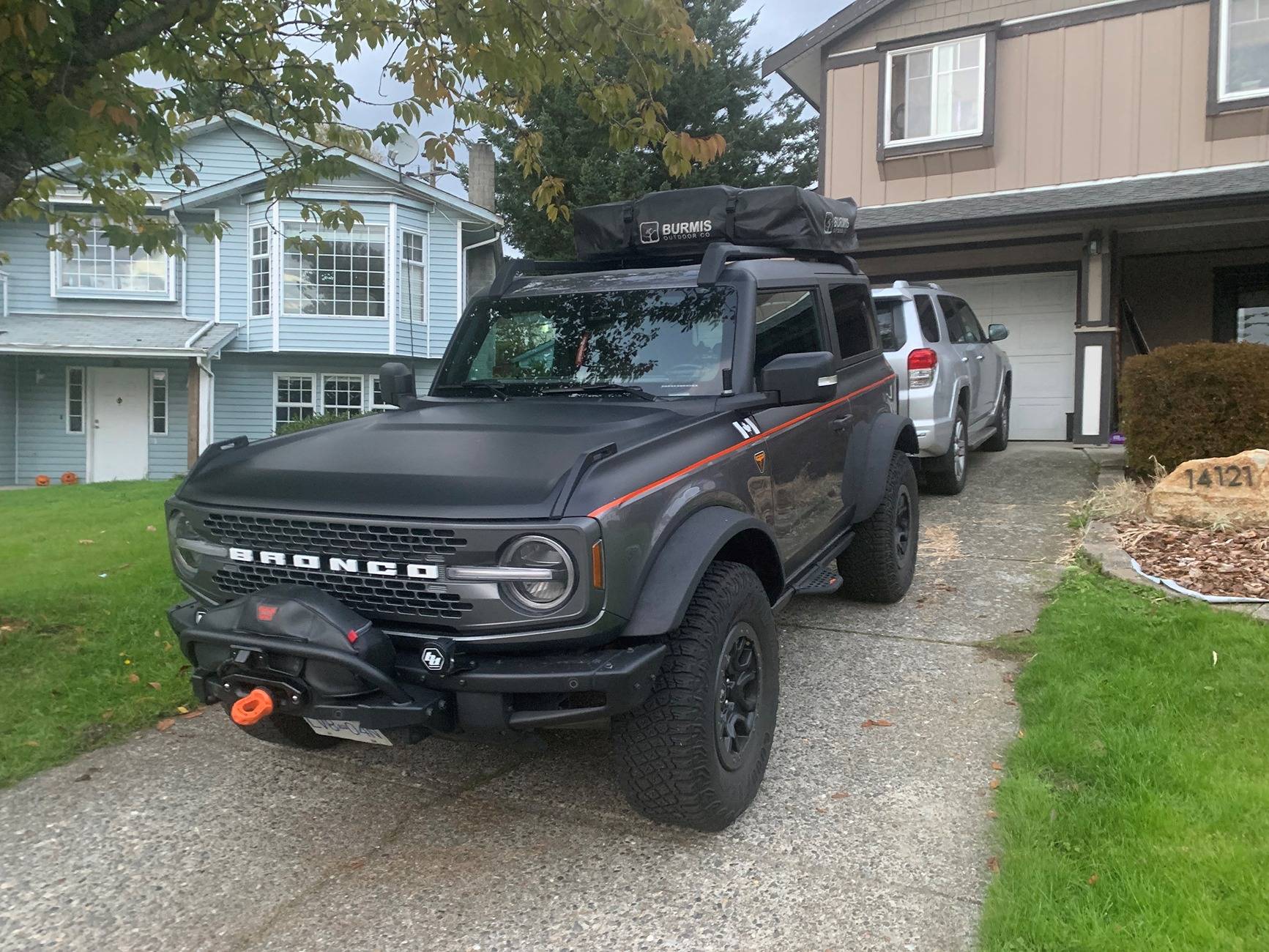

No need for relocation, mine works as intended!
That’s great news…. no adjustments made to the radar at all? I wonder if Ford just couldn’t guarantee operability, so they said No installs with ACC? I would just hate to put it all together then have the radar error out on me lol.
I have no idea, but the winch doesn't block the sensor at all, only upward view is restricted, which doesn't matter.

I just put the winch on my lux badlands. My ACC still works fine. I did notice a slight reduction in range of the radar. On the cluster you can see when a vehicle ahead comes into radar range. This range seems reduced. However, its still plenty for ACC to work as expected.
