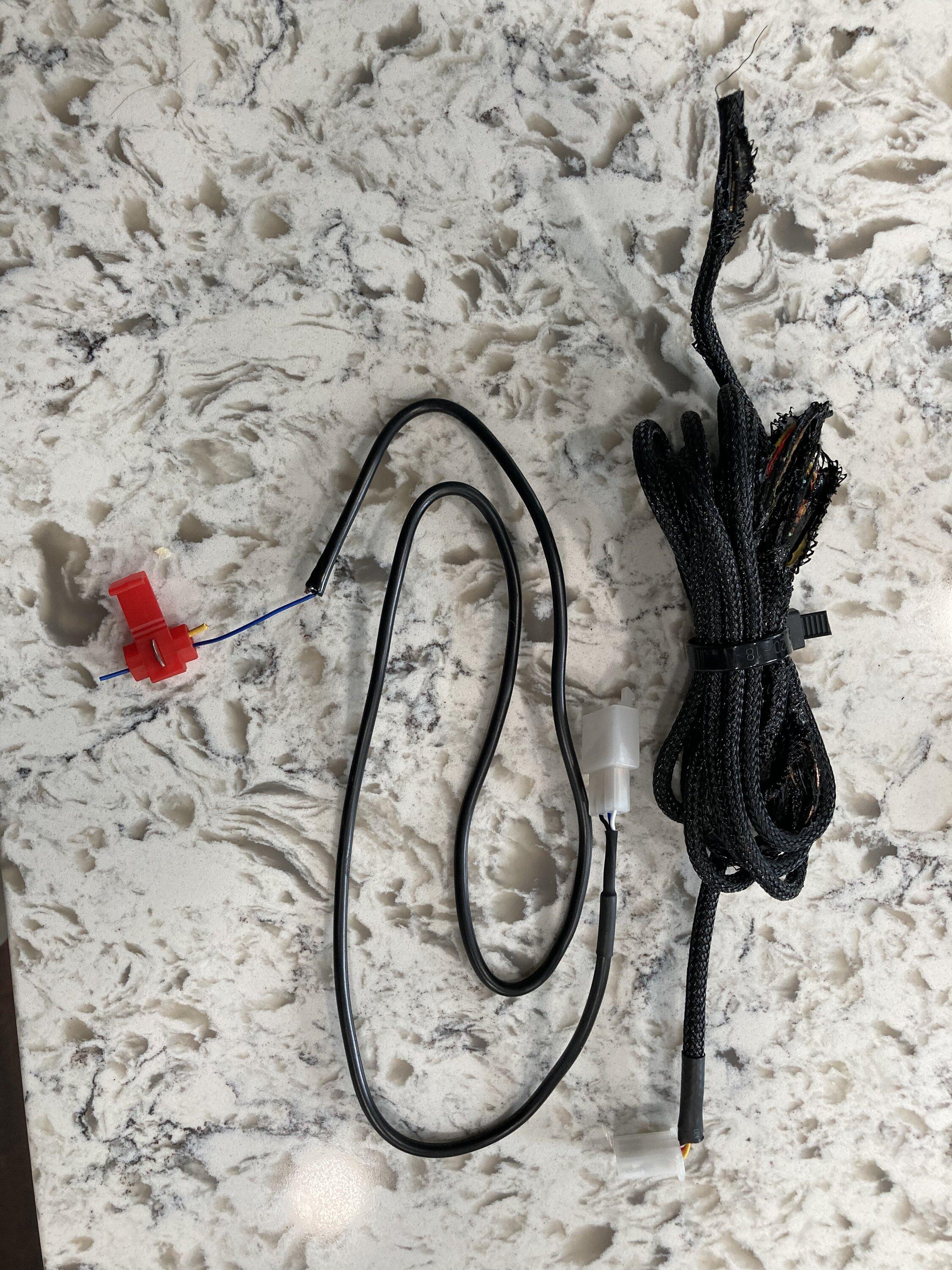

In this first picture, these are the wires downstream of the relay used to connect the two LEDs to the battery and the switch runs. This is the switch run (split in half - connected at the two white plugs). These are the wires that turned RED HOT and melted. I cut it short of the relay.
Ford Bronco Fire averted! 6A2E5F94-AF31-4EED-A6D6-06378F89CD10

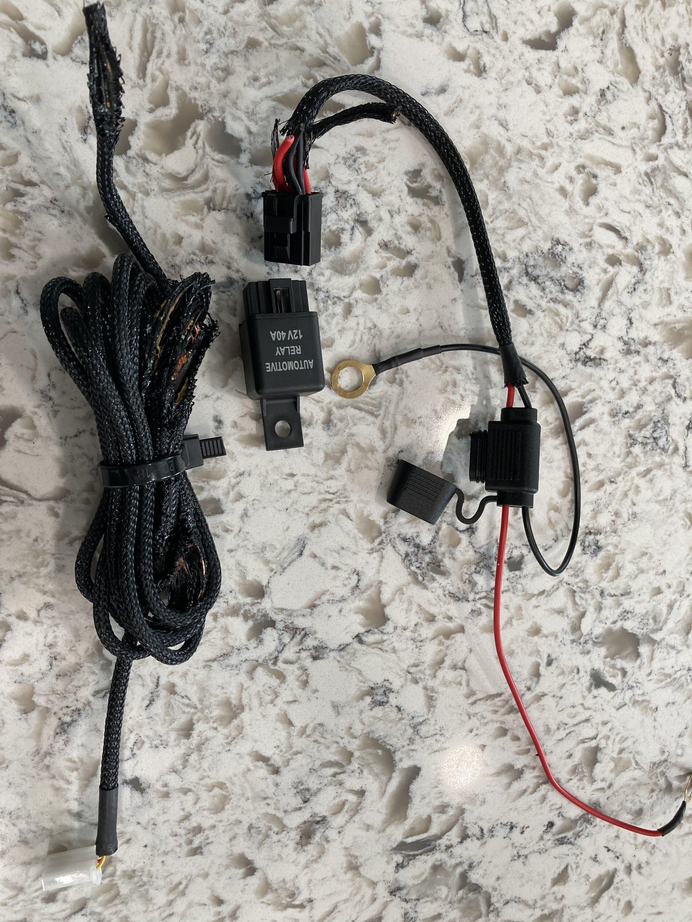

in this picture, you can see the relay that brought everything together, and the run to the battery with the inline fuse. None of these wires achieved ignition temperature, and were normal to the touch while the switch run got hot.
Ford Bronco Fire averted! 9A92031C-0888-492B-934A-8C273C913440

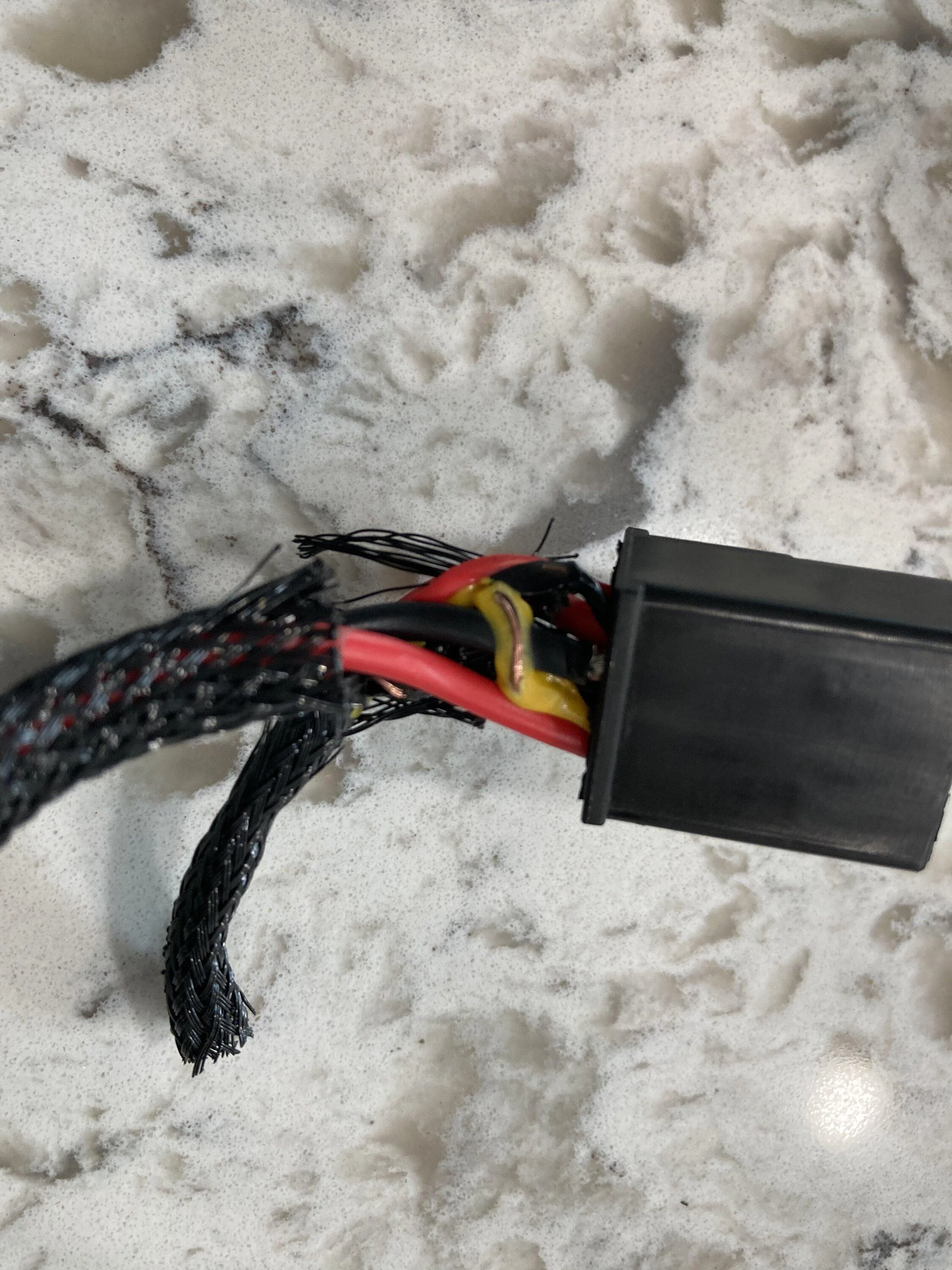

here’s a close up of the relay inputs (I carefully pulled away the black sheathing & insulation) with a view to the melted switch run wiring.
Ford Bronco Fire averted! F959A244-EB95-4CFC-83D3-428F1E715145
I appreciate any expert diagnoses you may be able to offer. Thanks!

Okay, without being there to totally dissect the burnt harness. it looks like the short occurred on the yellow lead in the aftermarket switch harness, maybe even in the coil of the relay. The rating 12V 40A printed on it refers to its switching capacity, not the rating of the coil.
From the looks of it, it was designed to have switch energize the coil of the relay. Was there a switch on the aftermarket harness that you removed to do the wiring? This indicates to me that the relay is energized by the switch and it closes contacts that power the lights; which is not needed with the Ford factory Aux switches, they have their own already installed.
It also looks like you were using Aux #1? If so that is a 25 amp circuit, After re-reading your OP,I see you are using Aux#6, 5A but still plenty of power to cook wires/relay coil if they are undersized/not rated for it or even mis-wired due to a mis-understanding of the Ford upfitter wiring. When you pulled the fuse, there still was power to the relay from the Aux switch leads, thus it continued to cook. One thing to know about splices is if they are poorly executed, the resistance is higher, causing heat to build up and damage things, thus possibly leading to a short.
I saw the aftermath of a poorly executed splice on a 355 VDC system that was using 4 aught cable (really big stuff), the bad splice eventually shorted to ground and a fire broke out that destroyed the entire cable bank. estimated damage ~1.5 million dollars.
