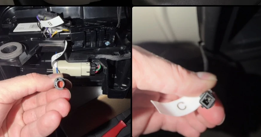

Hey everyone. I got tail lights from form lighting and trying to install but having an issue connecting the C cords which is required for halogen models (I have a big bend). The 2 cords do not match though. They aren’t connecting and I’m wondering if I’m doing something wrong. Let me know if anyone has installed these before.

I installed these a year ago, and both of my C connectors at the taillight are round. It appears the connector on your halogen adapter wiring harness is incorrect (assuming you already have the other end connected properly into the factory third brake light harness). I would reach out to Form / Diode Dynamics if that's the case 😕.

I put these on my 2022 Bronco with halogen tail lights. Remove the gray packing insert on the black plug. Use your fingernail or use a small pick to slide it out. Be careful. No where does it tell you that they inserted these little plugs. I just happened to figure it out after an hour of frustration. Hope this helps.
