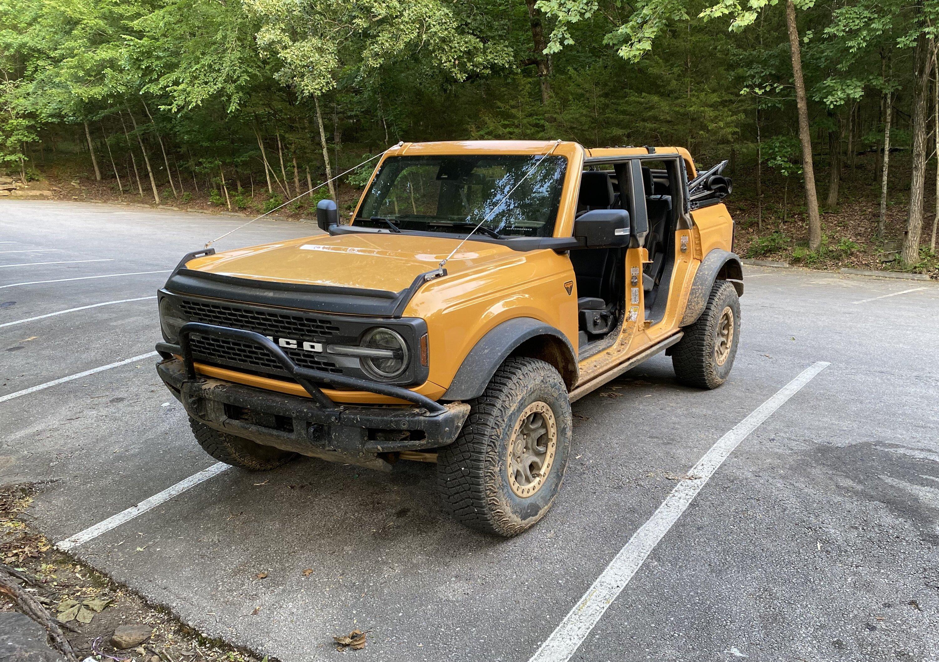

I just installed and wanted black, as well. So I shrink tubed them. They turned out good.

That does look nice. Little powder cost or paint on the brackets and would be a win or me. TY!
