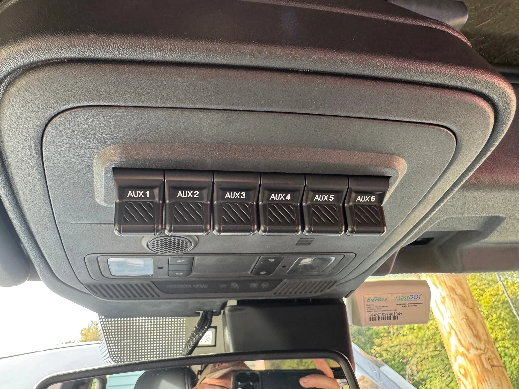

Watching because very interested in Pic one to get some switches in a decent location like higher trims have....

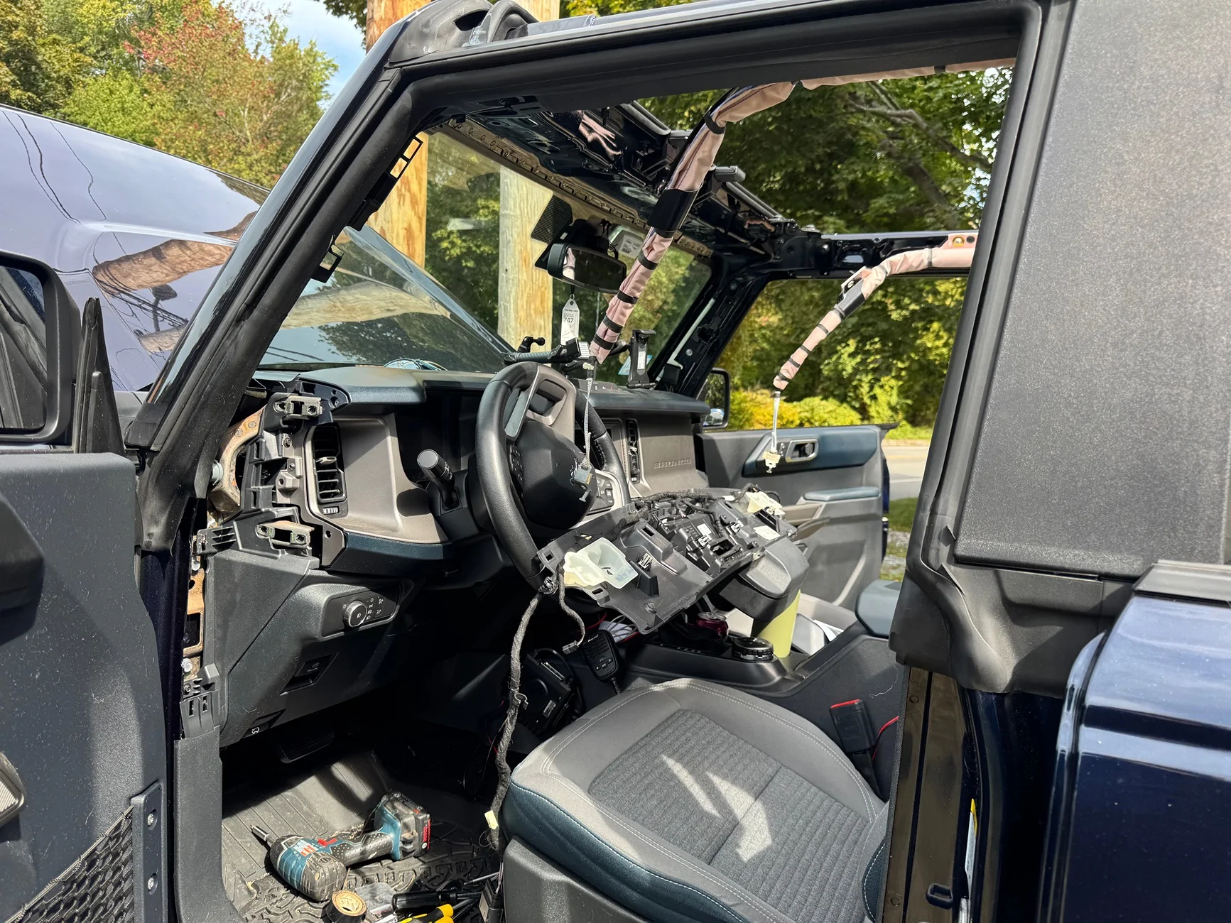

Not a fan of Pic 2... I've done worse when I was younger but is that just the pic from their page or what you really needed to go through.

Yes that pic number 2 is what you need to do to get the overhead switches installed. Everything comes out and even some air bags have to dangle.

I just spent the day installing the Hanspilot switches, a Wolfbox review cam and rewiring my rear fogs. The switches took maybe 1.5 hrs to install but I only had to take the left side apart, the right column and airbag don't need to be removed. It look much worse than it is but I will say Ford came up with the crappiest design for the roll bar trim pieces. I know they can't "connect" because the airbag needs to blast through there bit there needs to be a more secure way to keep things tight. The relay box has a wire loom with 6 switch wires coming out of it. I used one to hook up to my existing rear fog wire but I plan on using the factory ran switch wires when possible going forward. No fuse box needed.
All in all- what a great system. Horrible instructions but great design and very high quality as well.
