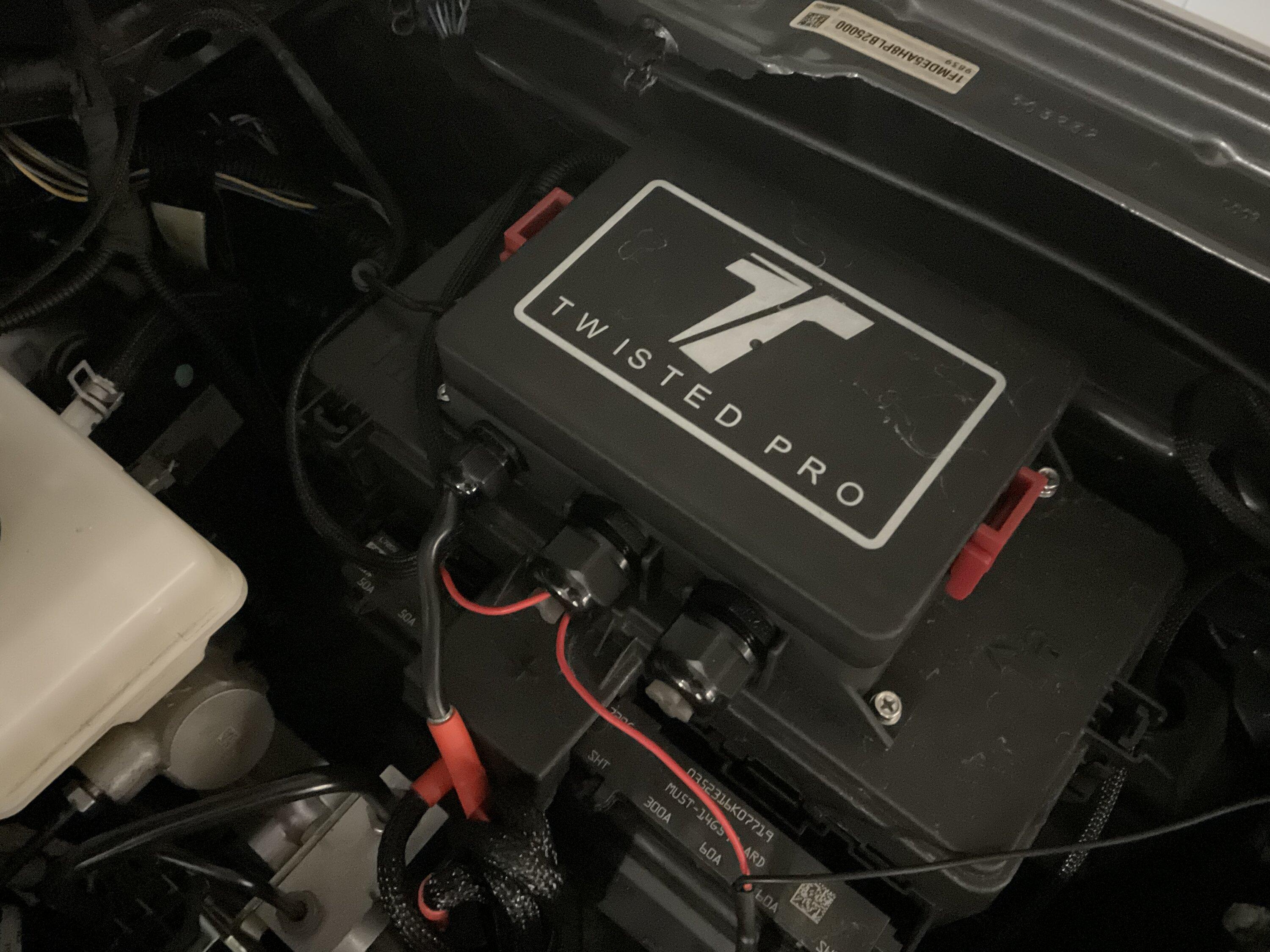

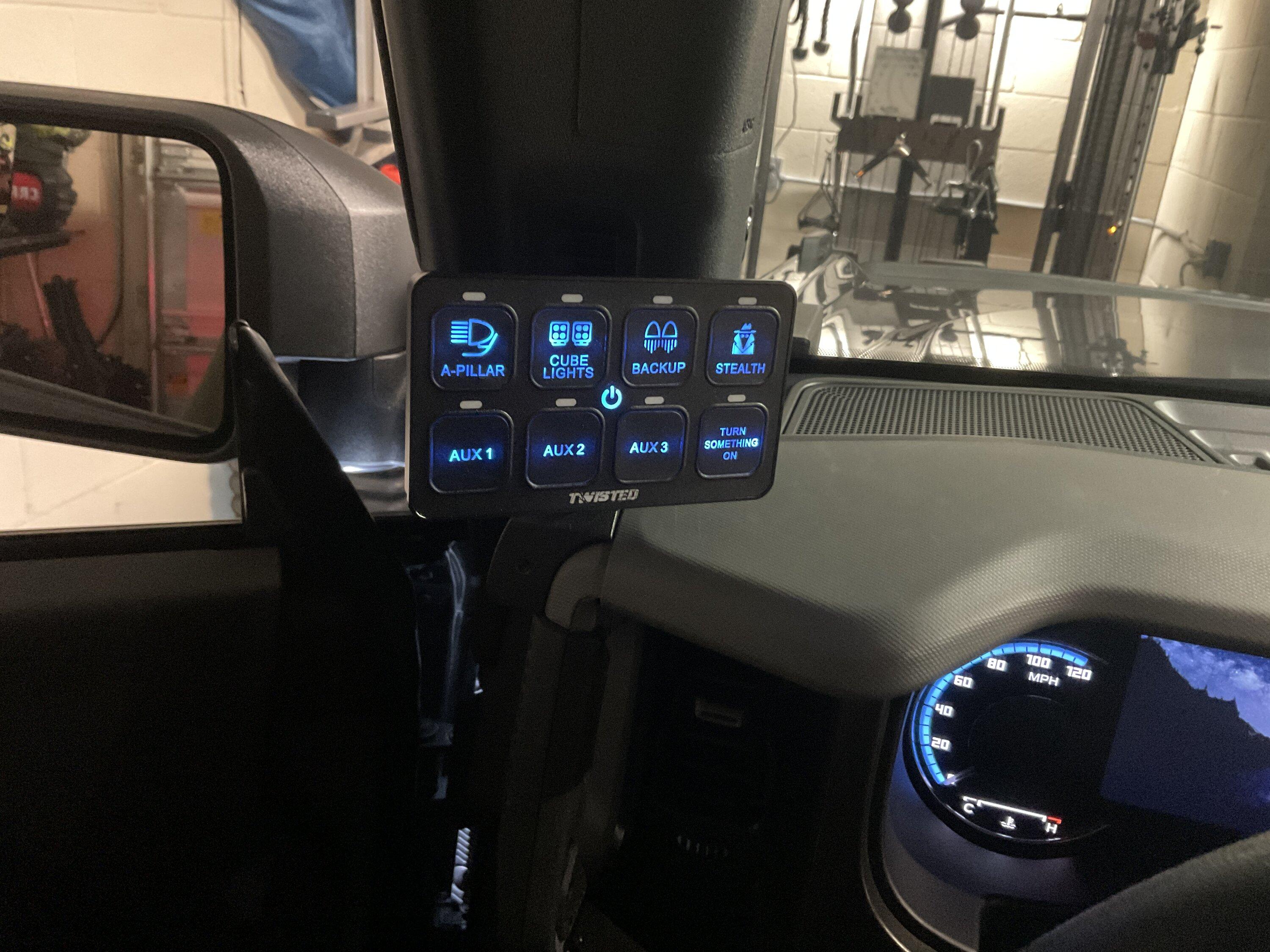

I researched adding the OEM aux switches since mine came without them (the only option I ordered). AS mentioned you need the harness, switch/console, and a new fusebox for $900. At the time the fusebox was not available. The install looked fairly easy. I decided to just go with an aftermarket controller for $299.00. I was only going to add a coupe of items anyway so this was the easiest path for me.
