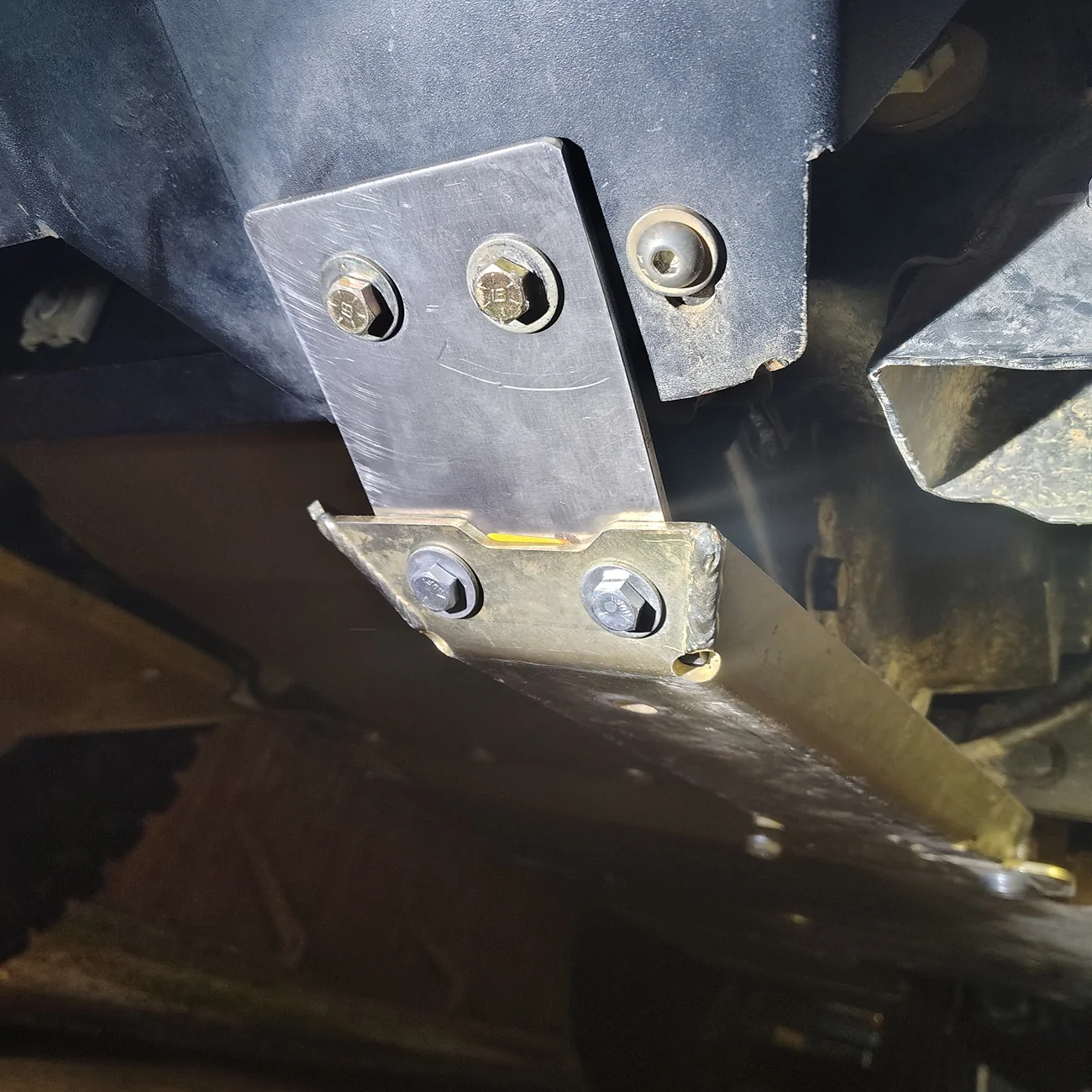

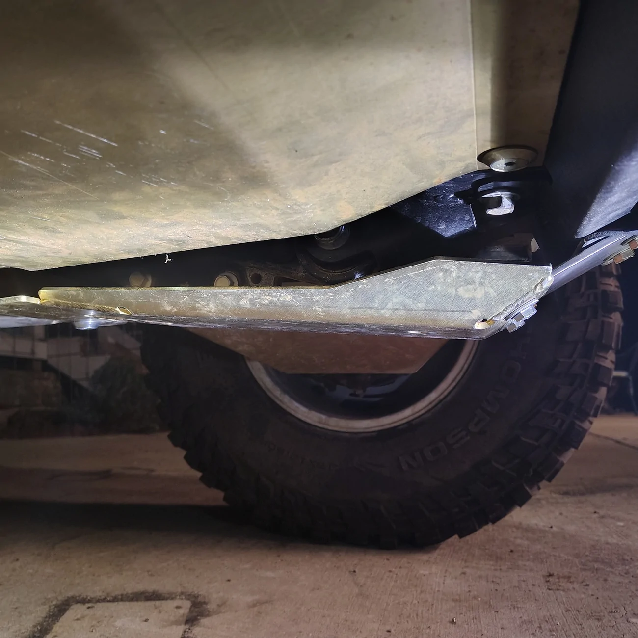

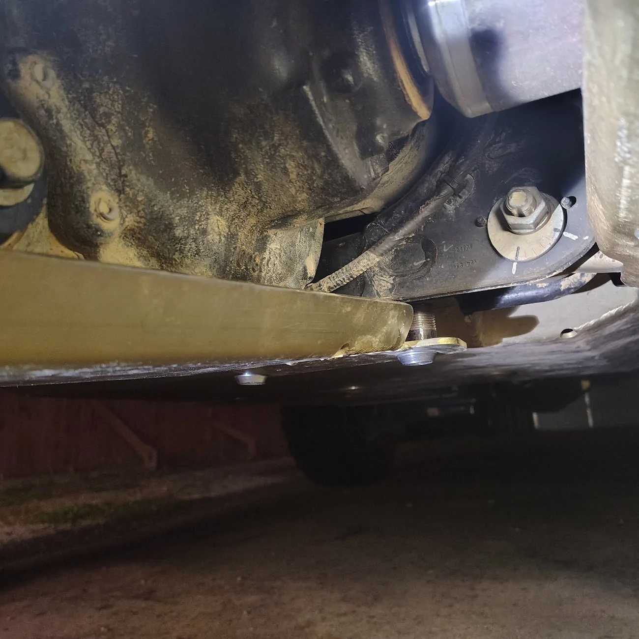

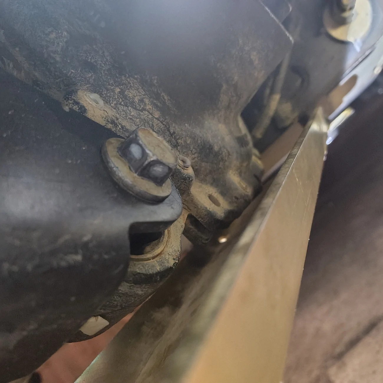

Anyone have pics installed with skid plate mods? I have ARB skids, just wondering what all would have to be modified on them. Not nuts on chopping them up being I just bought them. 😅
This is what I did with my MetalCloak diff skid plate, not final, just trying something out. I've been sick for 2 weeks, so haven't had a chance to get back out there to change it up.
Ford Bronco Homemade Diff Drop for 6G Bronco IMG_20260113_180919916_HDR
Ford Bronco Homemade Diff Drop for 6G Bronco IMG_20260113_180928417_HDR
Ford Bronco Homemade Diff Drop for 6G Bronco IMG_20260113_180941331_HDR
Ford Bronco Homemade Diff Drop for 6G Bronco IMG_20260113_181017491_HDR
I bought a piece of rectangular steel tubing for the rear, as I hope it'll be more rigid than the 3/4" pipe that I used as a test. Stock steel plate in the front is same thickness as MC's skids. The hex bolts are just temps, as that's all I had when mocking this up. I have ordered the something like MC uses.
