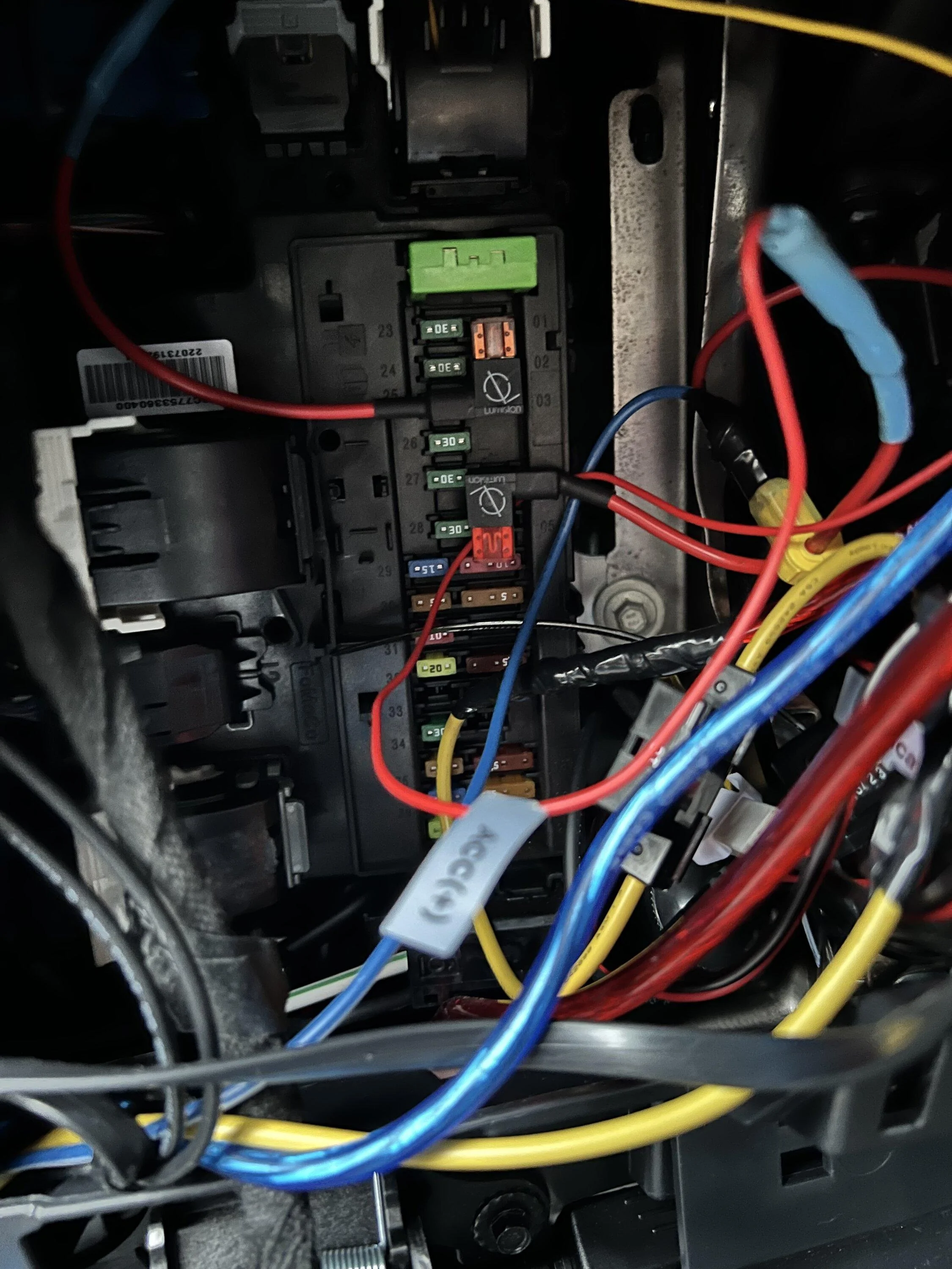

Is interior fuse number 4 switched so when I turn off the bronco it shuts down? It seems to stay on? Is there a timeout?
I am working on things so wire management is not there quite yet ;)

I switched it out to port 35 off another thread and that one is switched, so if you’re wanting to make sure you’re remote wires or anything that needs to be switched off does use fuse 35 on the interior fuse block
