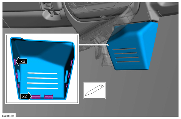

I looked in the fourms and did not see anything on this. I want to remove the IPMA Cover above/behind my rearview mirror to run some wires underneath. Has anyone done this before? Should it just snap right off with a trim tool? TYIA

Image Processing Module A (IPMA)
Special Tool(s) / General Equipment
Interior Trim Remover
Removal
NOTE:
Removal steps in this procedure may contain installation details.
  1. Using the interior trim remover release the tabs and remove the IPMA cover.
    Use the General Equipment: Interior Trim Remover

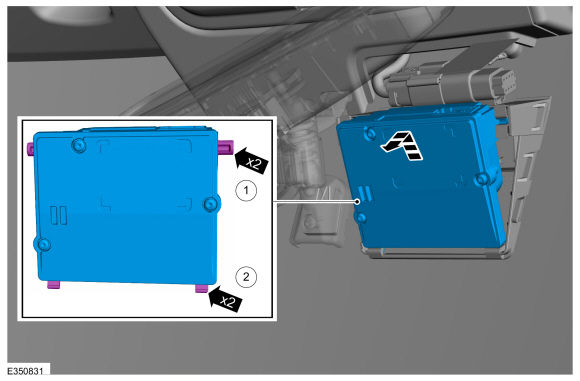

  1. Disconnect the electrical connector.
Ford Bronco {thread} {filename}
  1. Remove the IPMA .
    1. Remove the upper tabs.
    1. Remove the lower tabs.
Installation
  1. Install the IPMA .
    1. Install the lower tabs.
    1. Install the upper tabs.

Make sure the cable/harness in there get back in their clips correctly, otherwise they rattle like crazy and it sounds like it’s coming from the rear cargo area.

For anyone who has removed this cover, where did you start prying? I’ve been trying for the past few minutes, and can’t get it off. Should I start at the bottom or the sides?
Ducati1098
9,847
22,812
Midwest
I always go from the side. It just pops off pretty easily
