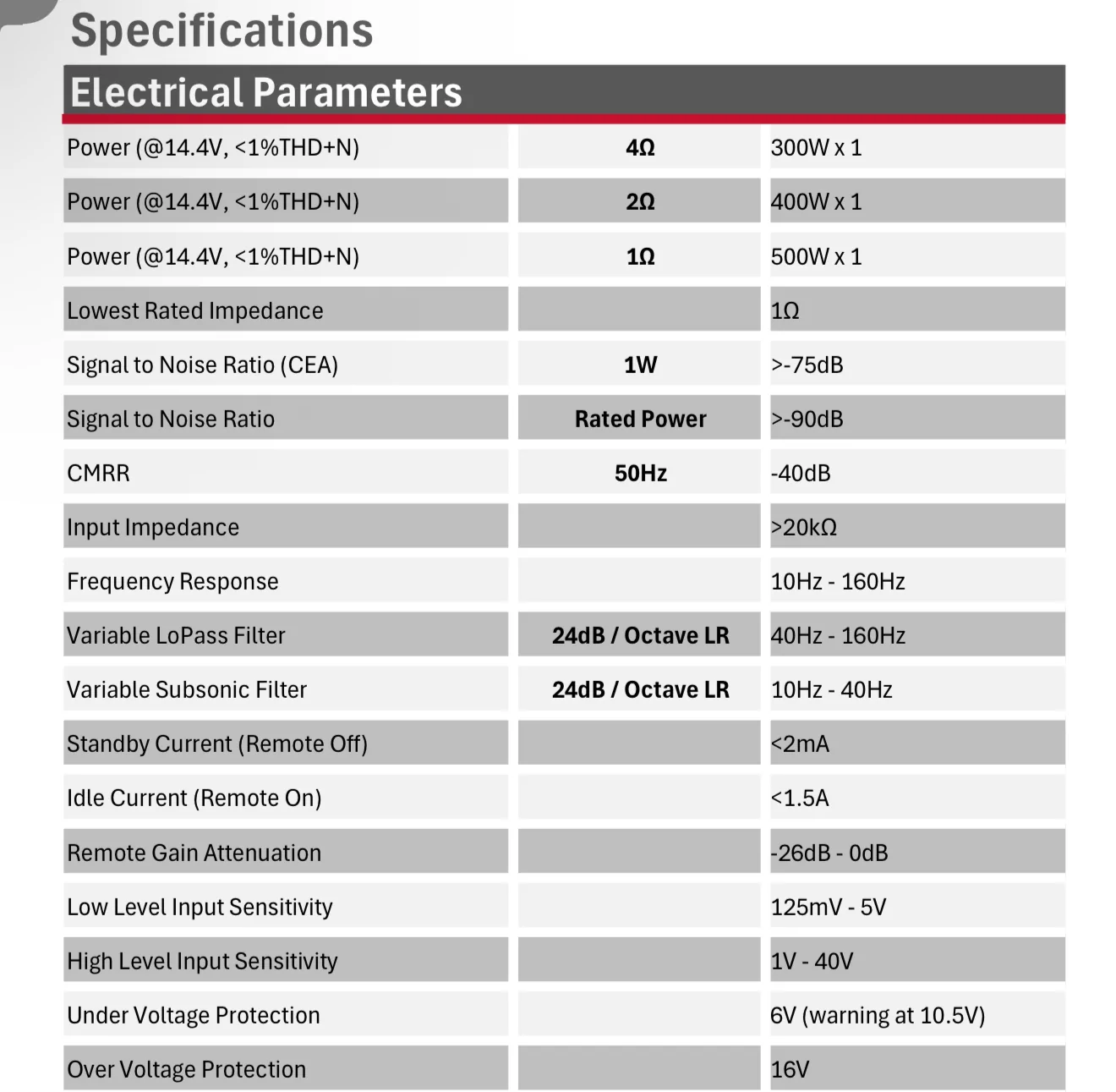

(The Key500.1 amp is a little more power than the subs can handle so I would need to be careful not to overload them)

It’s feasible mechanically but arguably not a great idea sonically. The Key limits frequency range to about 20-160hz. You’d want those sub way above 20 so let’s say 40hz lowest. Those dash speakers will be working really hard to reproduce all the way down to 160hz. At volume, a 4” speaker just didn’t have the power handling capability or cone surface to produce lows. Your best bet is bi-amp the Key to the front using a good mid in the kick and a good coax in the dash. Then use a 6.75 in the OEM sub box with the Key 500. You can find somebody’s takeout 6.5 pretty cheap if your model doesn’t come with one. That would make removing it to return your lease nice and easy.
Just don’t use the key to power both the pods and your kick panels and dash combined. I’ve been on a soapbox about it for a day if you’re interested in the thread around here.

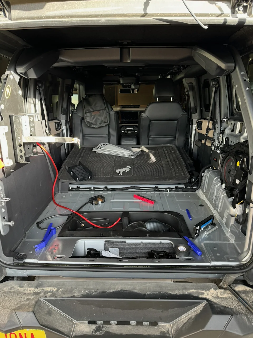

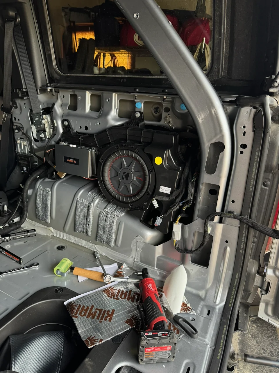

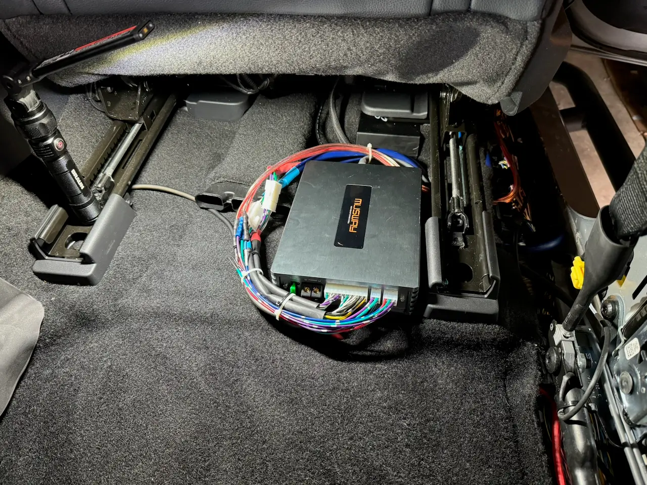

Think I spent about 2k for the PlugnPlay harness, an eight-channel Musway DSP, 2-channel Musway amps to drive the sub, and all six speakers + sub. Very satisfied with the result. An aircraft mechanic could put it all together with no problem.
That is a very nice setup right there.
