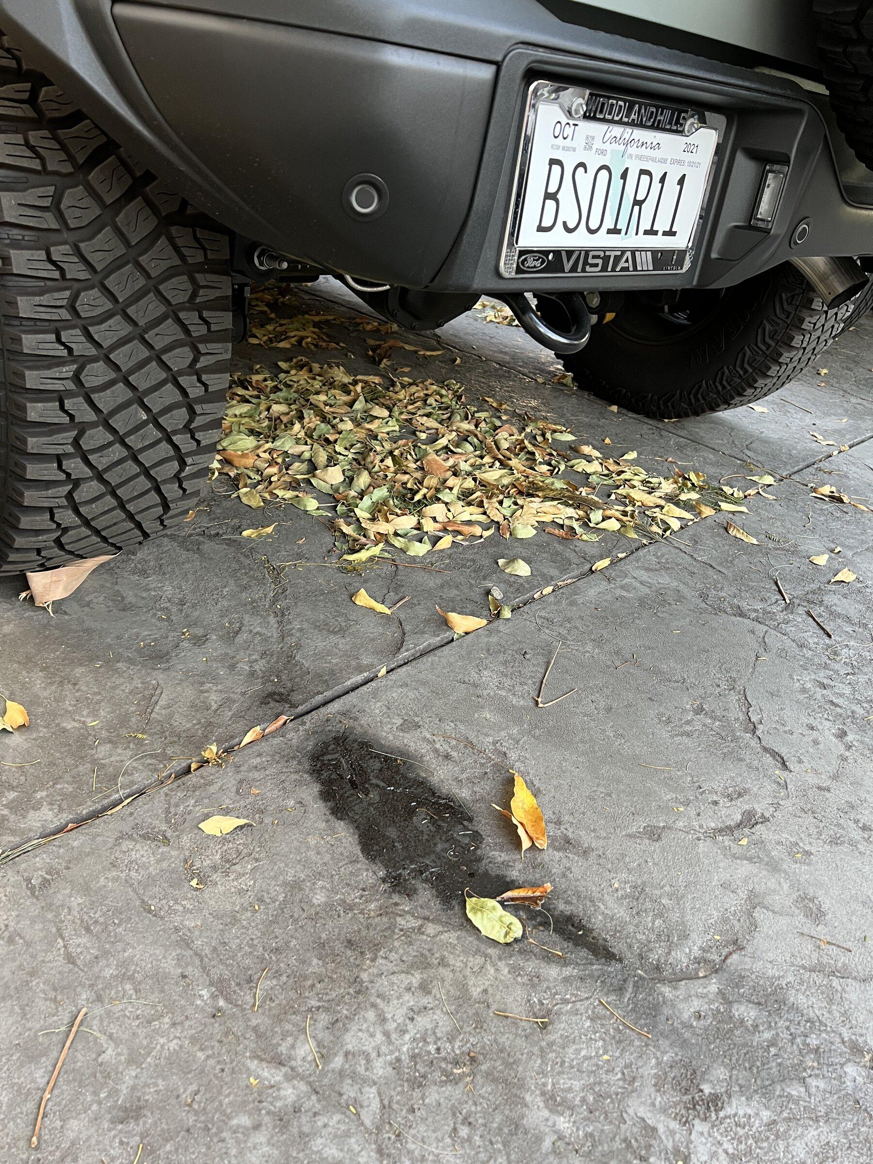

Hey Guys,
Just discovered my Bronco 4Dr leaking gas while parked on my steep driveway. Anyone notice this anywhere? It's leaking from my rear drivers side bumper, below the gas tank. Took it to dealer service and they couldn't find the reason. It does have a full tank and has been sitting for at least a week. No evidence inside the gas cap of anything spilling over or wet.
Thanks,
Ash

Going to throw a SWAG... very full tank + steep incline for long period = gas going into the evap system and leaking out.

was there a large temperature change after filling the tank and the time you noticed the 'leak'?
might have been thermal expansion flooding the evaporator chamber and exiting the overflow.
https://www.onsitepoweradvisor.com/2012/12/03/thermal-expansion/
the general advise is not to fill past the first click heard on the nozzle.

The tank is not near the bumper so it has to be filler related. Any chance someone tried to siphon some of it?
Yes actually the temperatures in SoCal have gotten into the 80's with cold mornings, that could be it. A shame the service advisor wouldn't be aware of this....I'll have to inquire about this.
they could try, but theyd find theres a baffle in there that would prevent it.

Do you "top off" when you fill up?
