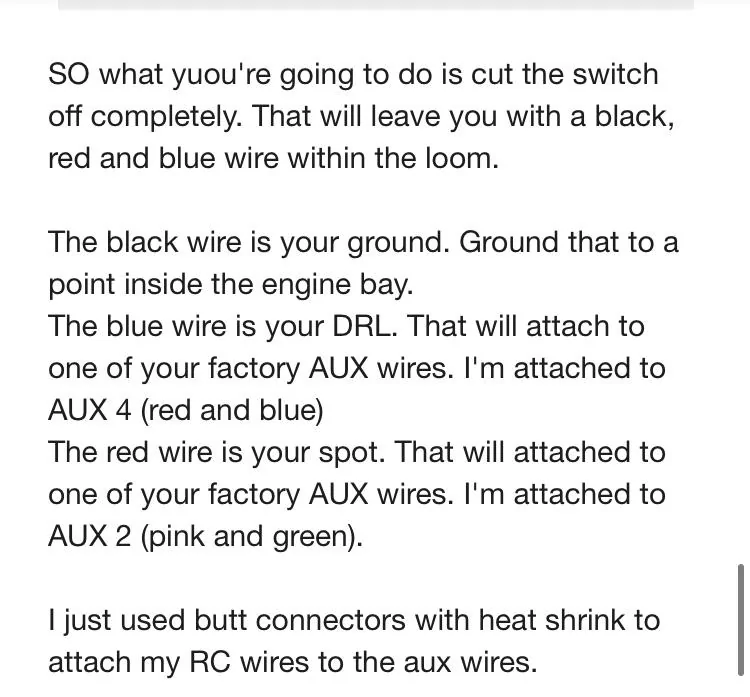

If your hook up a light bar with daytime running lights capability attached to the auxiliary switch, would the daytime running lights work without the aux switch turned on or would there need to be another switch involved? I’m admittedly very green when it comes to this kind of stuff. Thanks.

Assuming that you are asking about the backlight feature, you need to think about it as two separate lights. There is power to the backlight, which you are considering as the "running lights," and there is power to the light bar itself. You simply tap into the running lights power to trigger the relay on for the backlight. Then run the power to the high intensity light bar through the Aux 1 switch. The lights will operate independently.
Most likely, you will receive a wiring harness for the complete setup, which will make it difficult and confusing. You could use the harness and use the Aux 1 switch (yellow wire) to power the harness relay for the light bar and tap into the running light circuit per the instructions. The cleanest install, would be to use a relay harness for the running lights only and use the Ford factory wiring for the light bar.

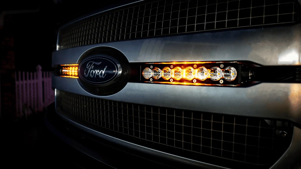

So the Baja Designs S8 bars have little amber lights inside people use for DRL. It's not the entire bar just a few amber lights. It's activated from a 2nd wire/switch. You could wire that to another upfitter OR wire it to your fuse panel to one of the circuits that comes on when your truck does.
If you don't wire it to a switch, it's just not going to turn on but the light bar would still function if hooked up to a switch
