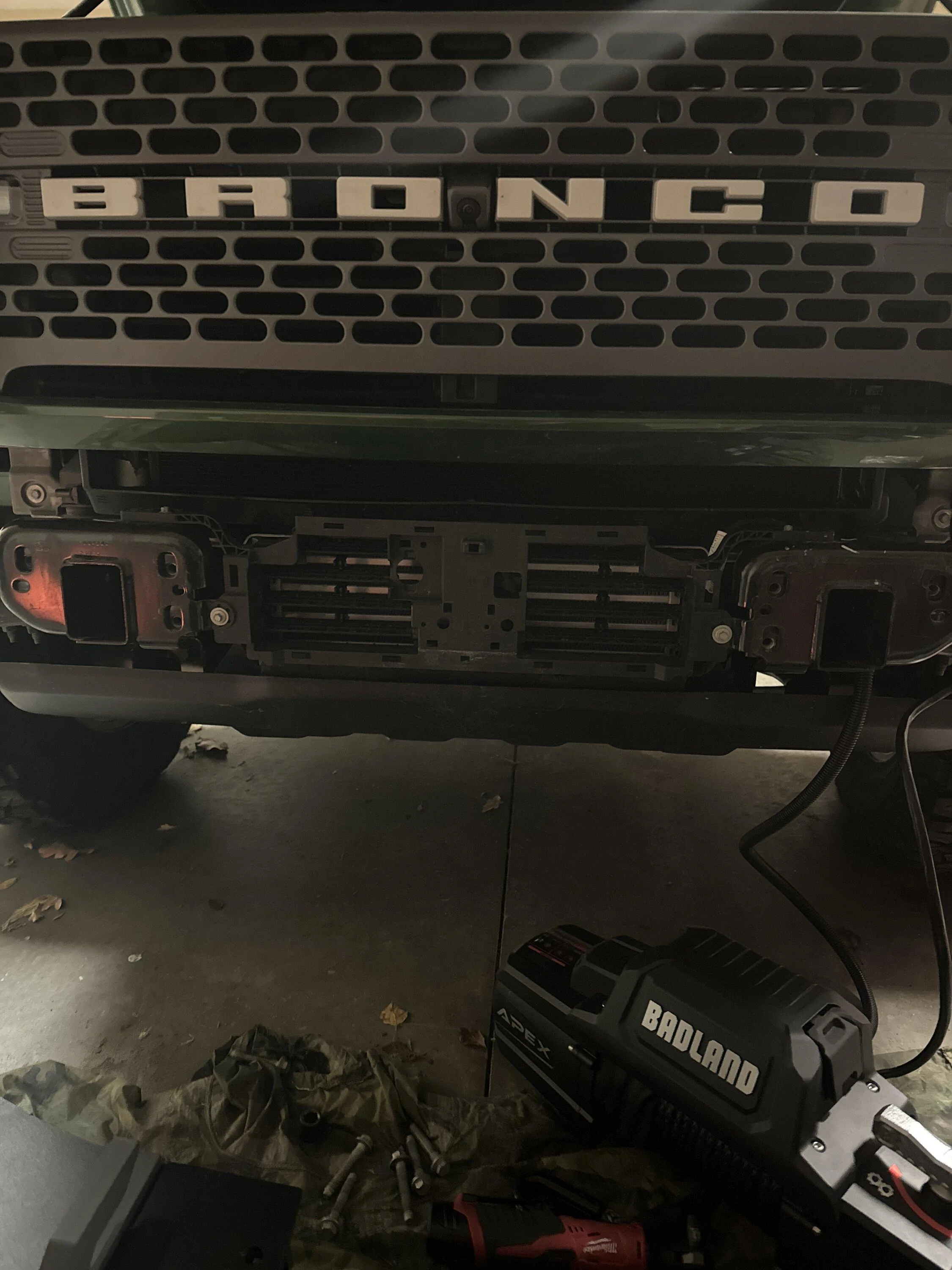

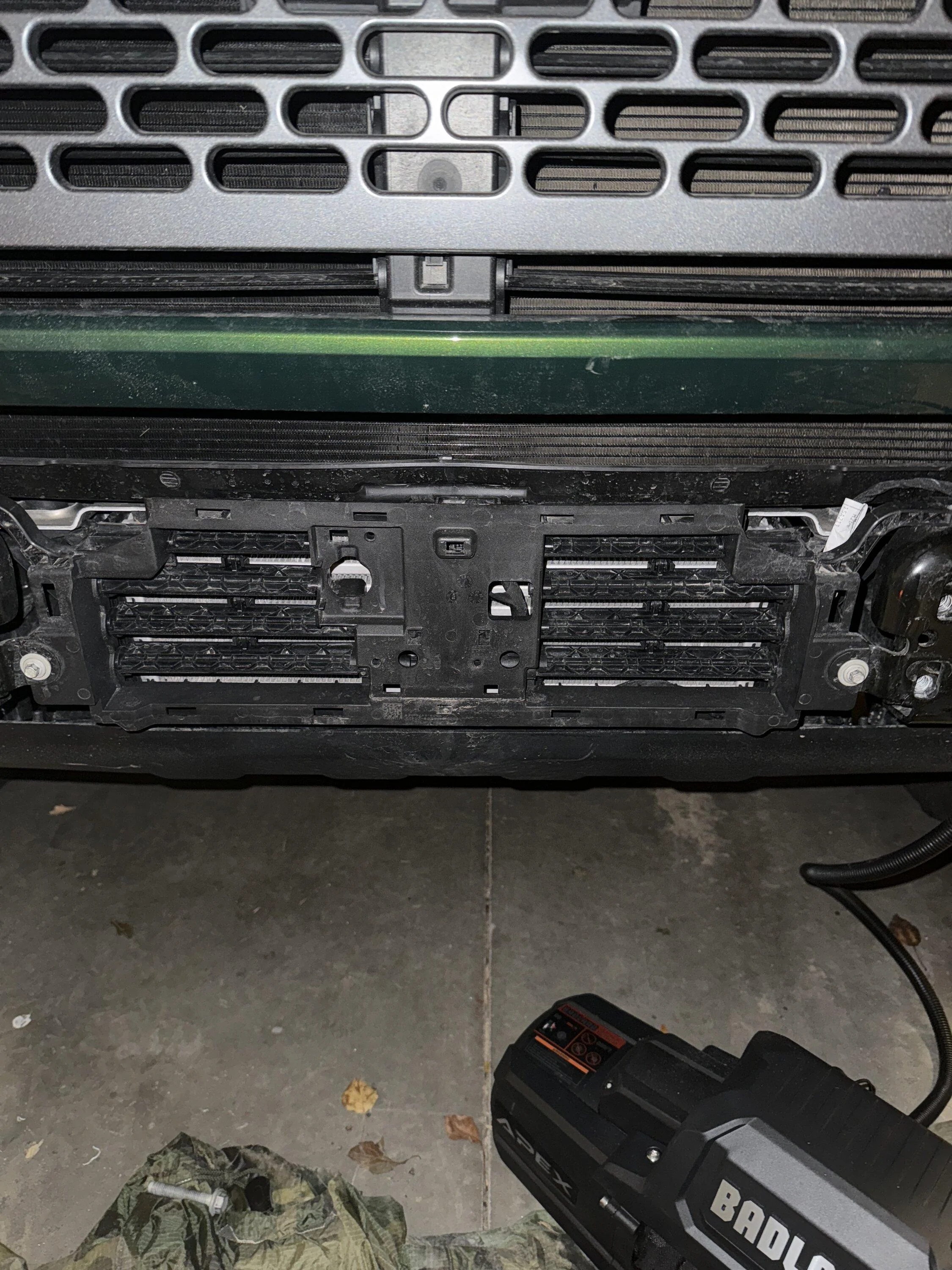

I’m in the middle of installing an upgraded bumper and I went to remove the plastic piece that sits between the frame rails. (This is where the ACC module would sit if I had the lux package.) To my surprise there is a connector that’s actually connected to another socket. (See photo for general area)
Anyone happen to know if I can remove this piece and secure the plug elsewhere or well this cause the electronics to freak out? Also not sure if the levers are self adjusting or not 🤷‍♂️

yes you can relocate it. Doing an ACC relocation requires just such a thing to be done With the wiring harness. Just be sure to plug back in whatever plug there is. That’s the automatic lower shutters if I recall.
Edit: if you were asking about removing the whole plastic piece, including the shutters I wouldn’t recommend that as it may affect cooling

I haven’t removed my shutters, but I believe you have to leave the motor connected and just tuck it up out of the way to prevent any issues/warning messages. Moving any ACC connector that’s there won’t make a difference as you don’t have it to begin with.

I was looking to see if moving the whole thing was feasible/smart. I can’t find too much about the shutters so I think it’s best I just leave that there. Especially since it doesn’t impact the fit at all, was just going to remove it for increased air flow. .
