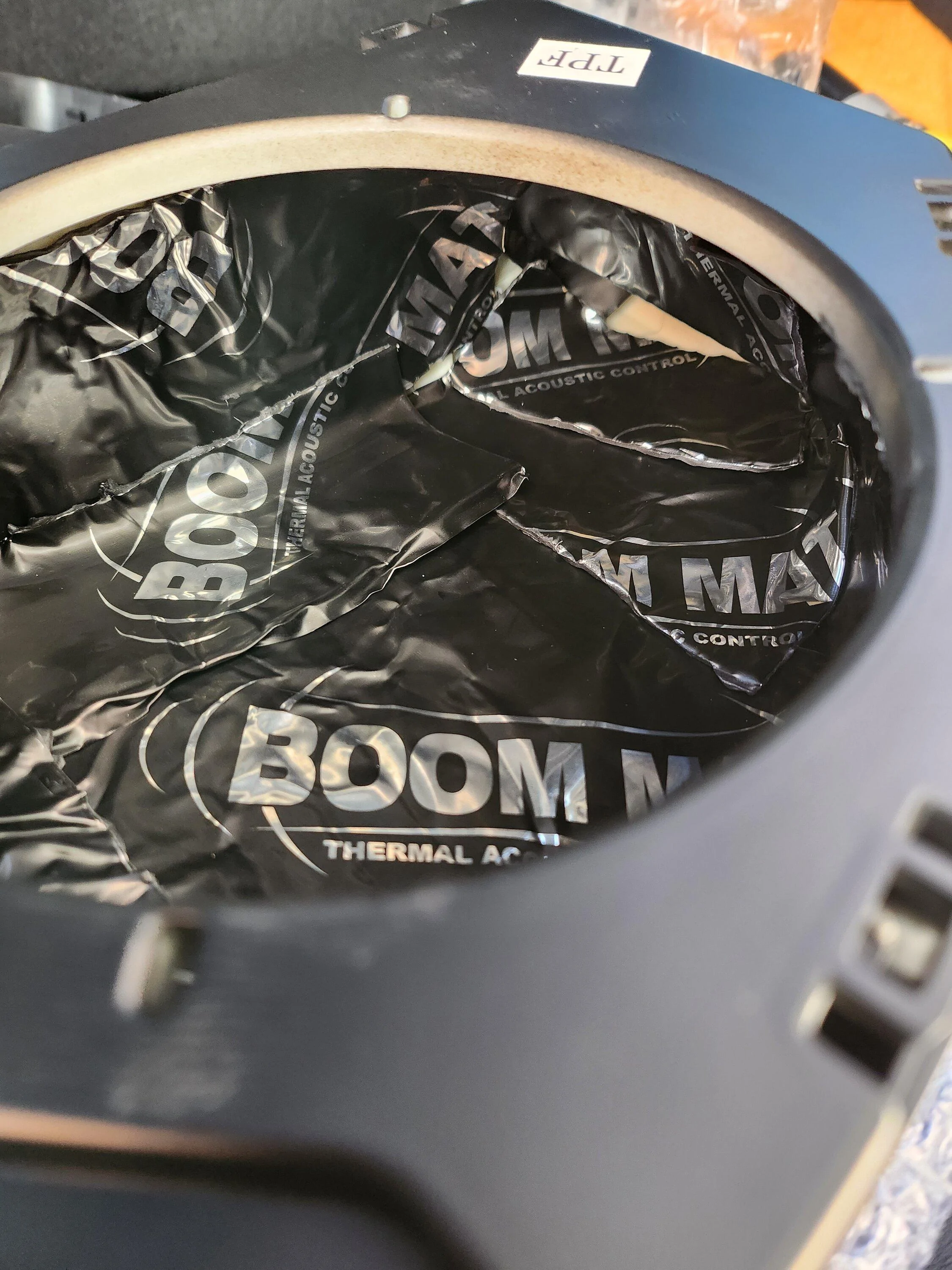

Whelp y'all, Amazon dropped these off a bit earlier and I'm quickly back here with early feedback.
The good news? I think these work for the 2-door without headache or modification. I uninstalled the driver-side OEM pod and dry-fitted the unloaded new one with loose screw-ins. So that's looking good. They're not done yet, so I am still prepared for a headache.
Great news #2: You don't have to have your hard top off for this one. All 6 bolts that hold the pod in place are T30 bolts. For some reason, my Bronco toolkit T30 bit was just a hair too big to fit, but a quick trip to the hardware store and a 1" shank T30 bit later, the bolts are out without even a scraped knuckle.
The uninspiring news? These clips are somehow more fragile than my ex-gf's ego. I couldn't have been more caring and gentle (with either), yet somehow after lovingly prying the face off of the speaker pod I was greeted with a broken clip bouncing around inside the pod. I'm used to small details handwork, and I don't know how I could have treated this thing any gentler. Oh well.

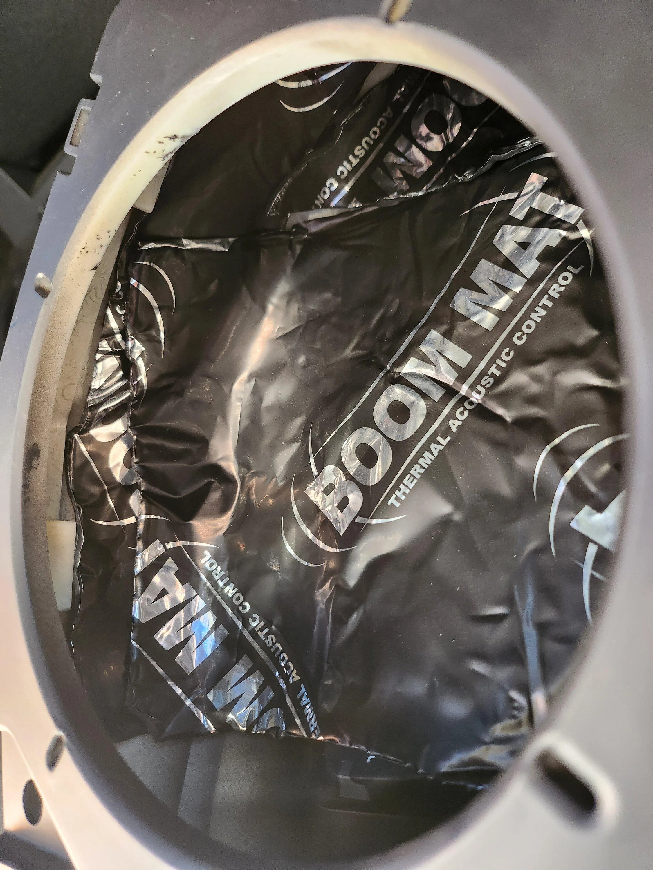

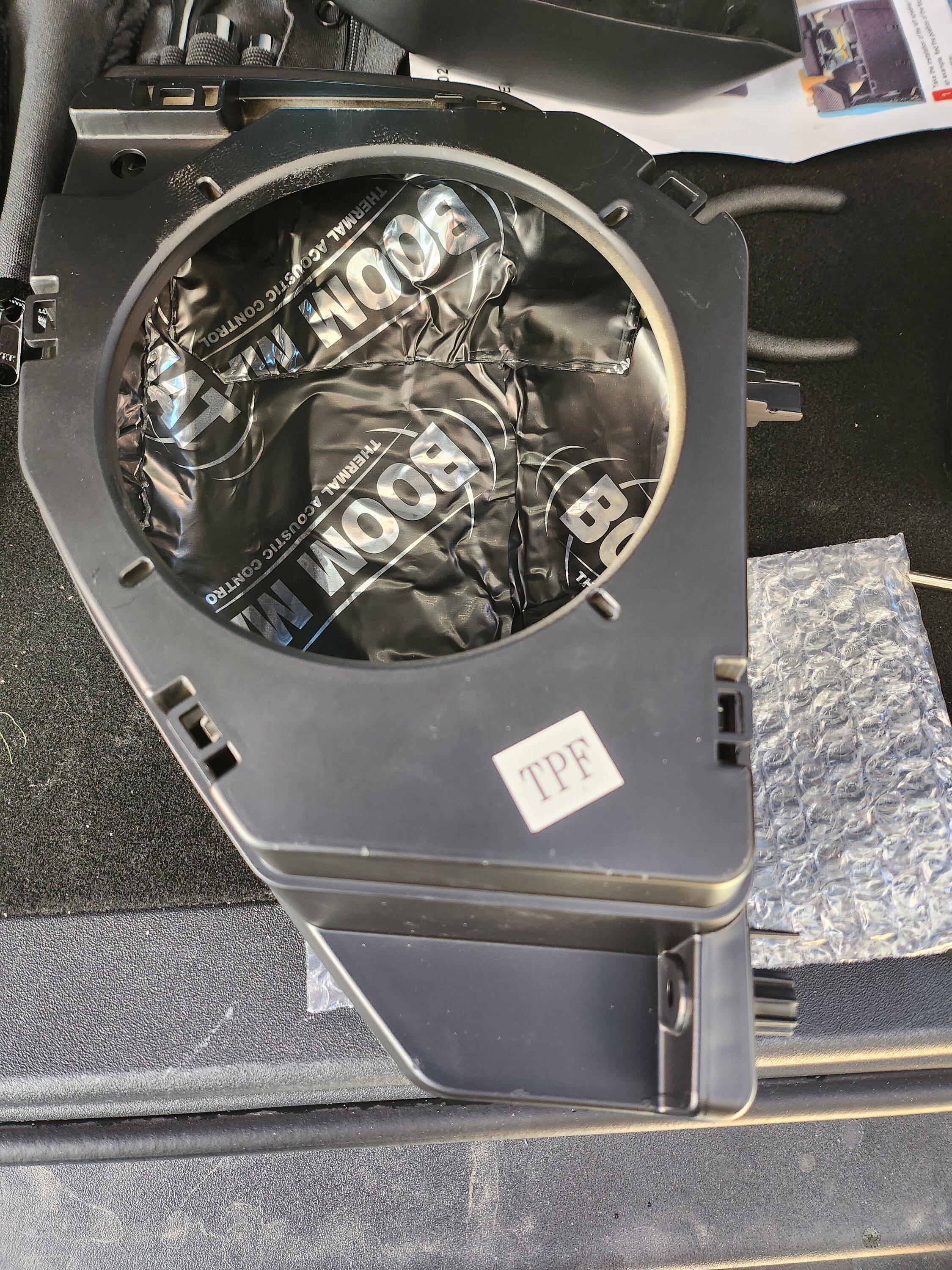

Oh - and if anyone is curious about a 1-1 size comparison with the OEMs? I'm thinking ahead for y'all. Enjoy the "I only have X minutes to complete this before the rest of my weekend schedule impludes" shoddy boom mat work for the Infinity Reference speakers I've had in for a while.

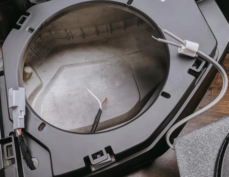

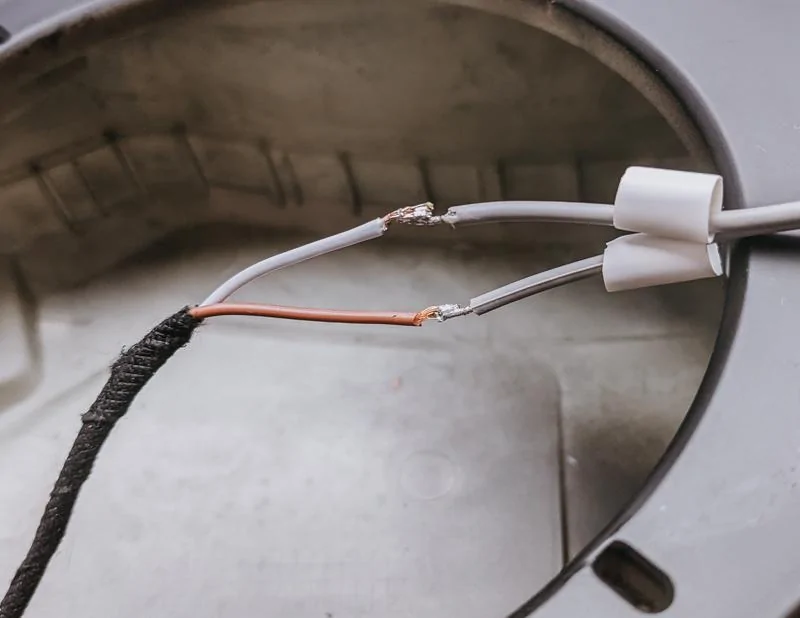

Careful buyer FYI: The quick connectors are bare wires, so if you want a clean plug then be ready to have those on hand. Most established speaker brands provide their own connectors, so if you're buying quality this is only a splice job between both bare sets.
Visually:

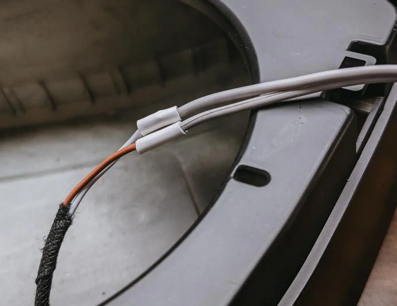

What's provided is the system quick disconnector (left wire set), which has the plastic that clicks in at the top, and that ends in bare wire. White is POS, brown is NEG. The right wire set is what was provided by Kicker. The wire terminals slide right on the back of the speaker, and bare wire at the ends too.
Enjoy my hilariously bad soldering here, trying to splice these two wires as stable as possible:
And for cleanliness and durability (and hiding that disaster of a soldering job), heat-shrink over the splice.

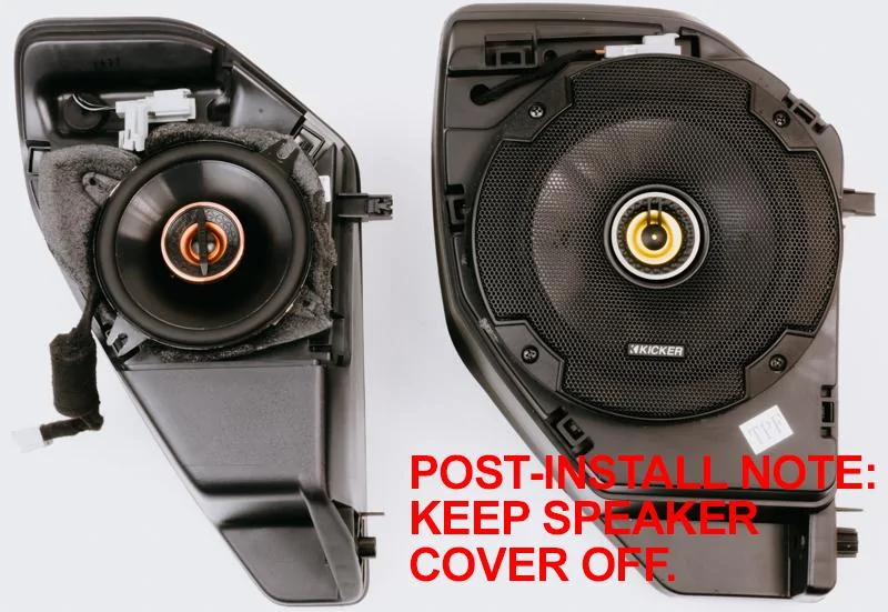

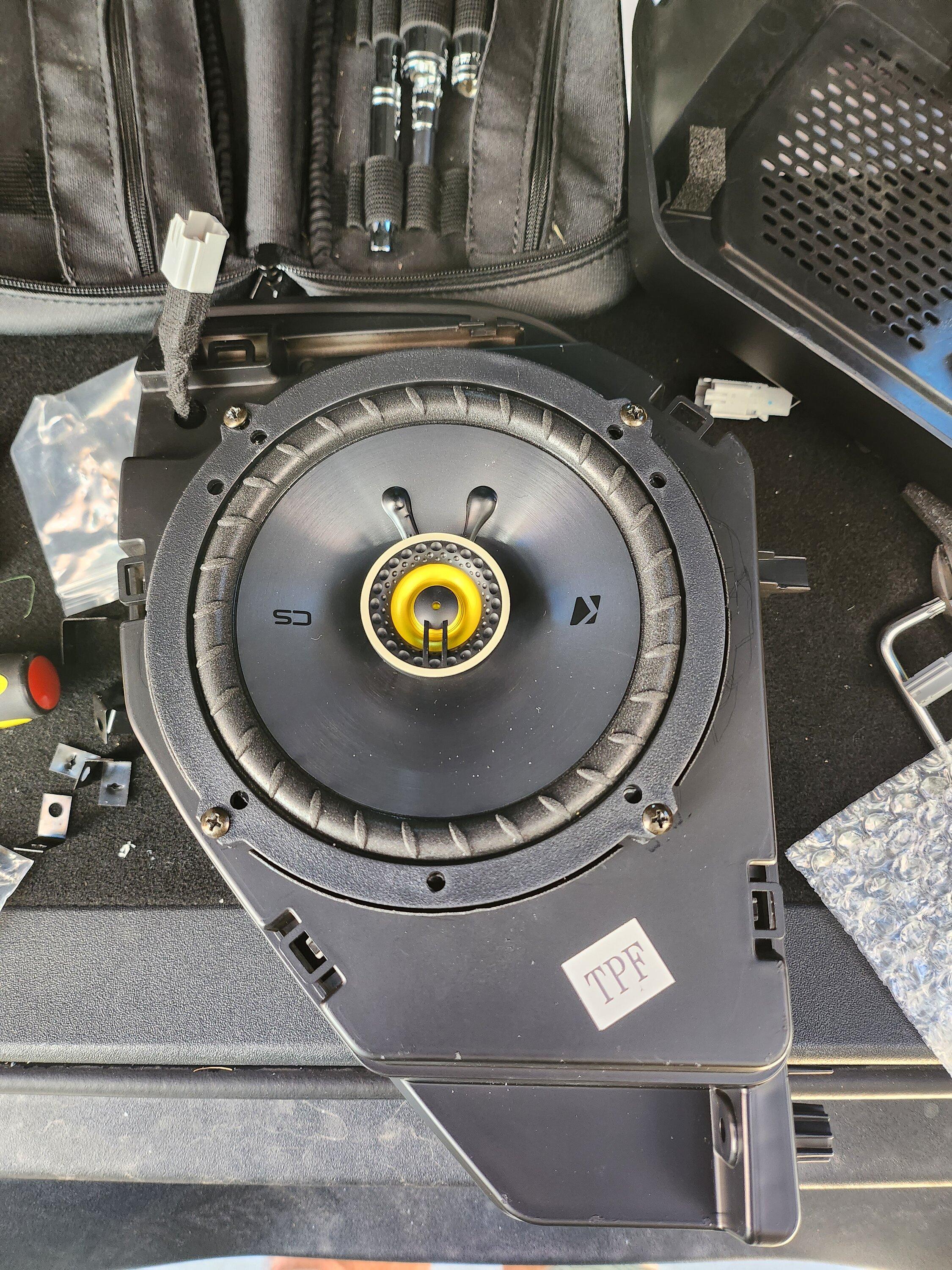

Side-by-side of the actual pod with speakers in:
As the red text indicates, if you're installing 6.5" Kicker CS's, leave that speaker cover off. The Mabett lid doesn't close if the speaker cover is on. I'm sure that's probably already well known, but I didn't know it.

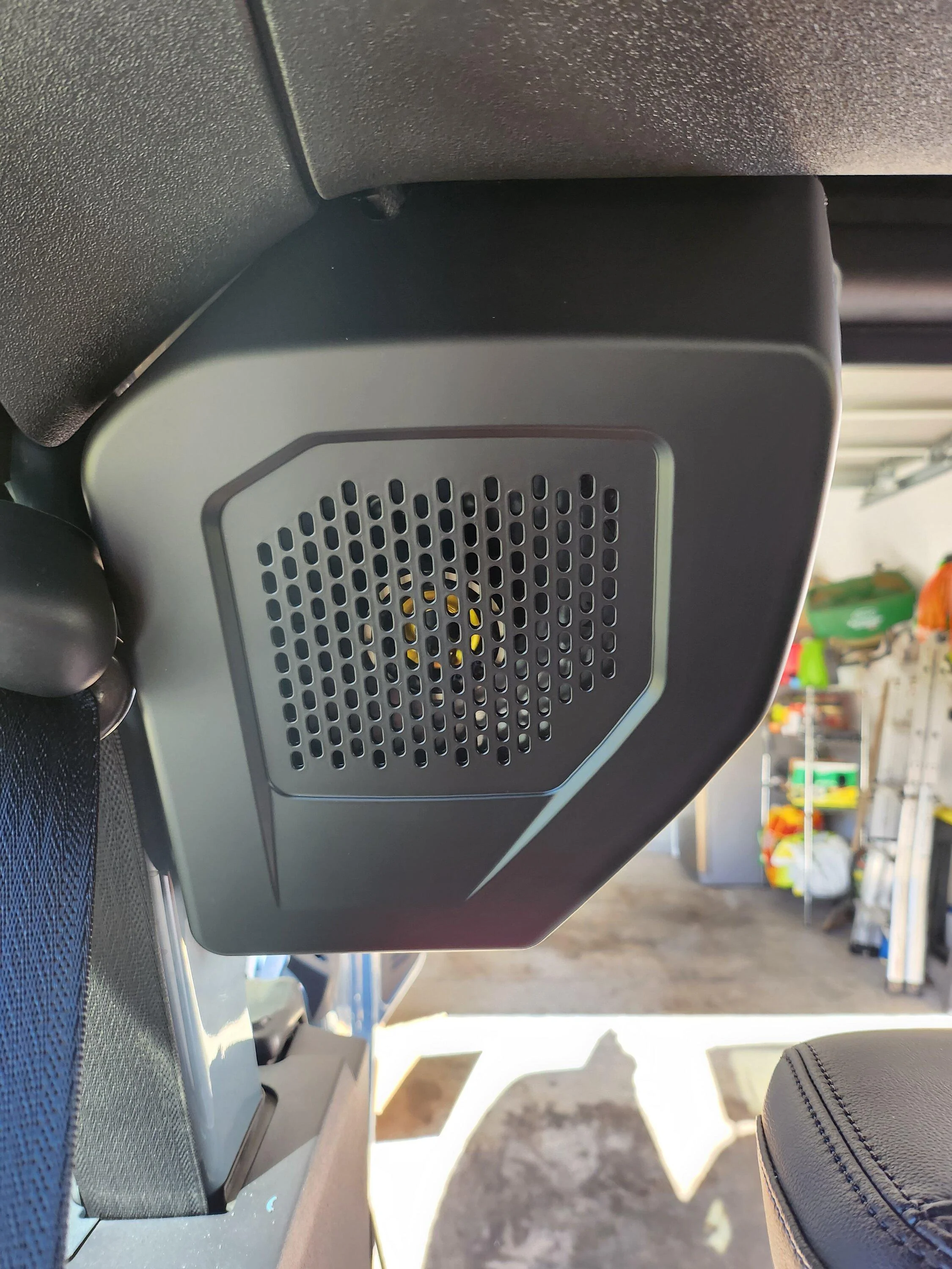

EDIT 2 - 7:15pm - after installation
Results are in... 2-door owners buy with confidence. This fits the 2D very well!

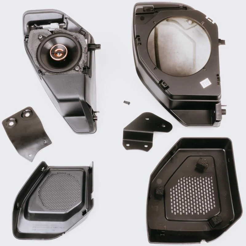

Just finished my installation this morning with kicker 6.5s as well. No issues or broken clips. I was a bit confused by the additional brackets in the box, as there was no mention of them in either the printed instructions or the online installation video. I ended up not using them, but did notice the screws were a bit difficult to line up on the top of the pods... maybe the included brackets would have helped this. Either way, great product and a nice sound difference. Definitely going to look into the Forscan adjustment.

Kicker cs 6.5 looks like? Did they fit and have enough clearance with the tweeter? A few post earlier said CS’s won’t allow for the cover to close.
dznyc
Dan
Jan 14, 2023
New York
My kickers looked exactly like that and the front cover of the speaker pods went on without hitting the tweeter, no problem.
