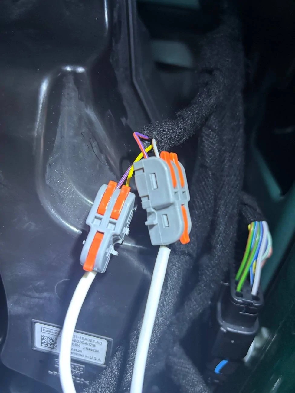

Having a problem with my sub as well and hoping for some help. The Mobridge install went smoothly, tested it out with the stock sub and it worked fine. Installed the Stinger/ audio control tailgate sub and connected the speaker wire to the sub output wires clipped before the green (female) OEM connector, positives and negatives connected via wago connectors. Now no sound from the new sub. Before I go checking the wiring, is there any reason why this setup would not work?
