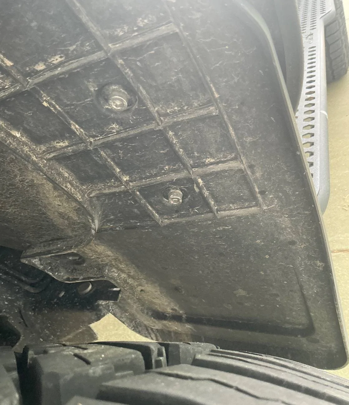

That’s what I currently have but the inside fastener didn’t line up
With the new brackets well.
Did yours?
If you have factory rock rails, you can put a screw through the flap into the rock rail end cap. If you don’t have rock rails , you can use a heavy gauge zip tie from the Jks bracket to the flap hole (as you know they don’t quite line up)
