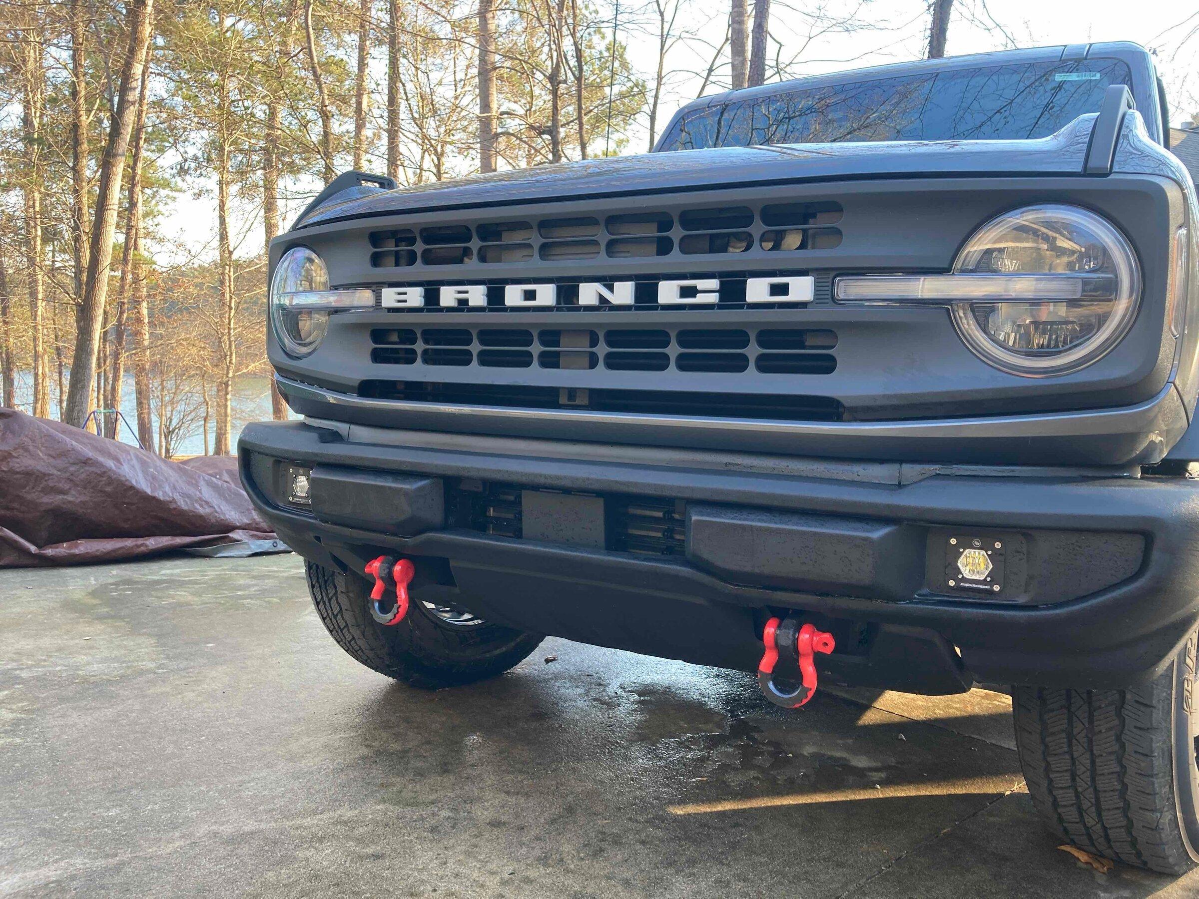

Is there a bracket behind the plastic of the bumper or was one added? How securely are they mounted?
I did not use a bracket, although I have seen a video of someone who 'replaced' their existing fog lights with the BAJA designs lights (using the mount points that already exists on the inside of the bumper). So, I know it's possible to mount them - the problem would be aligning the hole you'd have to create in the plastic... In the case I described, there was already the existing hole.
So, I just used the supplied 4 through-bolts to secure it to the plastic bumper. It seems really secure - and it looks cool (kind of industrial/rugged).

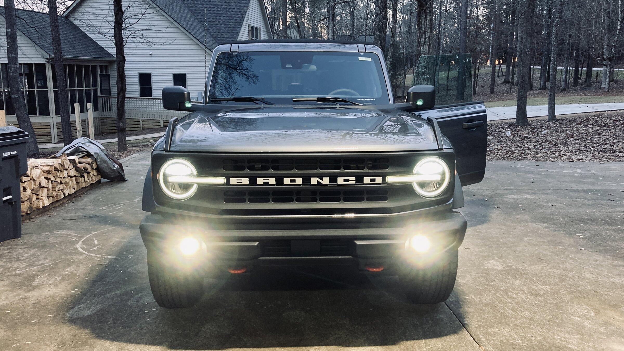

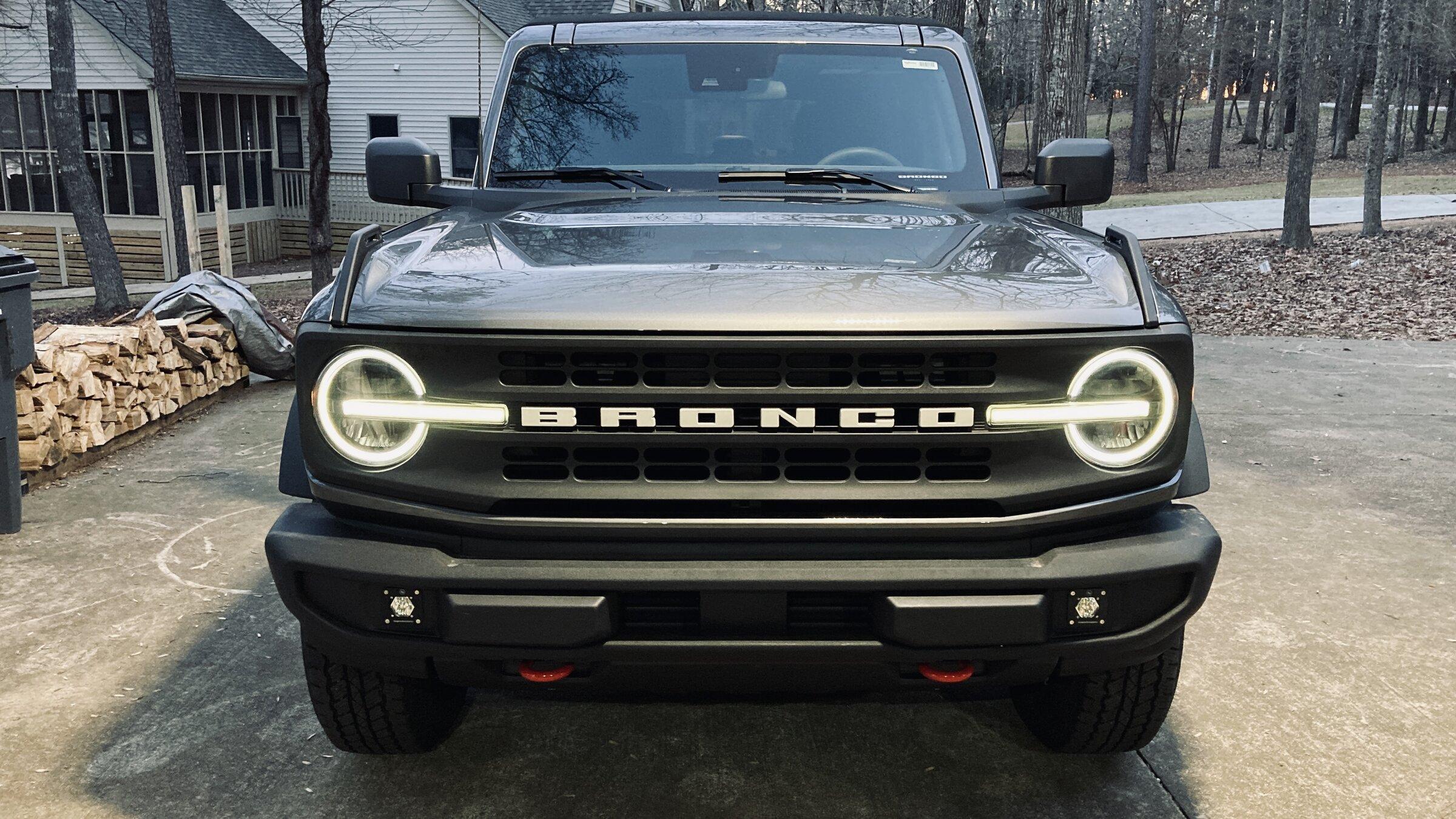

Baja Designs S1 Cornering Lights -
These are great lights and fit the standard bumper perfectly (you only need a drill and 2.5 inch hole saw for mounting). The Baja Designs tap cable works flawlessly - tapped to the driver's side low beam headlight wire (BROWN/BLUE). If you cannot find the Baja Designs lights you want in stock, try 4X4 Truck LEDs - they have most things in stock and are VERY responsive.
