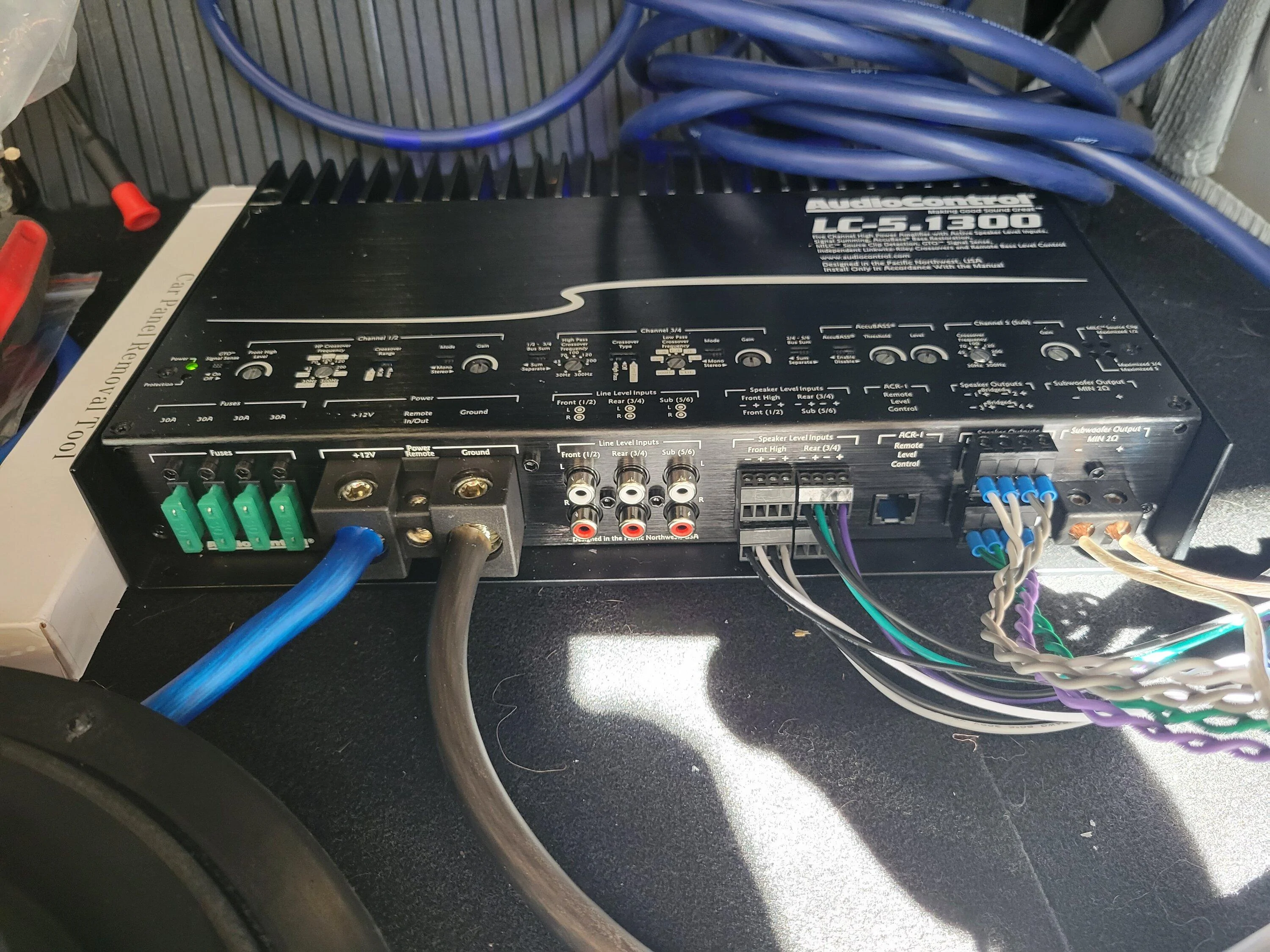

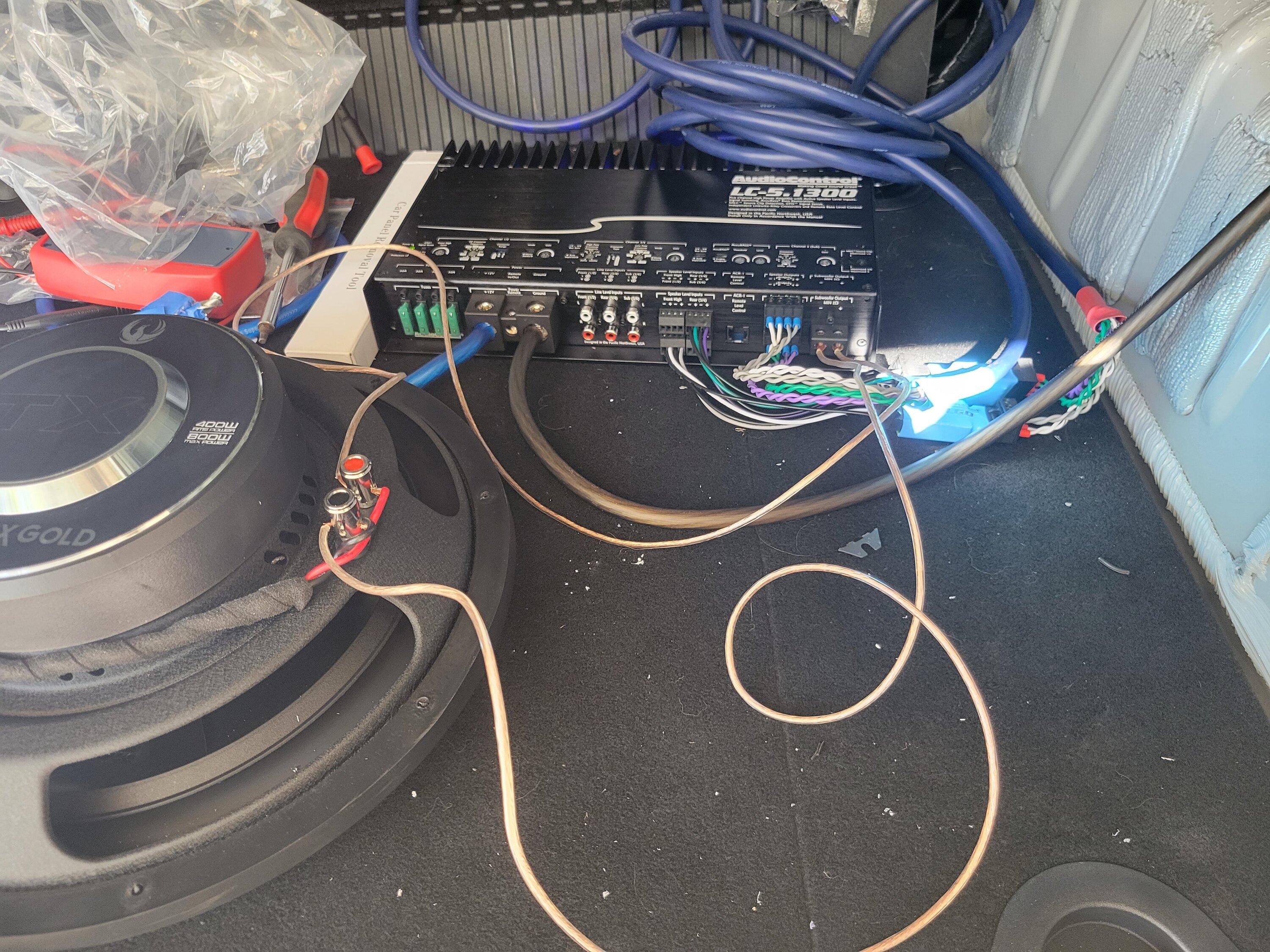

I have a Stinger subwoofer box and an Audiocontrol LC-5 1.300 with the harness, bought from plugnplaykits. I've hooked up everything, getting sound from all the speakers, but the sub is not turning on. Can anyone look if I have something hooked up incorrectly, or steps to figure out what's wrong?

Looks like you may need to adjust you Accubass Threshold. I cant tell if it is enabled or disabled from the pic but the Accubass gain appears that it is all the way down.

Also ensure that the 3/4-5/6 is Sum and not separated as you dont have a separate sub input so you need to sum from the other channels. I would play with this switch as well

That made it turn on!
Thank you!
