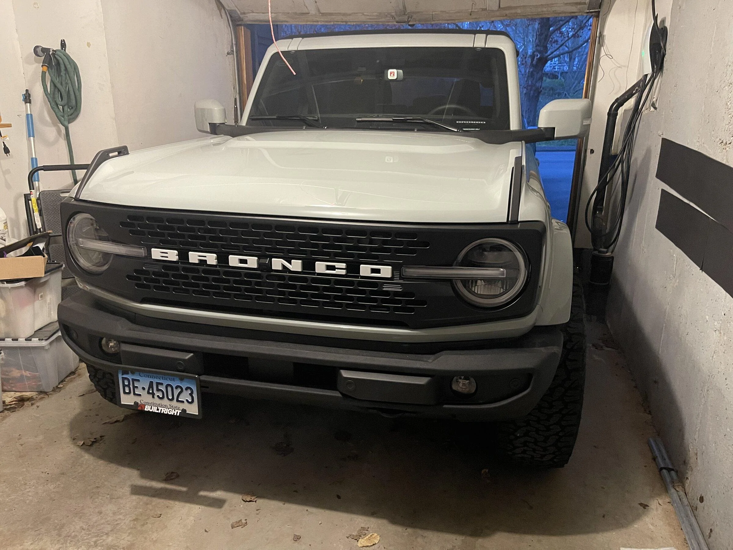

Man that front camera hose took some finesse to pull out! And it took a tad of work to snap the new grille in. Damn plastic!
parts to order:
M2DZ-8A224-AAPTM Emblem
M2DZ-8200-EAPTM Grille - Radiator
Ford Bronco OBX grille swap complete! 488BF8C4-B997-48A8-9575-9F962925DE7A

Looks good. Did you leave the grill primed or get it painted?

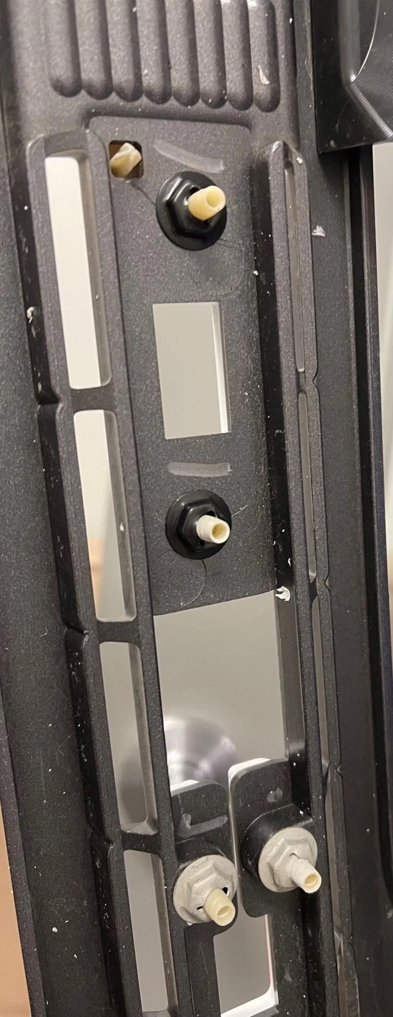

I bought the grill and letters too. Definitely my favorite pattern. How did you install the letters? Use any adhesives?
if you bought new letters, I'd reattach like @flip did in this thread. Basically, the nut cuts threads into the plastic posts of the letters.
Ford Bronco OBX grille swap complete! grille nut1
This is the way I will do it if I swap grilles. Looking good @StachioAttack72

Can you reuse the old letters for the new grille or do you have to have to get new letters?
I just ordered new ones and gorilla glued them.
