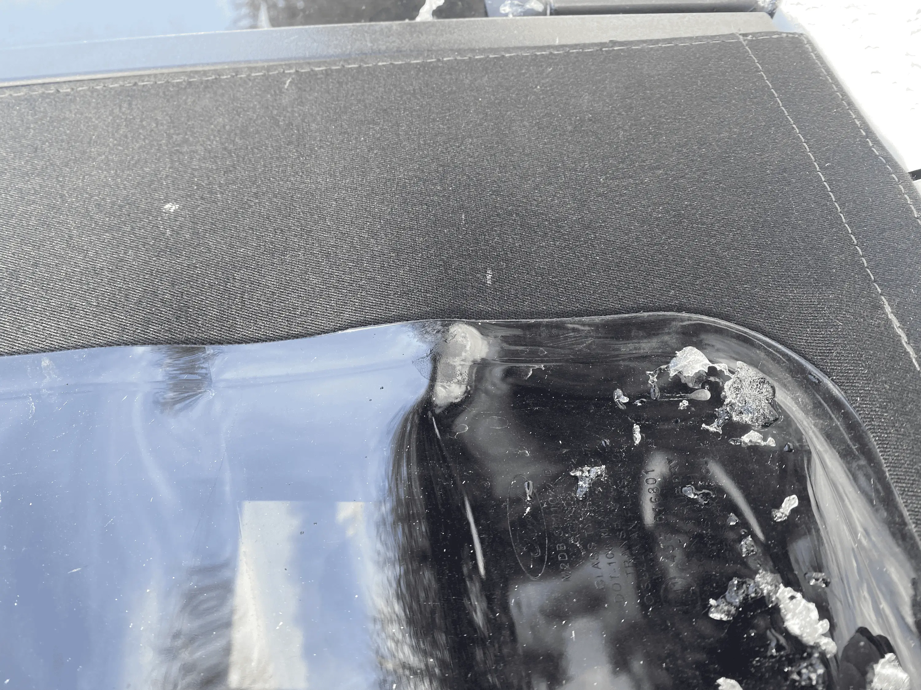

Ford Bronco Outer banks Soft Top Debacle. tempImage6exq6
**UPDATES**
We received a text message from our dealership today to let us know my Bronco is finally ready for pickup.
Apparently Ford Design, Ford Manufacturing and Ford Canda have finally admitted that the canvas for the 2021 Ford Bronco was in fact redesigned, the cable system was removed, reinforcements were added and the drip line was added. Ford told my dealer that although the new redesigned top did not fit my Aug 2021 Frame perfectly the canvas was to be stretched and forced onto the frame to make it work. My dealership did this and have informed me my vehicle is ready for pickup...
My husband went to pickup my Bronco and he started driving down the road and thought hmmm. the back window looks a little weird. Then he rolled down the drivers window and the window goes down and will not go back up. The rear window is creased, dimples and blemished. My dealership says well the windows are a separate part of the canvas.. I have told them I will not accept the windows in this condition and I expect it to be repaired correctly this time..
