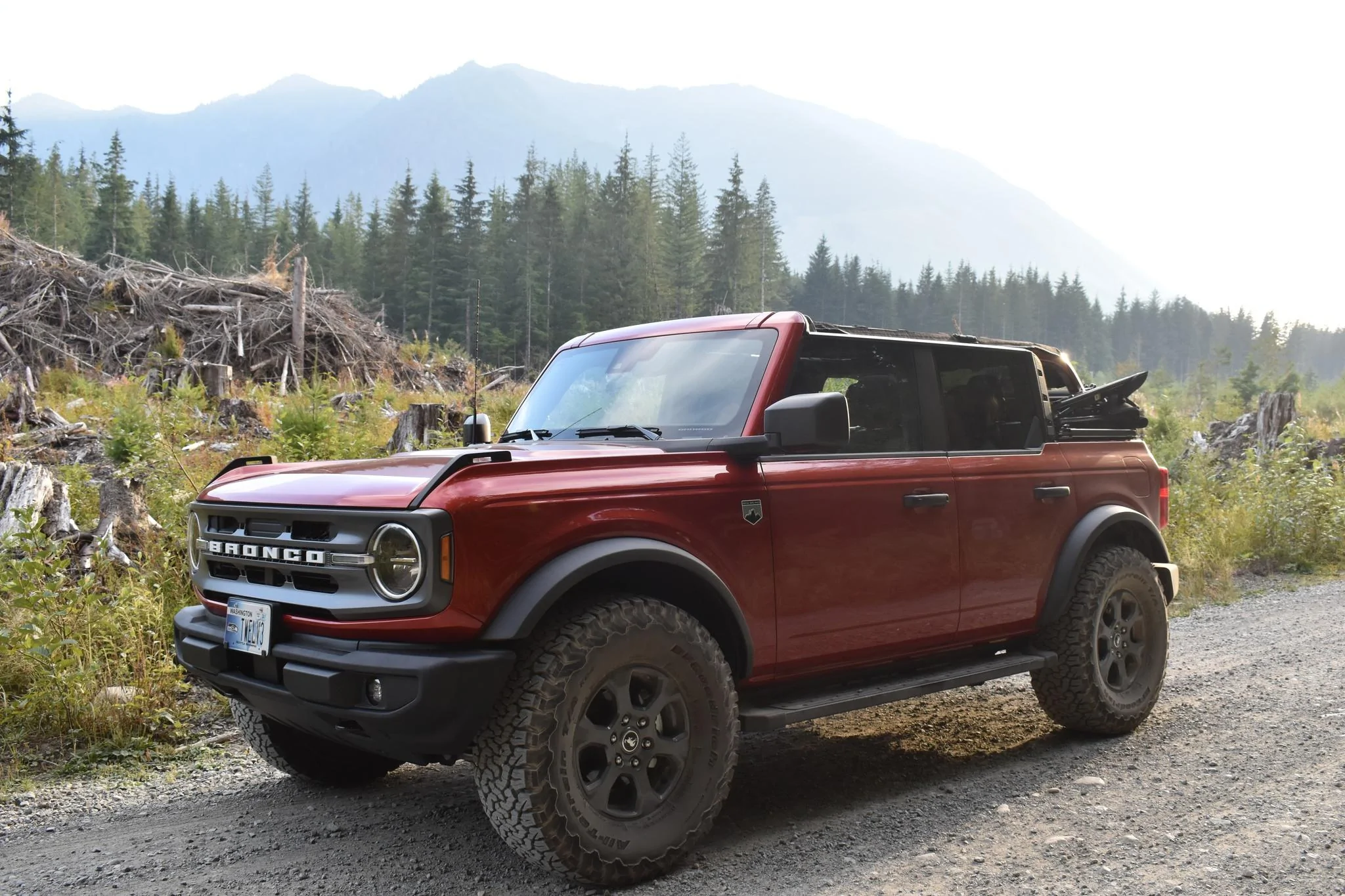

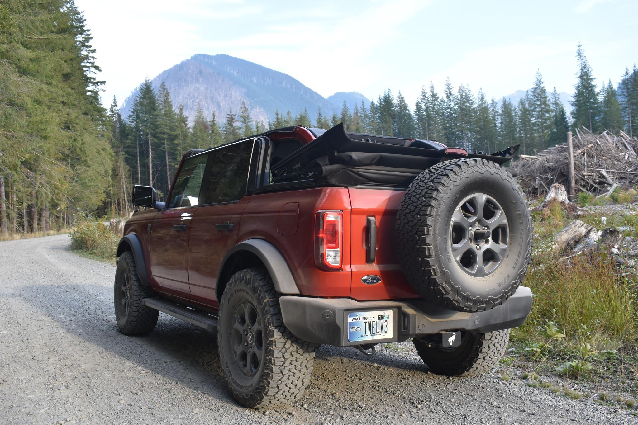

MaddiesDaddy
Norm
Dec 9, 2021
Bothell, WA
2011 Ford Edge
Here is my stock Big Bend with 315/70R17 KO2's. No lift, I did remove the crash bars.
