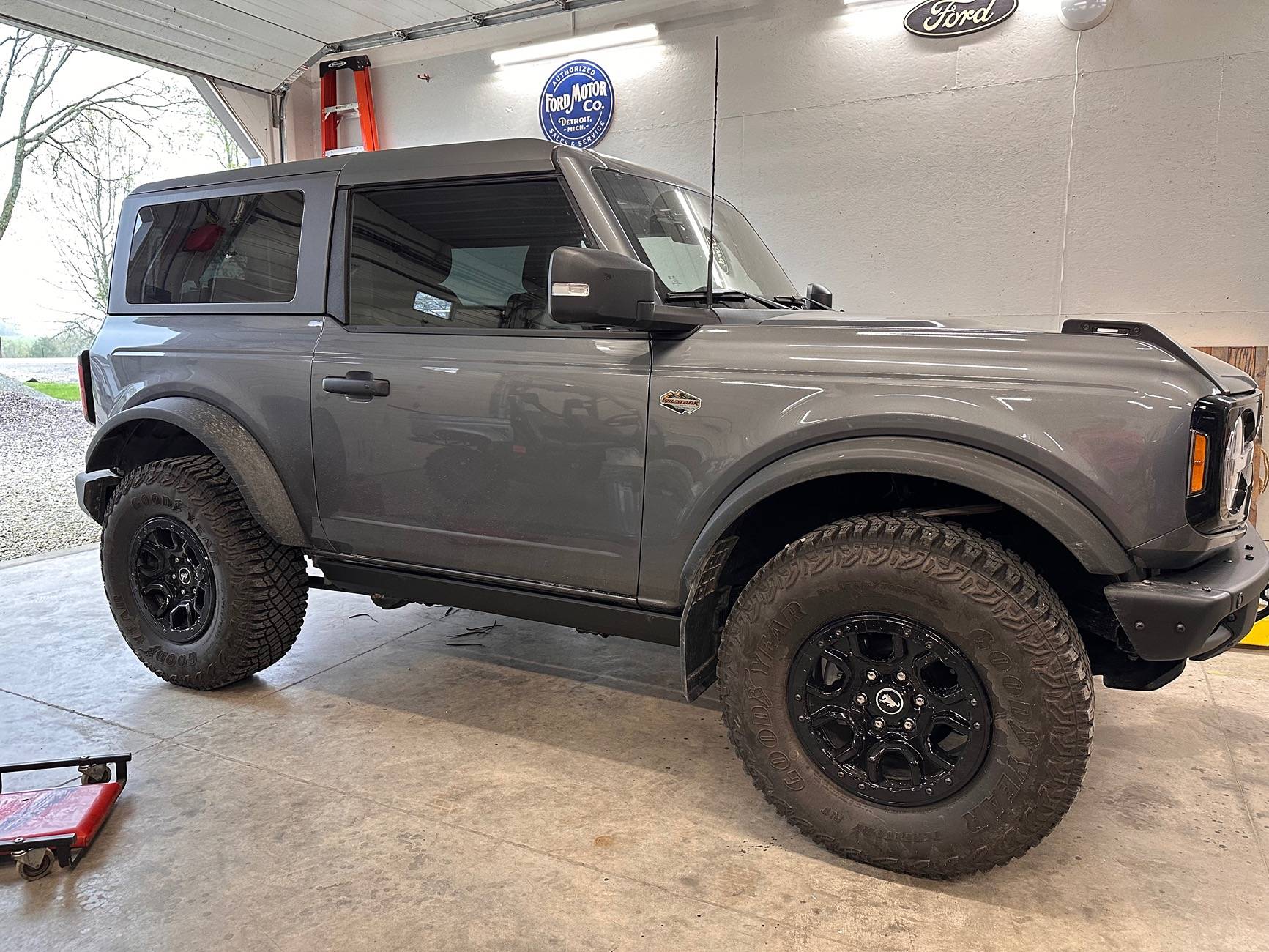

Got them installed and what a PITA!!!! Installed the controller on the passenger side. Thanks for the help guys!

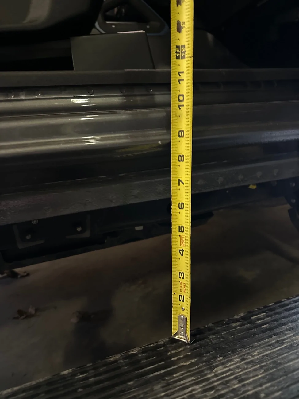

How far does the step come down from the top of the sill?

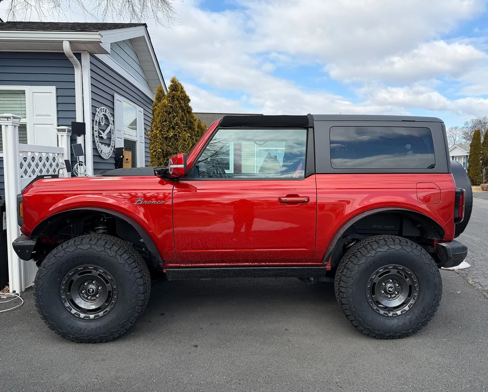

I installed mine last July and I too installed the controller on the passenger side. Now that I installed Eibach coil overs and 37" tires I appreciate them more. My wife said it was the best mod yet.
