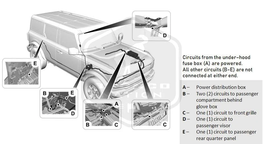

I am having a hard time finding the ends of the body circuits for use with the aux switches. I found all the hot wires coming from the aux switches, and a couple purple wires coming from a wiring harness near the power distribution box. Where the heck are the rest of them please.

Thanks, but exactly where are the ends of the wires routed through the body so I connect the switches to the circuit I want to connect to my my accessories? If you have a pic of where they are, I’d appreciate it. Thanks for the reply!

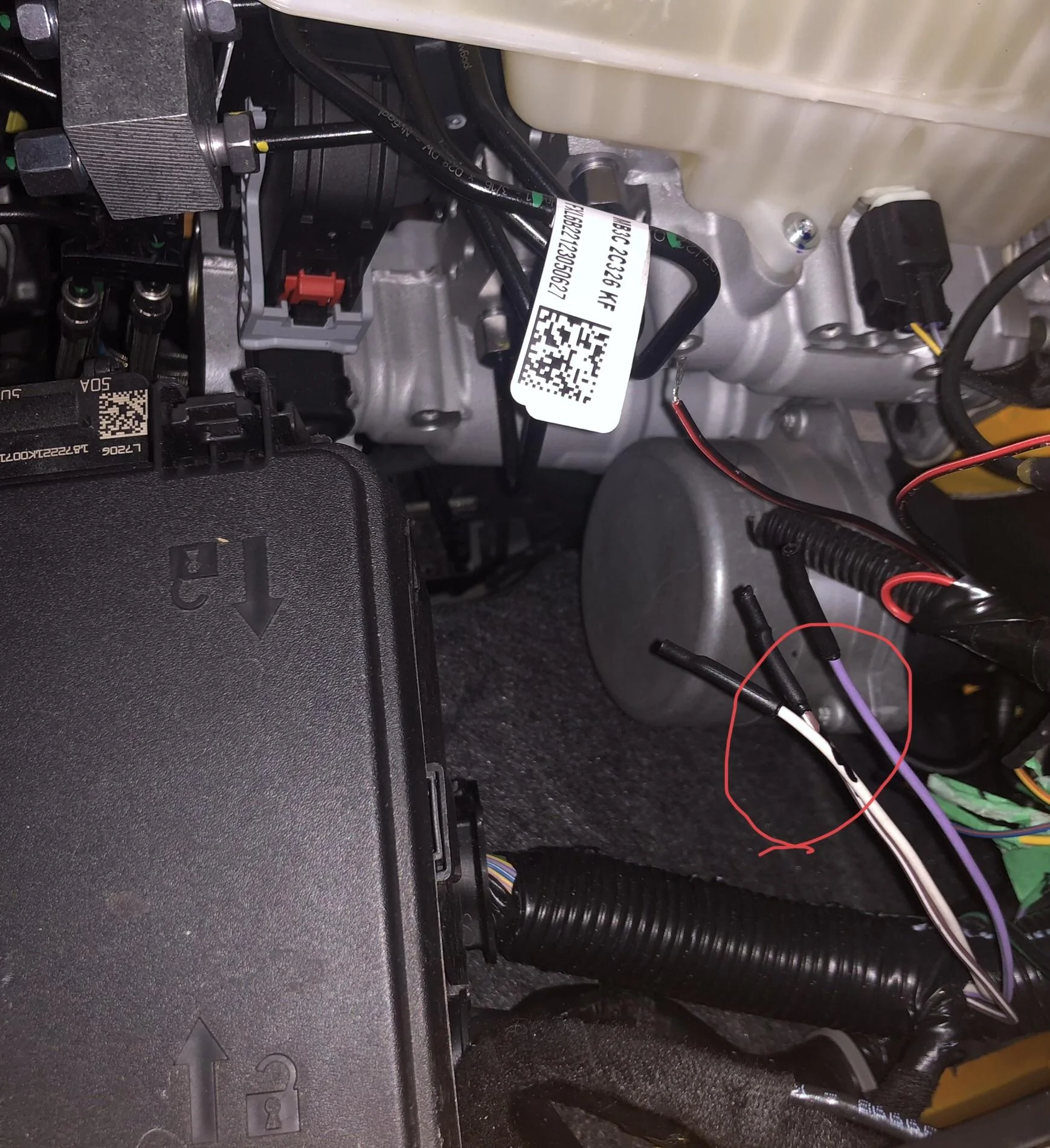

Well, I found three of the non-powered circuits, interestingly marked with slases witha magic marker. 1, 2, & 3 slashes. Pic attached. Where are the other two???
