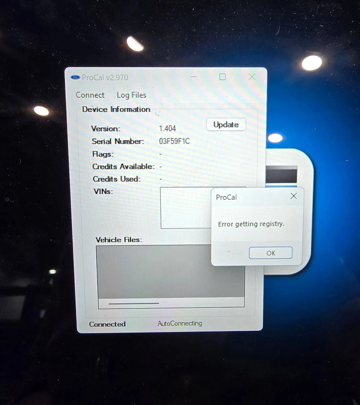

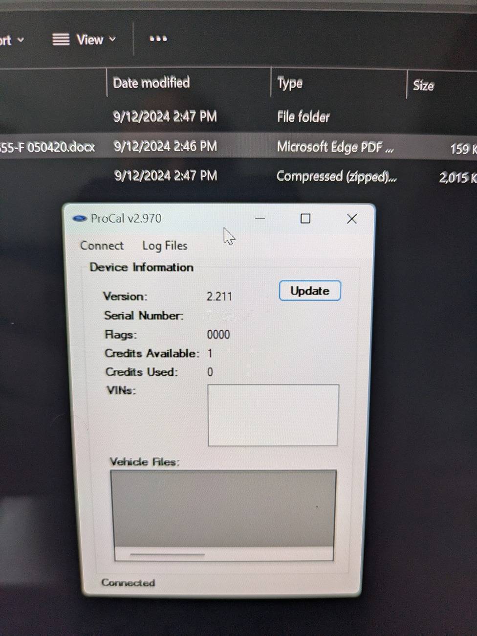

Welp I just tried with the new cable and on my surface pro for the heck of it. A few seconds after it connects I still get the "Error getting registry" pop up. After that pops up you can't go any further.

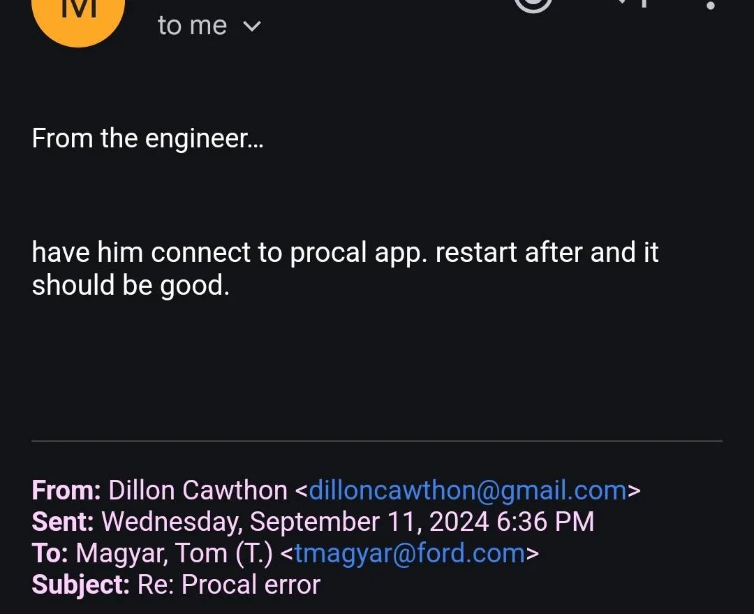

Also FP's engineer wasn't much help.

Not after that "Error getting registry" pops up. When you hit "ok" everything gets grayed out, including the update button.
I can hit the update button right after I connect the device, before the error pops up, but if I do the version and serial numbers disappear and the procal software freezes until you force close it.

Update for anyone curious:
I actually spoke with the engineer from Ford Performance on the phone while he remote into my computer.
He messed around in the procal software while I connected/disconnected the device for him. After a bit he said my device has to be faulty.
Got my shipping address and said they'd send me another one.
