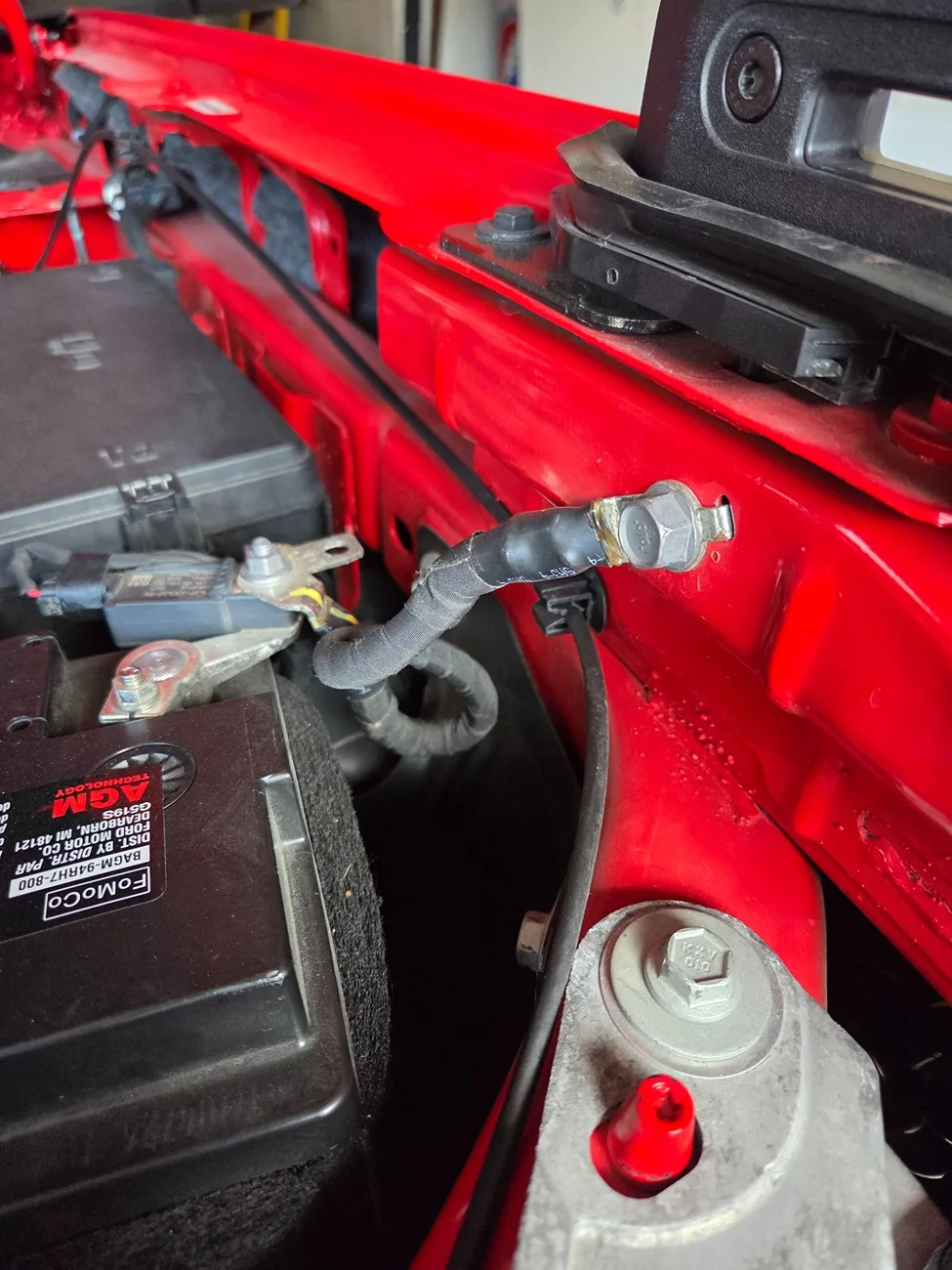

When you say outside the BMS would that be the ground on the fender, or the tab off the BMS?
Any good chassis ground is fine, or the little tab coming off the BMS sensor works fine also. Basically anything except the battery post or terminal clamp.

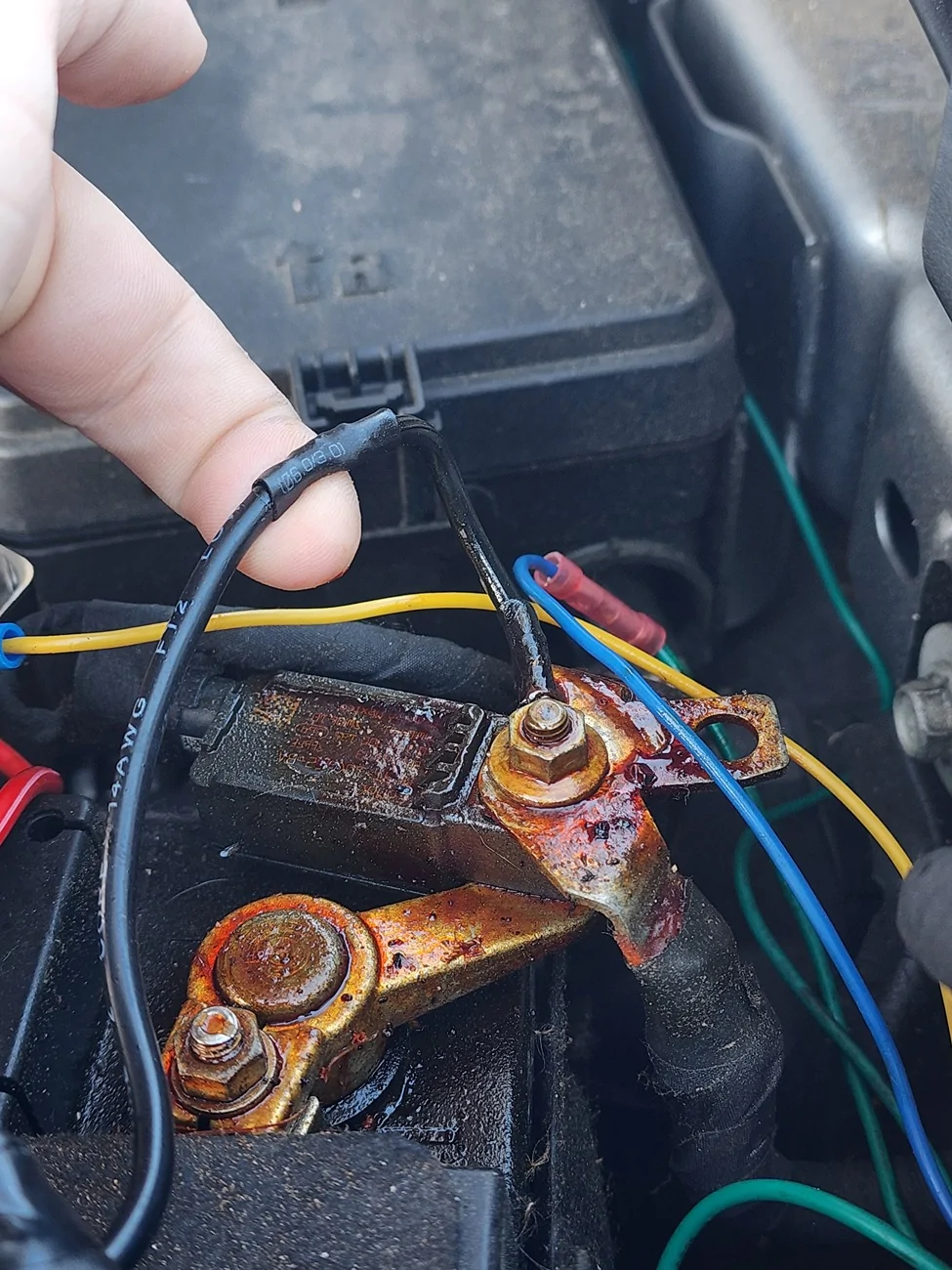

I think I actually do have mine hooked up after the BMS then! Didn't realize the BMS was actually part of this stud. Black wire I'm touching goes to the battery tender. (The brown/orange goop is NOCO battery terminal anti-corrosion spray-on goop)

Ducati1098
9,756
22,477
Midwest
The BMS monitors the battery's state of charge and makes adjustments to the rate of charging. Apparently, by hooking up your battery tender to the posts causes the BMS and battery to be out of sync and may shorten battery life.
On a similar note, the charging system in my previous BMW would monitor the age of the battery and as it aged it would make adjustments at the rate it would recharge. When replacing the battery, you had to "register" the new battery. Basically, telling the car's computer that a new battery was installed so that it didn't treat the new battery the same as the old one.
Not registering the new battery risked shortening the life of the new battery.
EDIT: @Ducati1018 did a better job than my explaining it.
Does anyone know if the same procedure is required with the Bronco?
Yes there is a BMS reset that needs to be done anytime the battery is replaced for Fords also
