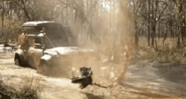

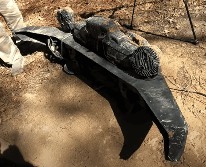

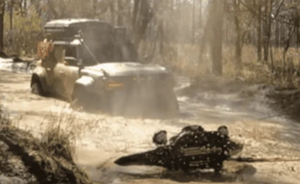

This is a user fail. Using a tow strap like a kinetic. I am not at all surprised the bumper failed.
the owner stated earlier that it was a kinetic strap and the bolts relieved themselves of the frame

While I'm in the market for a '23 Raptor (working on a couple available at the moment), I have been looking at accessories. In particular front and rear bumpers, but I'm concerned on the mounting points- they are mounted in essentially one plane and that would be prone to failure in real world use.
To quantify- I have built numerous vehicles, own two heavily modified Classic Broncos, and I have been rock crawling & off-roading for 25+ years. I can’t leave my vehicles stock. I have a purpose built rock crawler so the Raptor won't see that kind of abuse, but I want the bumpers to be as sleek as possible, protective of sheetmetal, recovery capable and overall- reliable. To that end- I really liked the appearance of the Addictive Desert Design (ADD) Rock-Fighter bumpers.
I have reviewed hundreds of videos and dozens of builds here and on other forums- until I came across @FiveAngelsOutdoor Raptor build. He seems to use his Raptor- nothing crazy, but real world use. Then I see the video that I snapped the below pictures from. Mount fail during a snatch recovery on an ADD front winch bumper. While the bumper seemed to come out OK, clearly it lacked support.
ADD advertises " two reinforced clevis mounts for soft shackles to provide recovery options " and points this out in their videos as well. It was a pretty aggressive snatch, but this is common in many off-road situations- especially on a heavy vehicle.
I have seen other posts about the factory recovery points being tweaked in recoveries, hidden winch mounts damaging the frames and accidents reveal a really weak front structure of the Broncos. So- what are we to do with this information? I have seen some winch bumpers that come with additional brackets to strengthen the bumper mounting point, are they enough? I don't want to weld onto the frame to support loading of this nature. There was additonal damage to his electrical system- a lot could go wrong here.
Any better bumper designs with real world snatch recoveries that would demonstrate the strength- without damage? What about rear bumpers where I’m more likely to use a snatch rope or strap? Similar type mounting points to the front.
I think @FiveAngelsOutdoor is a member here- maybe he can comment with better pics of the failure. Maybe someone from ADD or another bumper company can chime in. Either way- looking for real world input. Dropping $90k on a Raptor and then $6k on winch and bumpers is a significant investment to put at risk in this manner....
And Therein lies the problem with a balls-out kinetic pull.
The video on this “failure” clearly shows it was a crazy kinetic pull and there are plenty of YouTube videos that end with similar results on all kinds of vehicles when brute force and ignorance is used in kinetic pulls.
Everything has a stress limit and the goal is to get the vehicle out without pushing the limits of the recovery equipment or the stuck vehicle.
True- I think it was a Jeep and they were trying to prove something. Need to use caution when pulling out with a kinetic rope or even winching. That said- these mounting points need to be reinforced for the stock pull points- even more so for a winch bumper.
