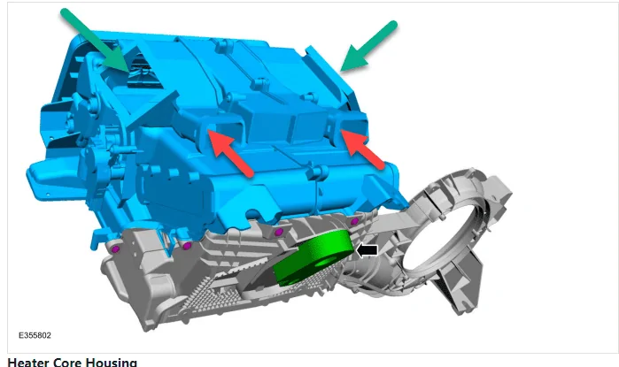

So this is insanely random and...probably more than a bit just 'insane' but I figured it out. By Design, Ford is blocking the downspouts for the Rear Floor Vents (Red Arrows) by about 80-90% by way of an internal flat plastic piece that extends to cover most of the volume of the hole (NOTE: This is NOT the Ford Item #18K358, which is a 2-door only piece. This is simply how the housing appears to be designed/built) The only passthrough is toward the vehicle's center and is about 1" on each side.
I was able to use a generic clamp and a small format pipe/tube camera to look down into the opening from the position of the (removed) front floor vents from a fixed position. Then, I attached the offset/flex-shaft attachment to my no-name dremel ($5...I mean...a steal), fed it up through the bottom through the existing opening, then use the camera to reference where my hand/the dremel moved...I was able to grind out a good amount of material that was blocking the downspout, and more importantly not blow holes through a bunch of random stuff.
Like I said, it's probably a crazy thing to do, and if I'd done it wrong I could have given myself thousands in repair costs. I didn't take it lightly and I had looked at it pretty closely before doing anything.
I don't have metrics or before/after except the 'hand in front of the vents' test and yes, I would say there is a noticeable improvement in flow...my hand used to have to be fairly close to the vent and now I can feel the flow well back behind the front seat.
IF you're going to try -
-Wear gloves, holy cow I'm cut up.
-Try and get metrics?!
-TAKE YOUR TIME. This isn't something you want to rush. I did have one 'happy accident' where I put a hole where one shouldn't be and I had to plug it. Don't do worse than me :)
-Is this a mod I get to name?
Thanks for all this work!!!
That said - what are the GREEN arrows?
Green arrows just indicate where the 'front floor vents' attach - this is where I was entering with the camera to view the top side
Is there a chance you could re-upload the pic? It seems to be down and I was hoping to get a head start on what to take apart.
