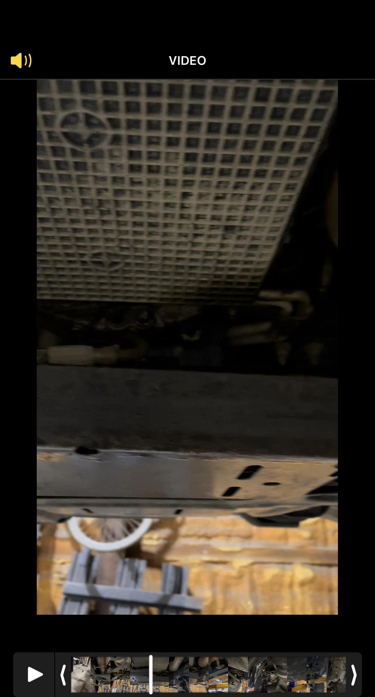

Lets see pics of the seal. Unless that poo spray was what developed after it let loos the fluids of war?
jcassII
jcassII
James
Dec 20, 2020
2014 Ford Escape
I don’t have a picture of the seal, here is a screen shot of a video underneath the bronco that made me take it in after having an oil spot on my garage floor.

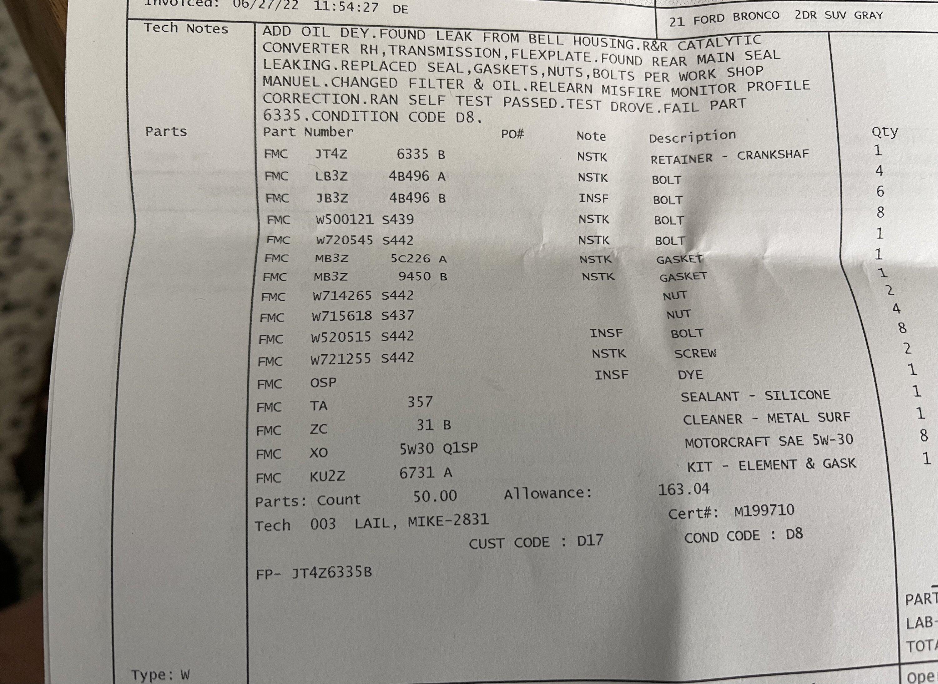

One week in shop, dealership said it be done in a week and they came through. Happy to have the Bronco back for some holiday weekend wheeling.
