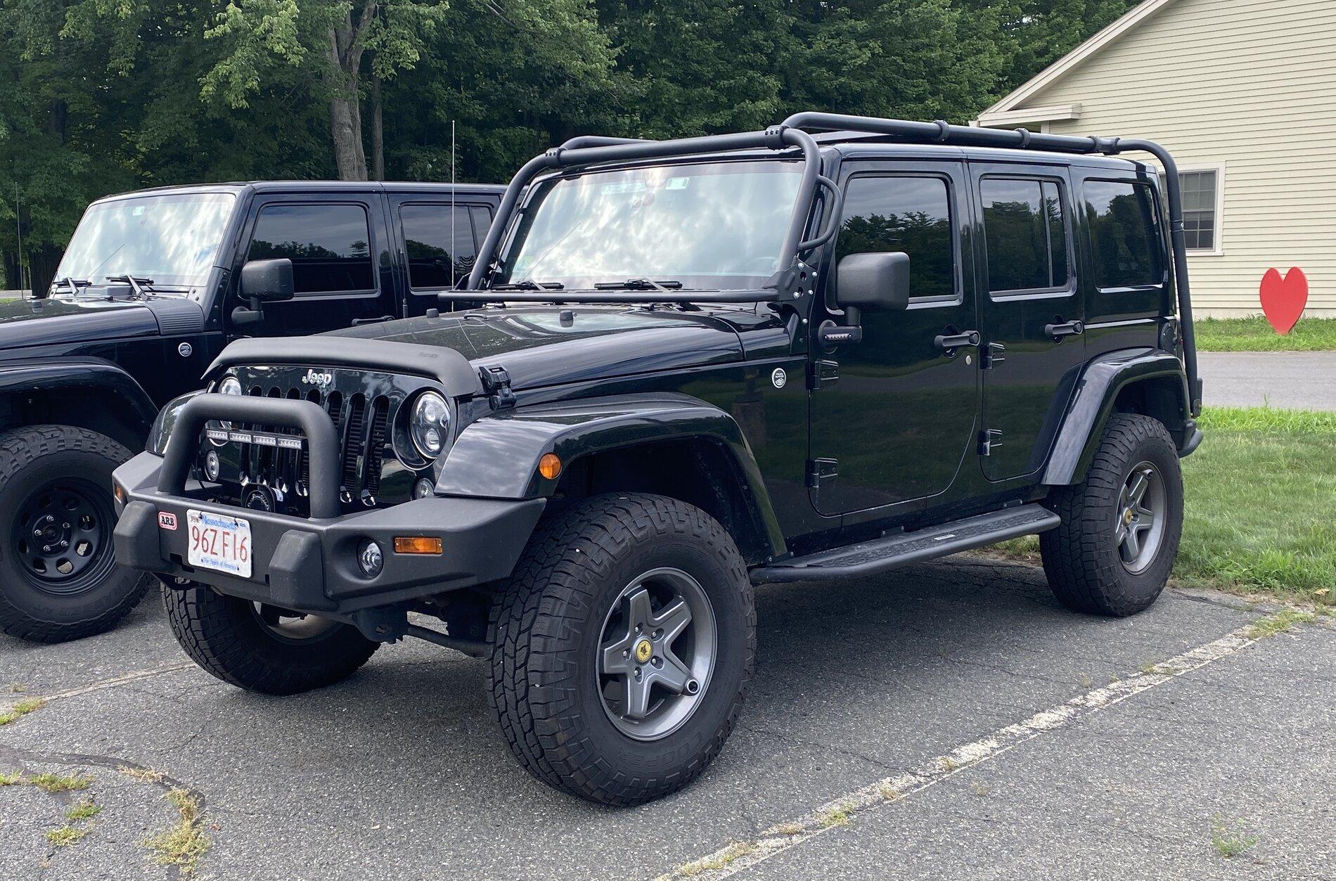

375lbs Dynamic.
850lbs Static.
Ford Bronco Rhino Rack Pioneer Platform IMG_6119
https://adventureracksystems.com/pro-jk-4-door.html
They also make a system (for the jeep) that attaches through the hardtop with the same load ratings.
I hope they come out with Bronco solutions eventually. I've been very happy with mine.
