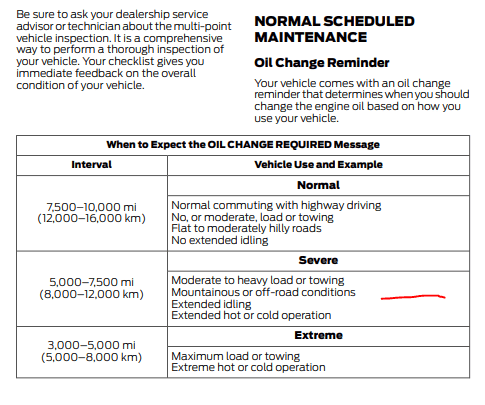

There are very few vehicles that meet the technical description of the "normal" maintenance schedule so we recommend 5K or "severe" duty. I have no idea why they say 10K is OK but from our experience it's not a good idea unless it's a diesel running highway miles.
Ford Bronco Service schedule and cost 1682971183413
