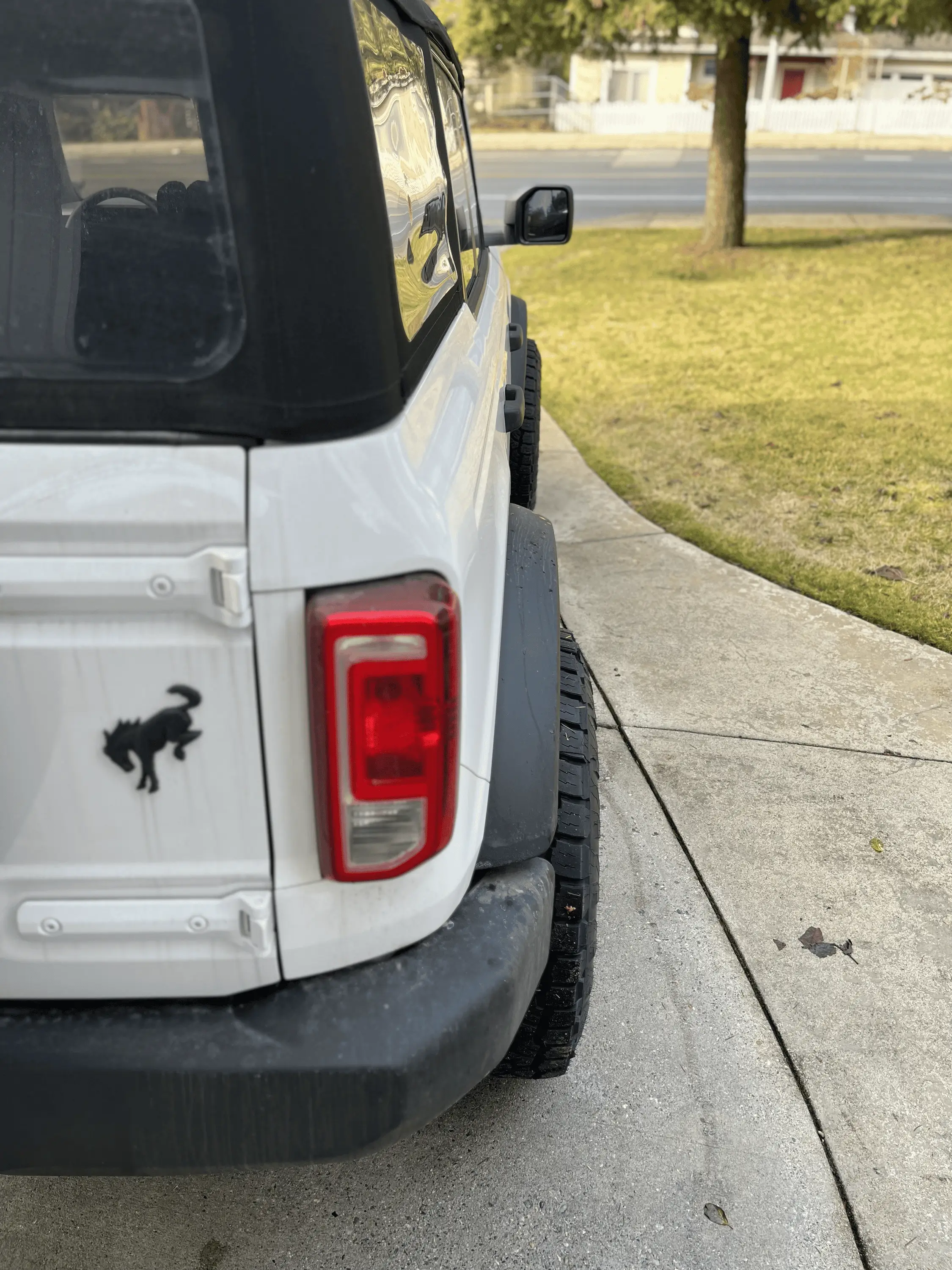

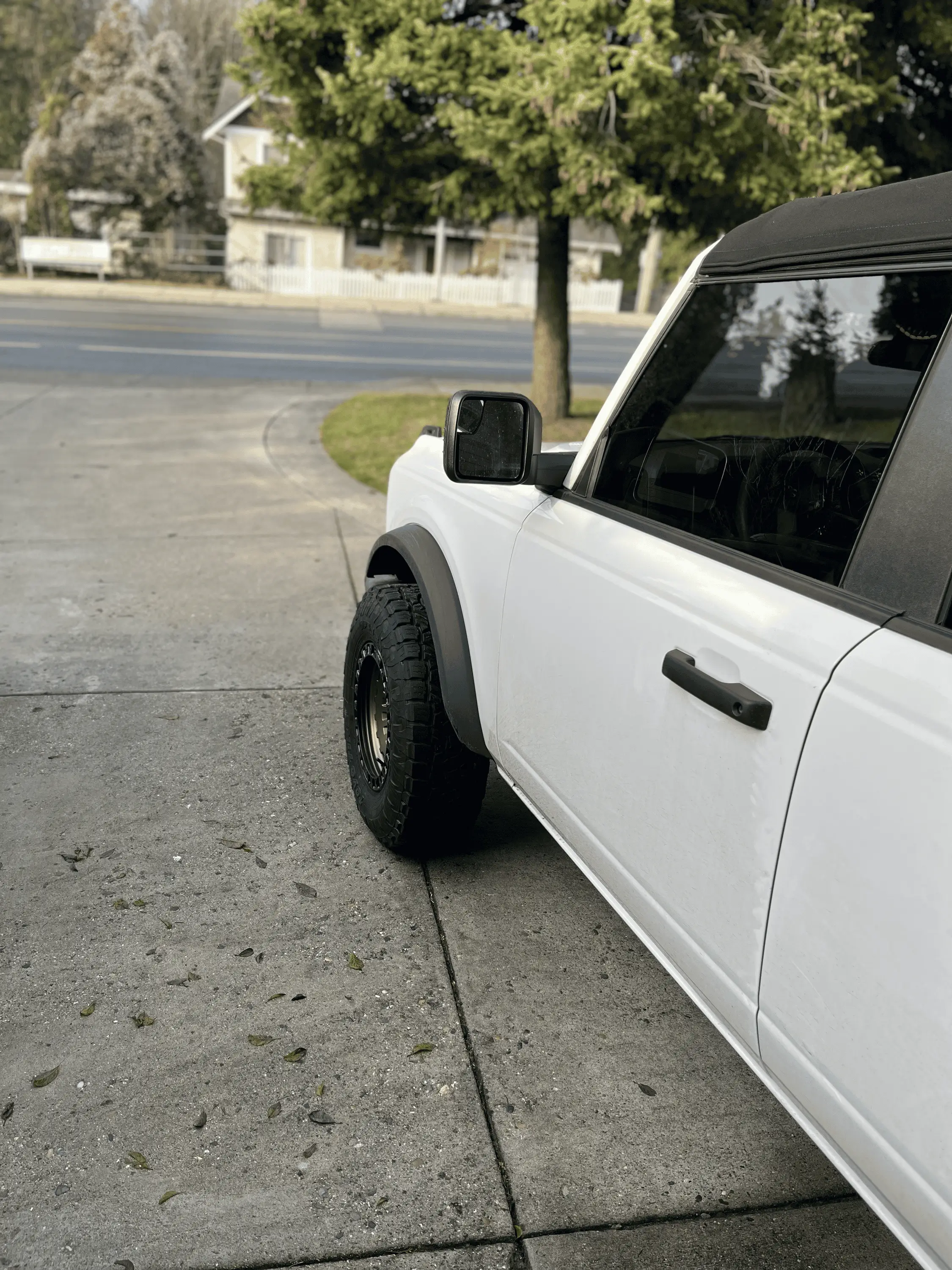

LT285/70R17 Fuel Zephyr -12 Offset :
Here are a couple pics, the 'poke' isn't as bad as I thought it was going to be, debating on finding some Sas Flares but I did install some Rock Blokz Mud Flaps this evening ( too dark for pictures). I did have the crash bars removed because there was some rubbing and could barely fit 1 sheet of paper between the tire and the crash bar at a Stand still...
