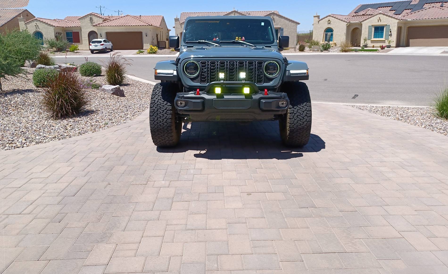

I am coming from a Rubicon X, where I had 2 sets of "cheap" 6 led 3 inch cubes installed on the front bumper and bull bar. When I did this I cut off the relay and switch in the light kit and used one of the Jeep's 4 aux switches (the low amperage ones (15 amps)) to power each set of lights.
Ford Bronco Simple Lighting Question 20240605_133422
I am assuming that I can do the same with the Bronco and use UP SW 6 as the hot for a pair of these lights. The reason I asking is the Jeep's switches were 15 & 40 amps, the bronco switches 4 - 6 are 10 amps and while I'm not too worried that 2 cheap" 6 led 3 inch cube lights will pull 10 amps, that is some of the THINNEST wire I have ever seen.
