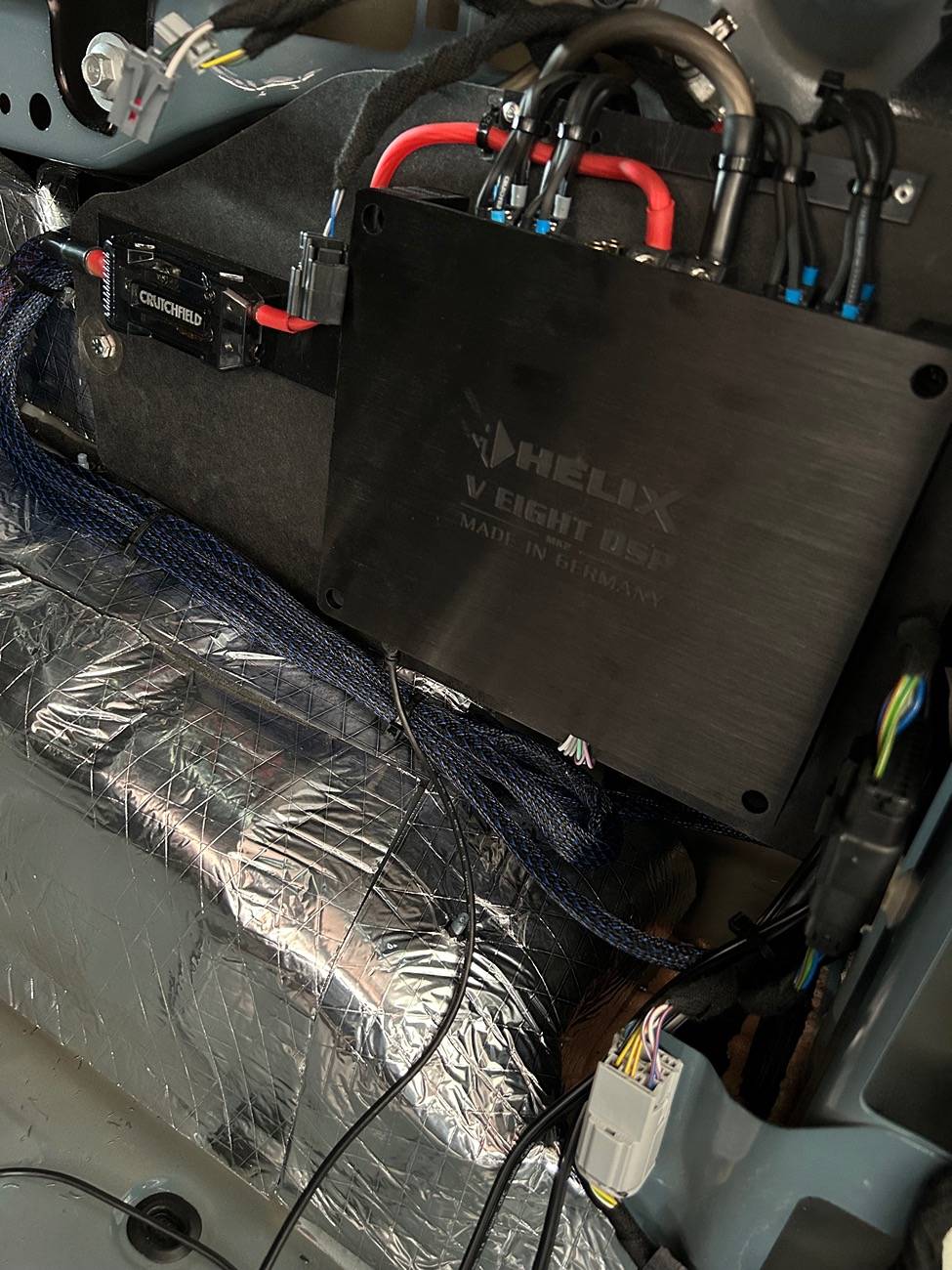

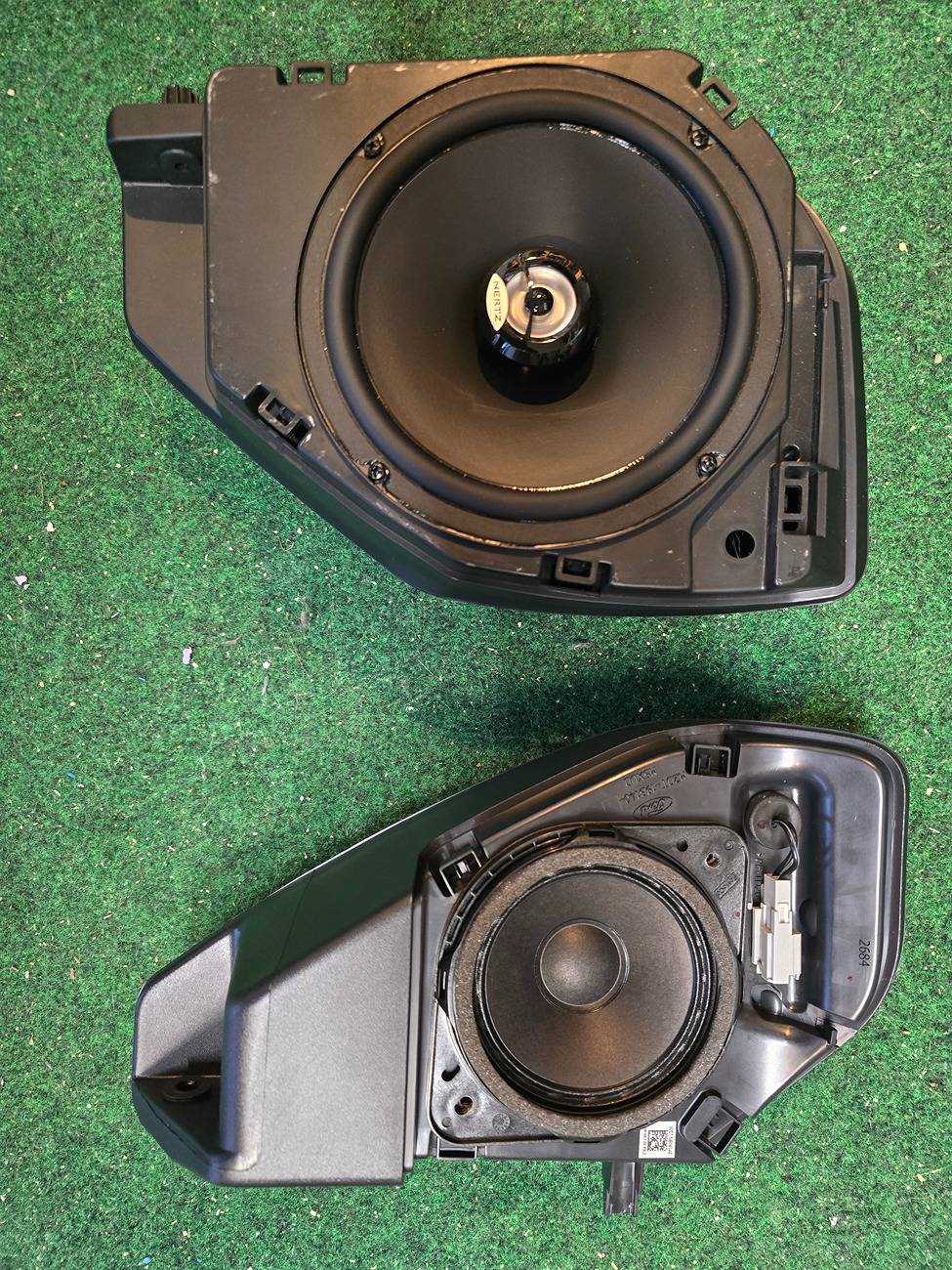

I went with a Helix V eight DSP 8 channel amp. Designed to work with Ford SB type amp without any additional level adaptors. No wires issues and sounds amazing after proper tune. Expandable as well.

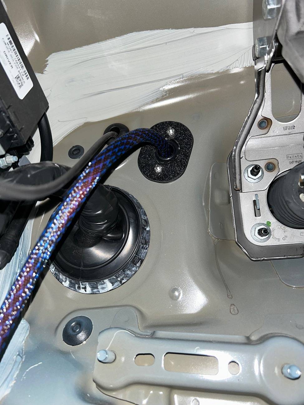

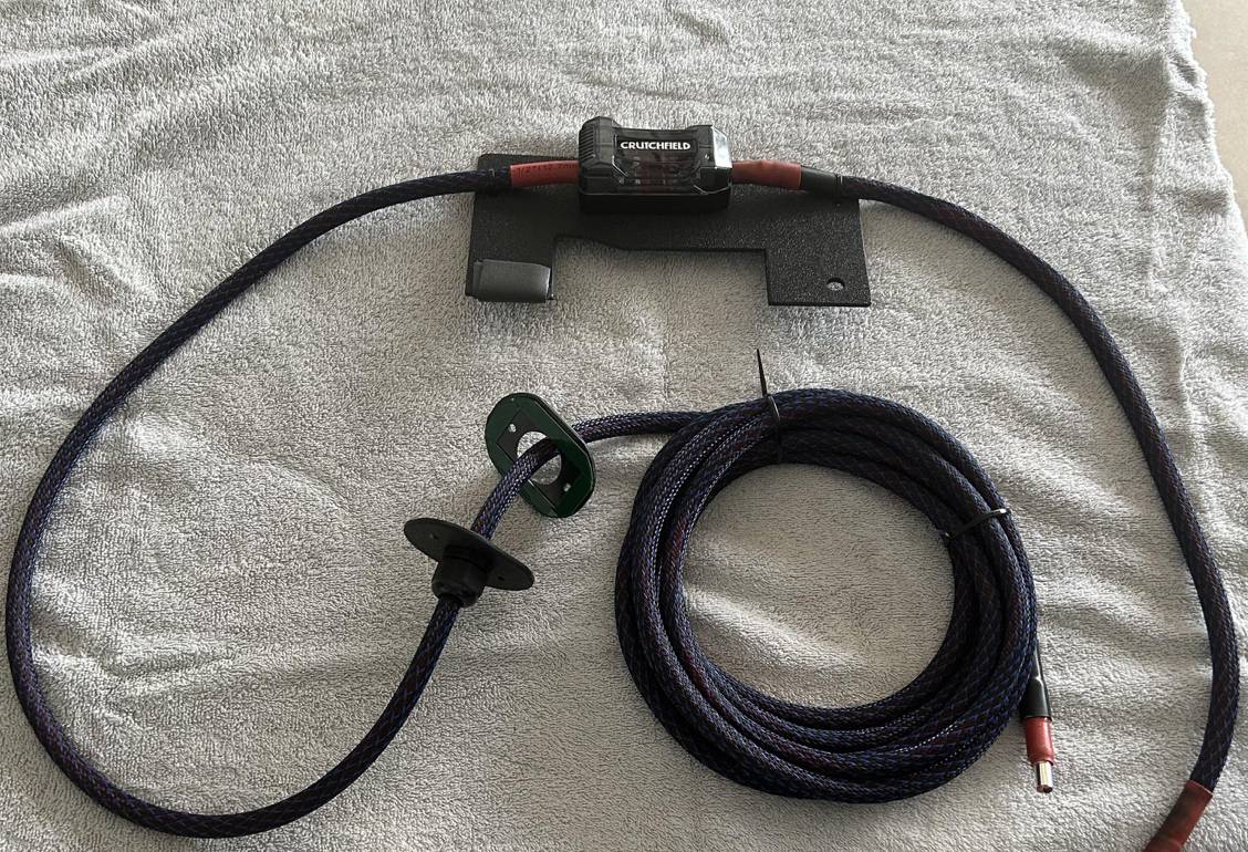

Fire wall is easy.

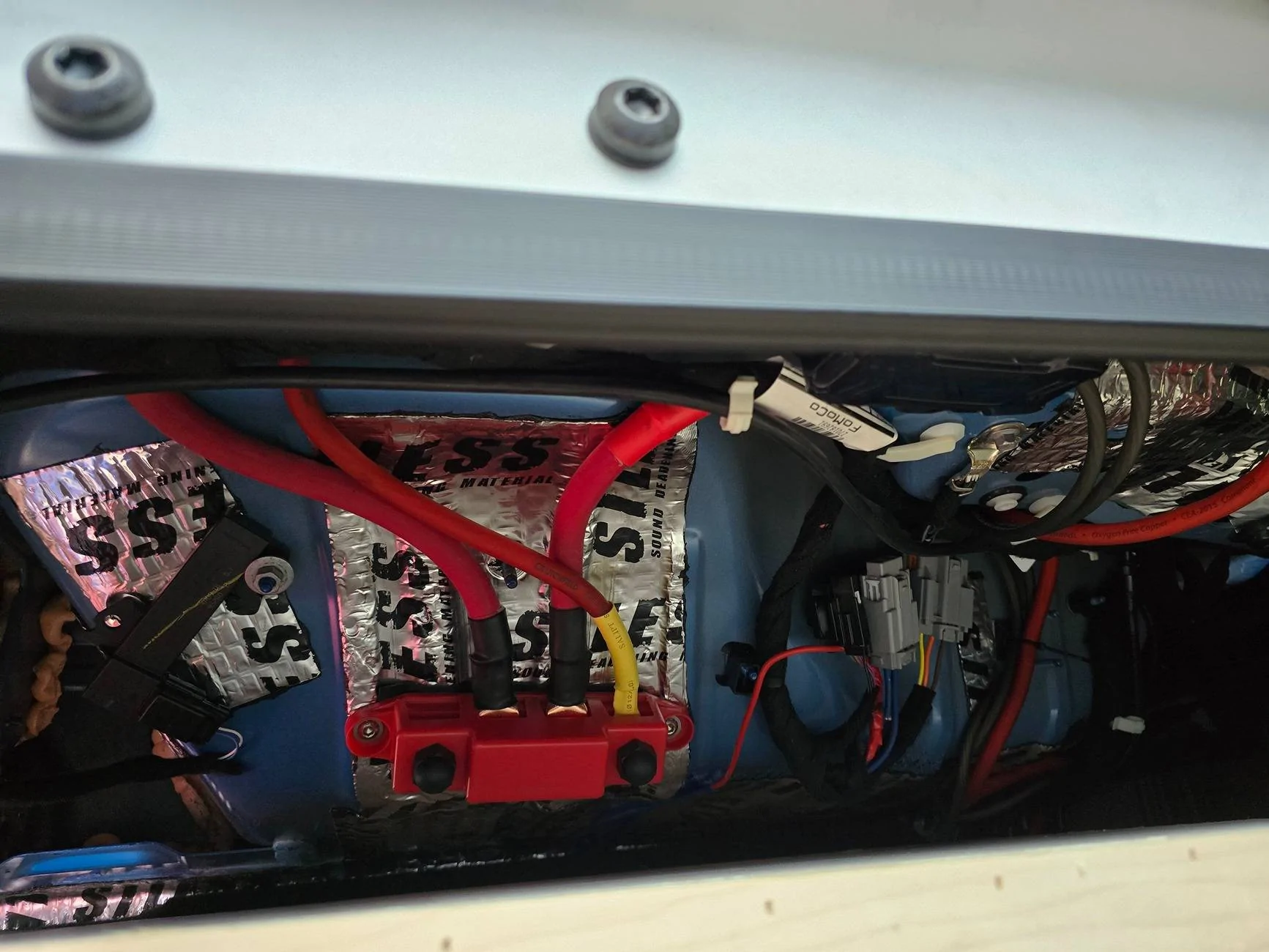

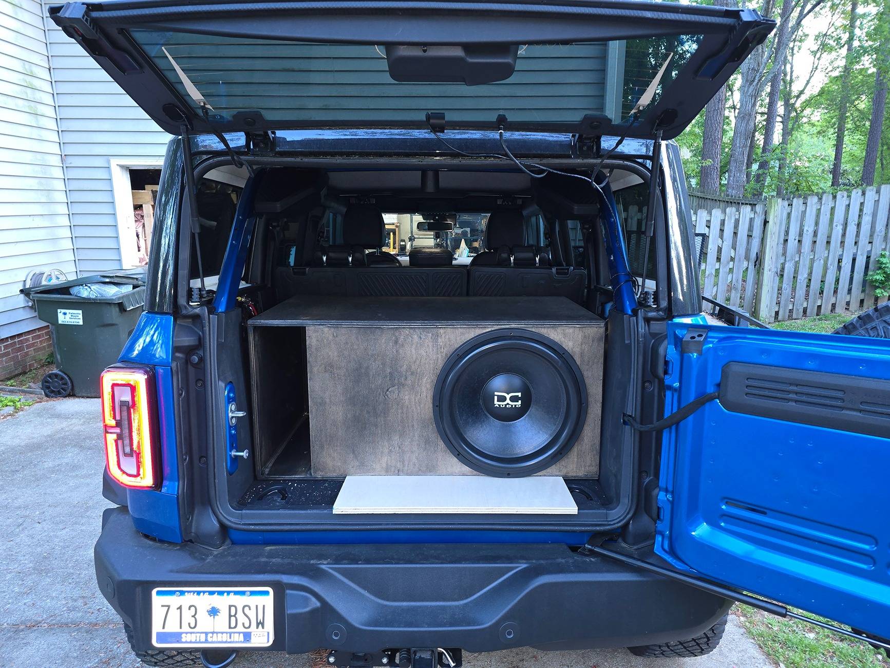

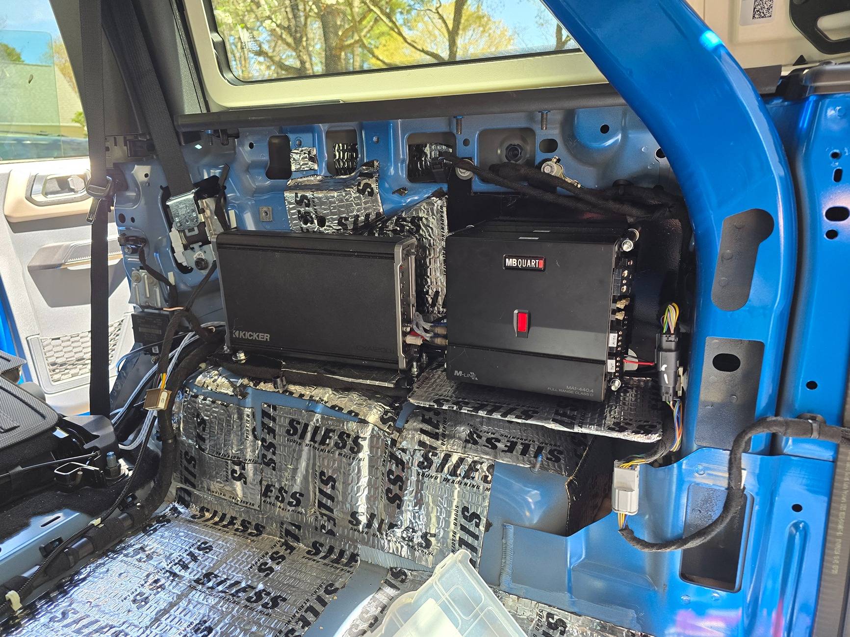

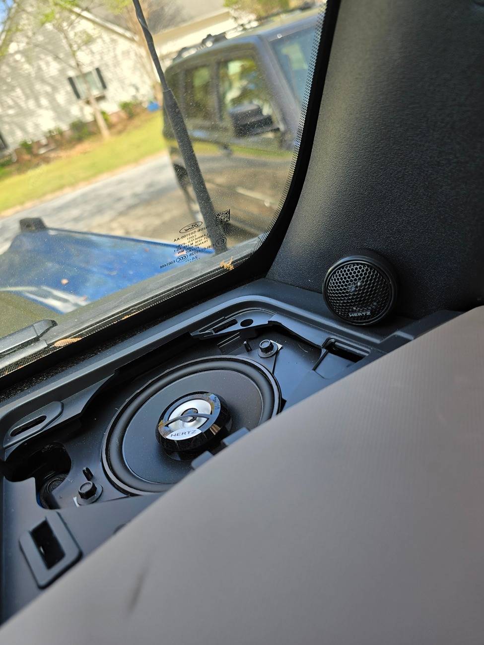

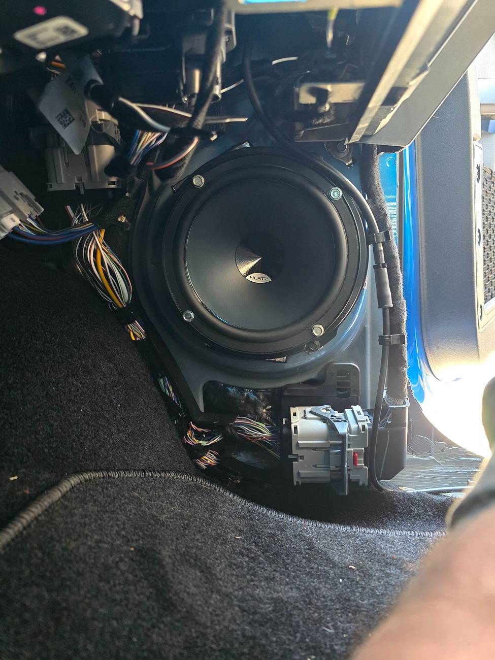

I overhauled the whole thing too. Used the PAC 4ch LOC and t-harness that feeds my JL TWK-88. From there, I have 2 MB Quart 440.4 amps. 1 runs the 4" dash and 6.5" rear and one runs the kick midbass 6.5" and the tweeters. Finally I have a Kicker CXA 1200.1 running a DC Audio 18”.
