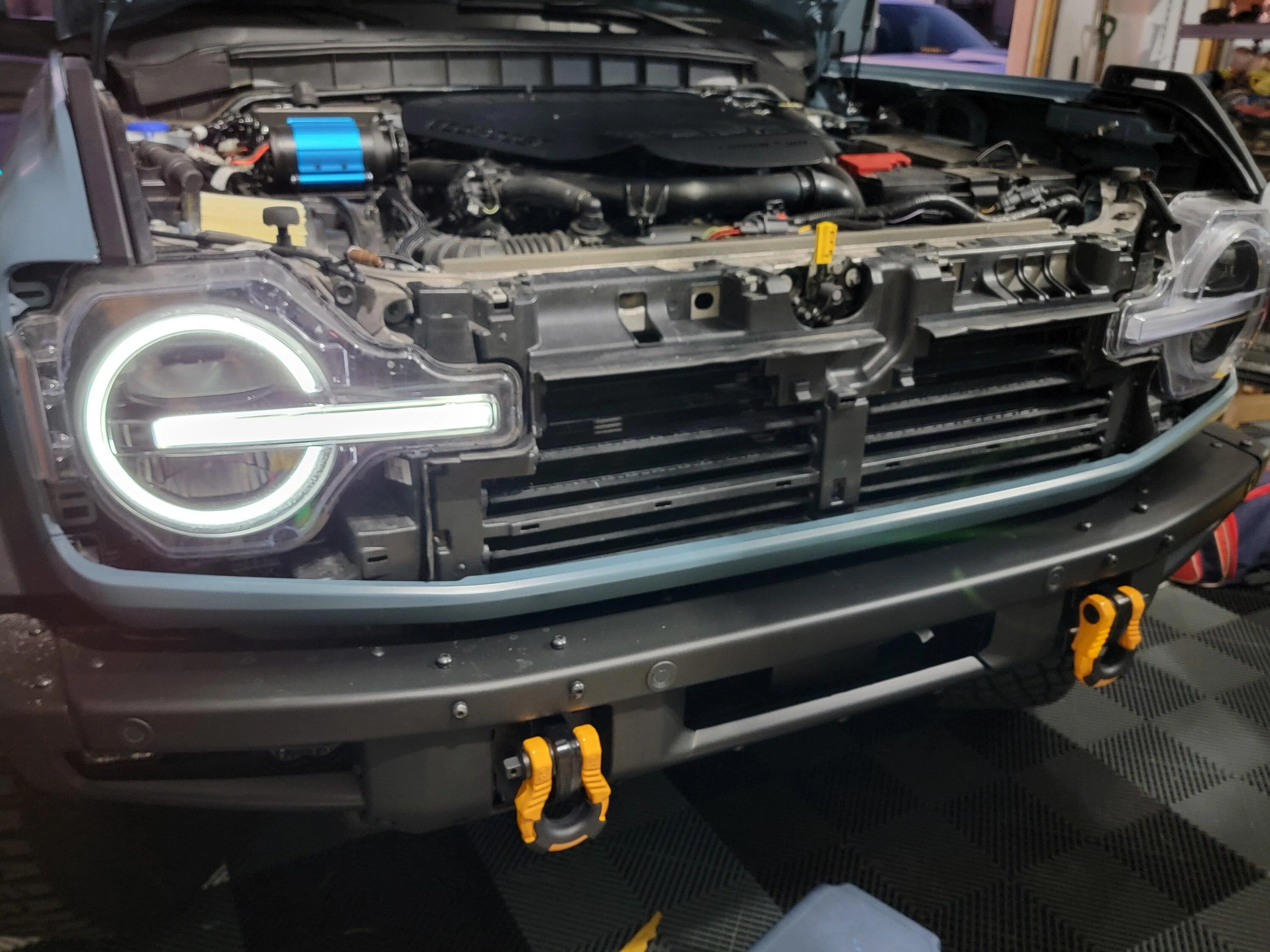

@SPVPARTS I’m having an issue that the passenger light stays lit up after the others turn off after installing. I haven’t yet connected to my backlight as waiting on it. Is that possibly the reason?

They have been great to work with. Should get the replacement part later this week. Will see if simlpy a bad part or more going on for the Bronco vs. Other Ford products where such a harness seems to work great. Simply connected my amber Raptor lights to Aux switch in the meantime. Hope to free that Aux switch up and have them come on with unlock/ lights etc without the gremlin of passenger light staying on as well as making blinker sound go crazy, but blinker worked appropriately.

Yes, the previous issues went away and they were looking into my return to see if could find wiring issue as it was first ever happening it sounds like on the many models they've used it on.
The only item I need to look into is whether on Lux and Signature headlights if the running lights turn on while car is sumply in Park and on. The running lights nor the "raptor" lamps were on the other day when I went into the garage real quick. I thought in such a situation they were on before. I haven't had a chance to have my wife put car in Drive to ensure they then come on at that point. At night all lights definitely work like they should.
