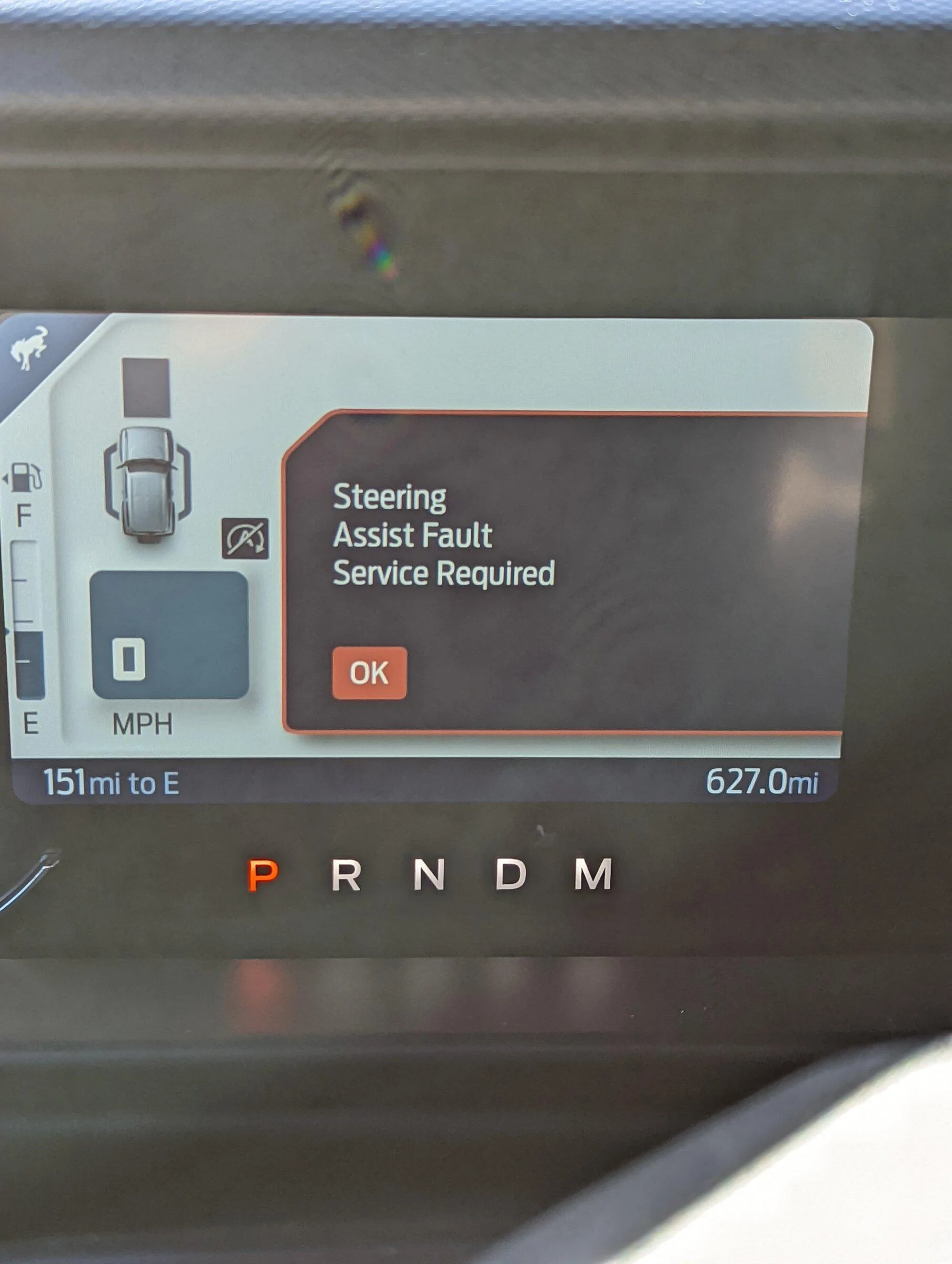

I may have missed it but I did't see anyone else post with this issue. Was driving last weekend on the highway and on the dash a warning came up "Steering Assist Fault Service Required" pic attached.
I was needless to say surprised as my FE had 630 miles and the steering was fine that day, so far. So I got to where I was going and the steering was tight, parking was difficult but not impossible. I did my errand, came back out and the warning light came right back on. Started to back out of the spot and could not turn the wheel, even while rolling back. Turned truck off, opened door. Locked, unlocked, opened door and started again , same thing. Called Ford, they said it didn't sound safe to drive and to call roadside assistance to get it flat bedded into service, but they won't be able to look at it for a week.
I muscled it back home to assess the situation, it did not get better but at least I was only 3-4 miles, mostly highway from home.
I had roadside pick it up Wednesday and so far haven't heard anything back, but I wasn't really expecting to, they are short staffed due to COVID and they know I have another vehicle to use, so it's all good to take some time.
One thought I had was that this was the first time that I drove the Bronco in sub freezing temps, it was around 9 degrees F that day. However when the flatbed driver drove it onto the truck Wednesday it was above freezing ~36 F and he had to manhandle the steering wheel to get it lined up, and he was a big dude. So I'm not convinced that the temperature was the only issue at play.
I guess I just wanted to see if anyone else has heard of any issues like this or not.

Subfreezing temps should have no impact on electric power steering.

I would imagine that the temp shouldn't be an issue, it wasn't that extreme.
Yes I will update this post as I get info from the dealership. Thanks.

Ok folks, dealer drove it around for 5 days and couldn't replicate the issue. They contacted Ford premium support, or whatever it's called, they told them to check all of the connectors and pins to the associated sensors, etc and look over the wire harness. Nothing unusual found.
Without any sensors reading out of spec and the tech never experiencing the issue, they couldn't do anything and gave it back to me as is.
Frustrated is an understatement.

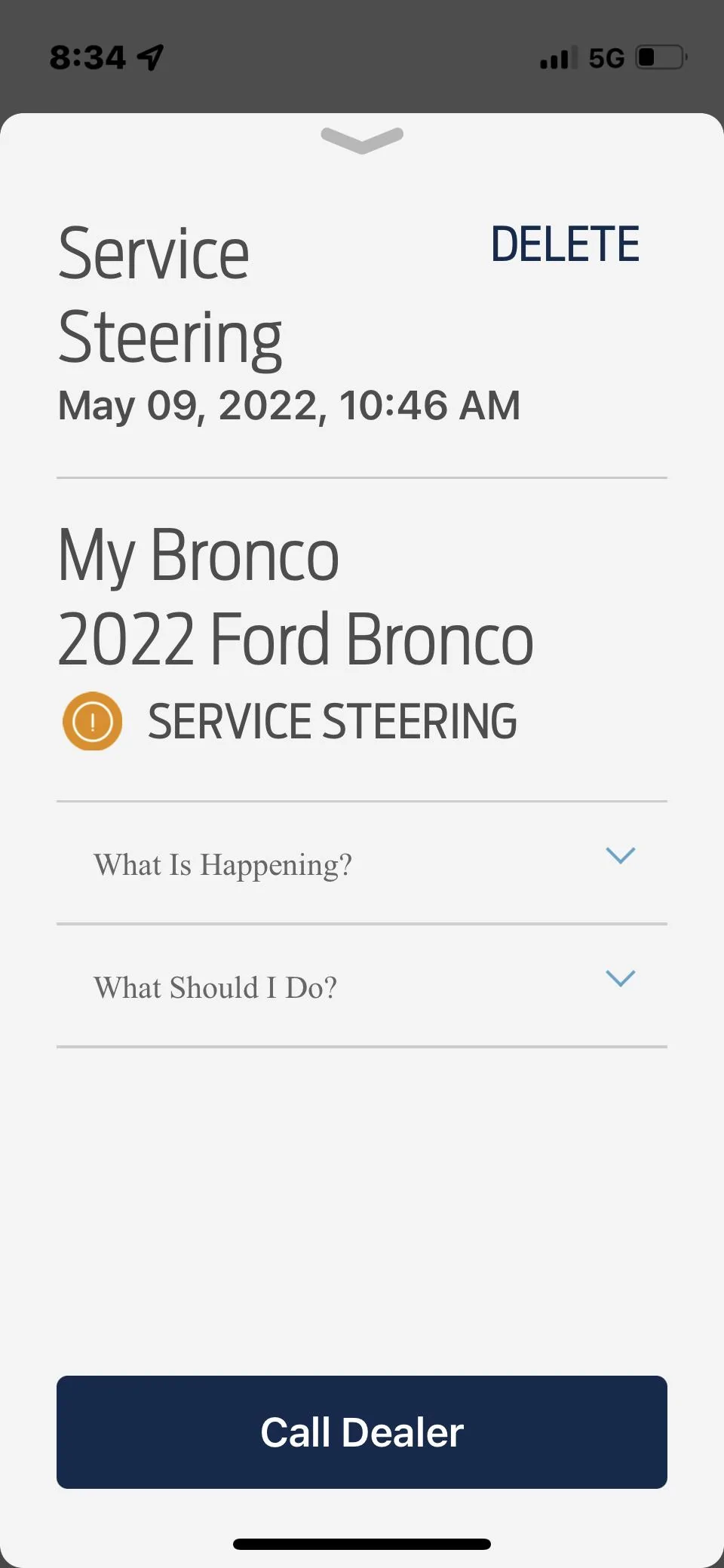

I just returned home from my dealer after checking on the health of my 2022 Badlands 7 speed manual with the same fault code. My dealer said EPS module needs to be replaced. They said no ETA on part availability and will let me know once availability is known. I've had the failure intermittently since day one 4/16/22. Fault only seemed to happen in reverse, but dealer said it happen to technician today when test driving in gears other than reverse.
I wanted to take it home, but Service Manger said I couldn't....??
I was very happy until today...hopefully positive news on parts soon. I still making payments, and no use of vehicle.

I've gotten this same fault since we took delivery, sometimes it happens multiple times a day, usually only when the steering is turned to full lock. It feels like its only a warning and nothing is physically wrong, no noise and no lack of performance.
I'd love to get it cleared but definitely dont want the bronco to be sitting at a dealer until forever waiting on a small part.

At first, they said the power steering rack had to be replaced and they were not sure about lead-time on part. Luckily, they found one but then had trouble locating the required single use bolts required to install. When they received all the parts and went to do the install, they found out it was not the rack but a faulty wiring harness to the power steering rack. All is well now. Total time at the dealer, 8 days
