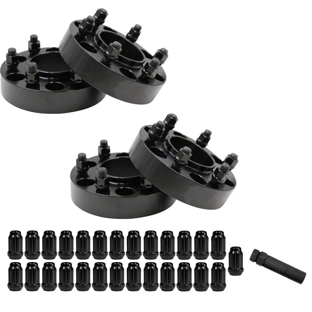

Wheel Spacers - Install
Ford Bronco Sunny B: Build Tracker ima

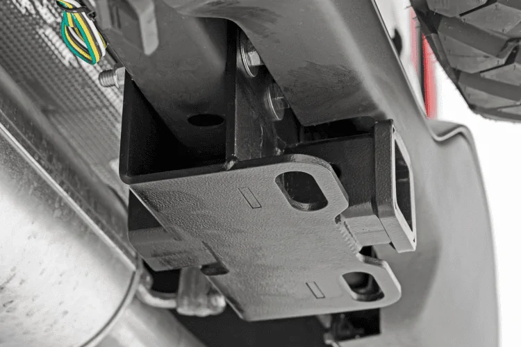

Somehow Ford didn't put a tow package on. I'm not sure exactly where the ball was dropped, but don't really care to check either. I tossed this on.
Hitch Receiver Class III -
Ford Bronco Sunny B: Build Tracker 1653373436591

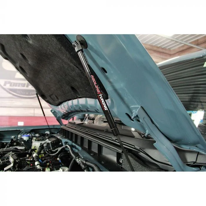

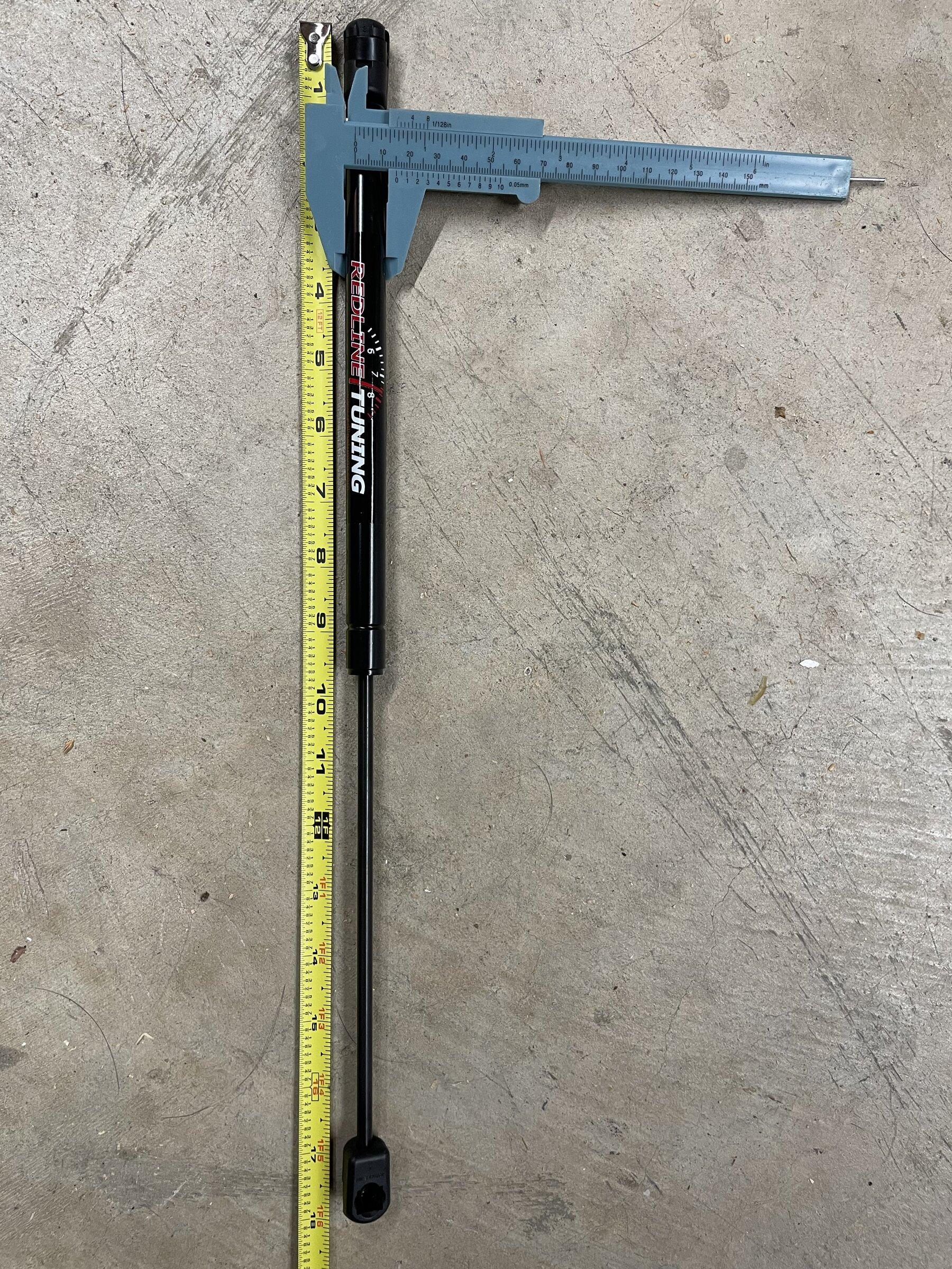

Looks like a great build..
Question, did you receive the struts for the hood riser? If so, what is the overall length of the strut/ length of just the gas spring?
Thanks in advance!
Thanks in advance!
Thanks!
No prob, here's a photo:

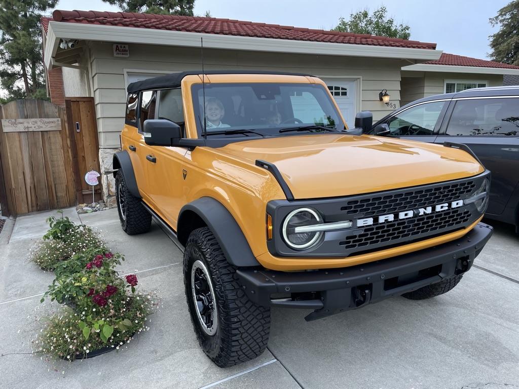

Ford Bronco Sunny B: Build Tracker 9324CCB0-0DF2-495A-A5C4-4F439A1F4B13_1_105_c
It's Here, how do people do these build journals?
I think I'm going to document my projects as comments and then try to link to the comments from the first post where I keep a tally of what has been added, and where I got it from.

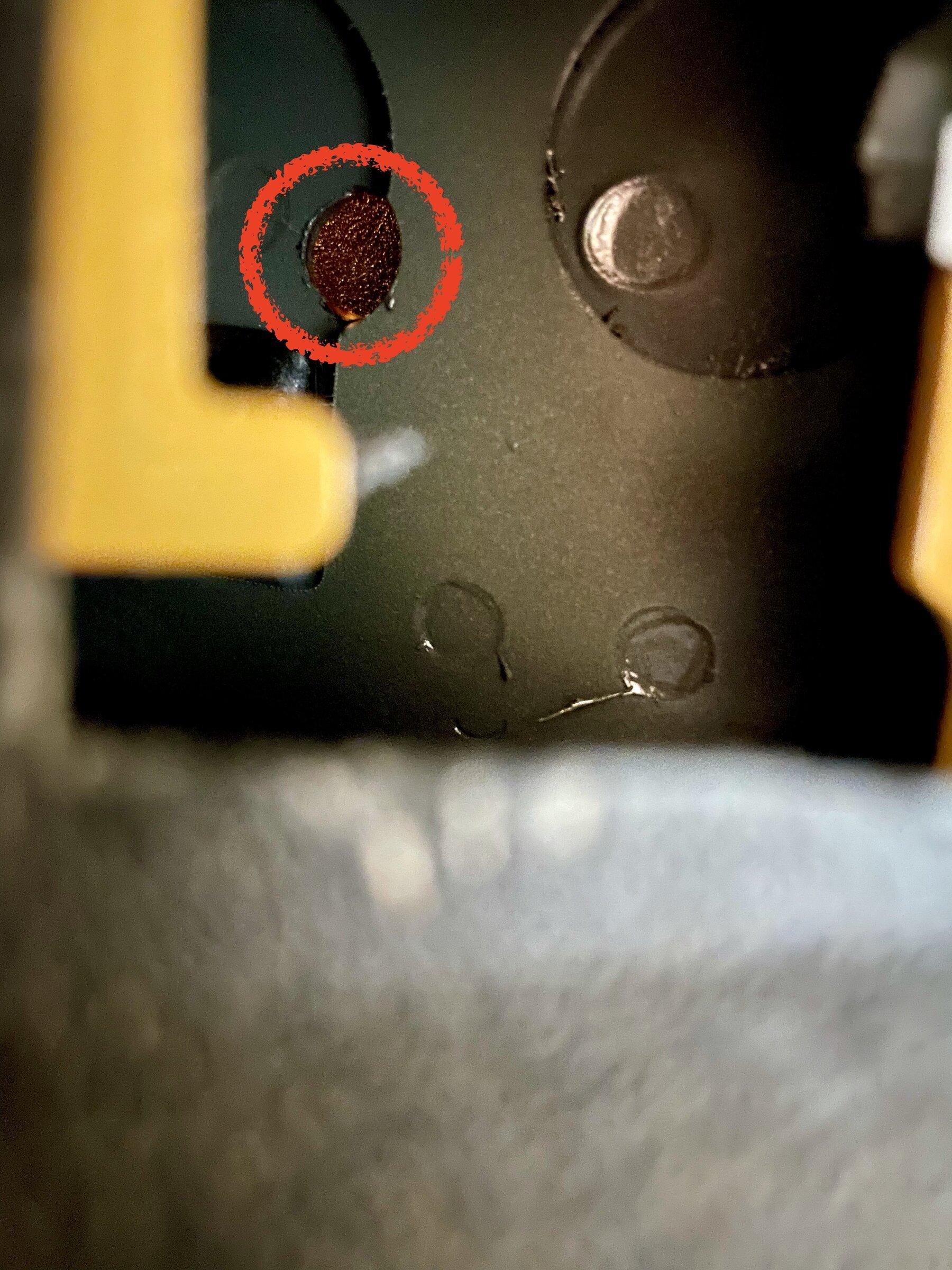

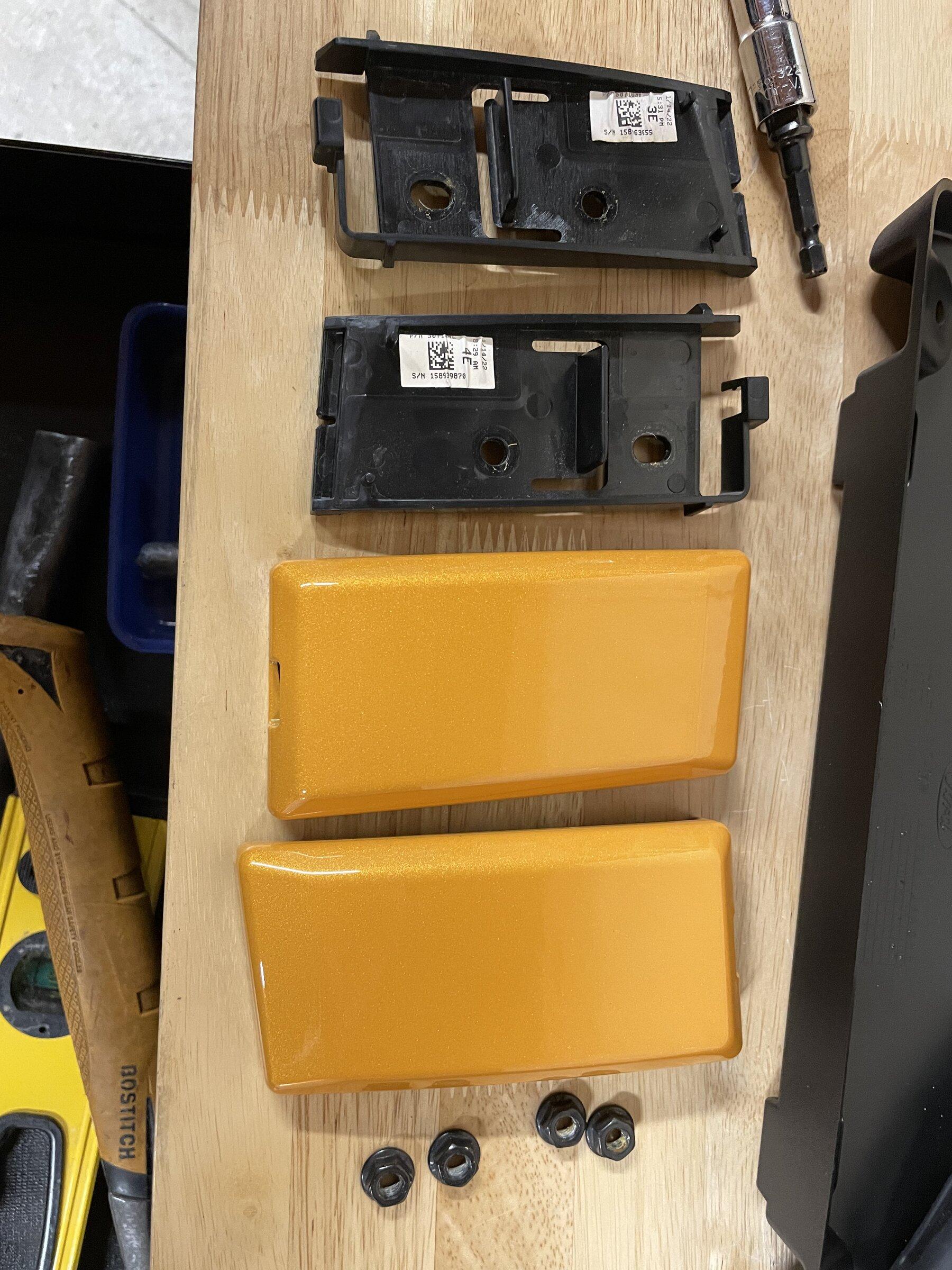

First Install: The Light Bar
Started by removing the covers:
Ford Bronco Sunny B: Build Tracker IMG_6221

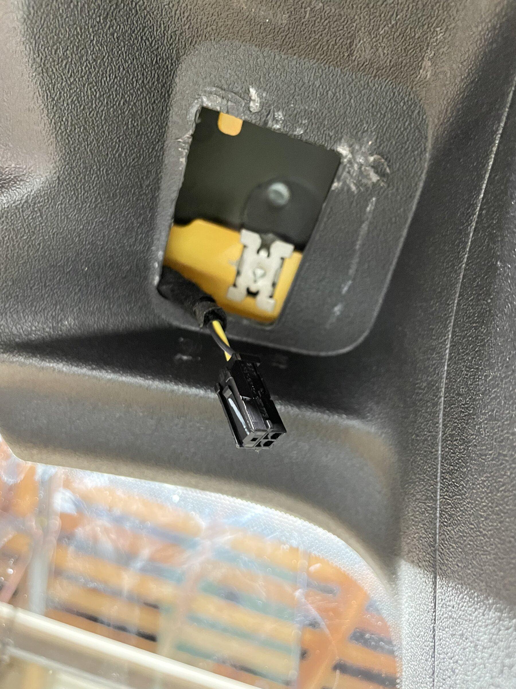

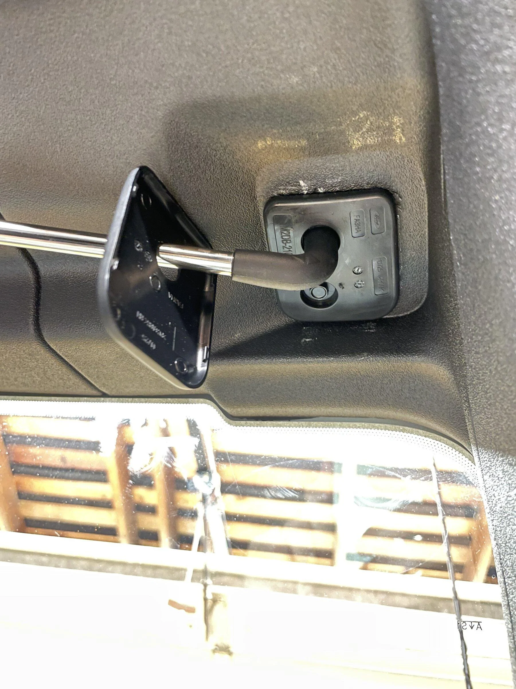

Then I noticed there's no wire, I read it's above the visor. Just pry the cap off, then unscrew and remove the visor.
Ford Bronco Sunny B: Build Tracker IMG_6218
You'll also need to unplug the power cable for the vanity mirror light.
Ford Bronco Sunny B: Build Tracker IMG_6226

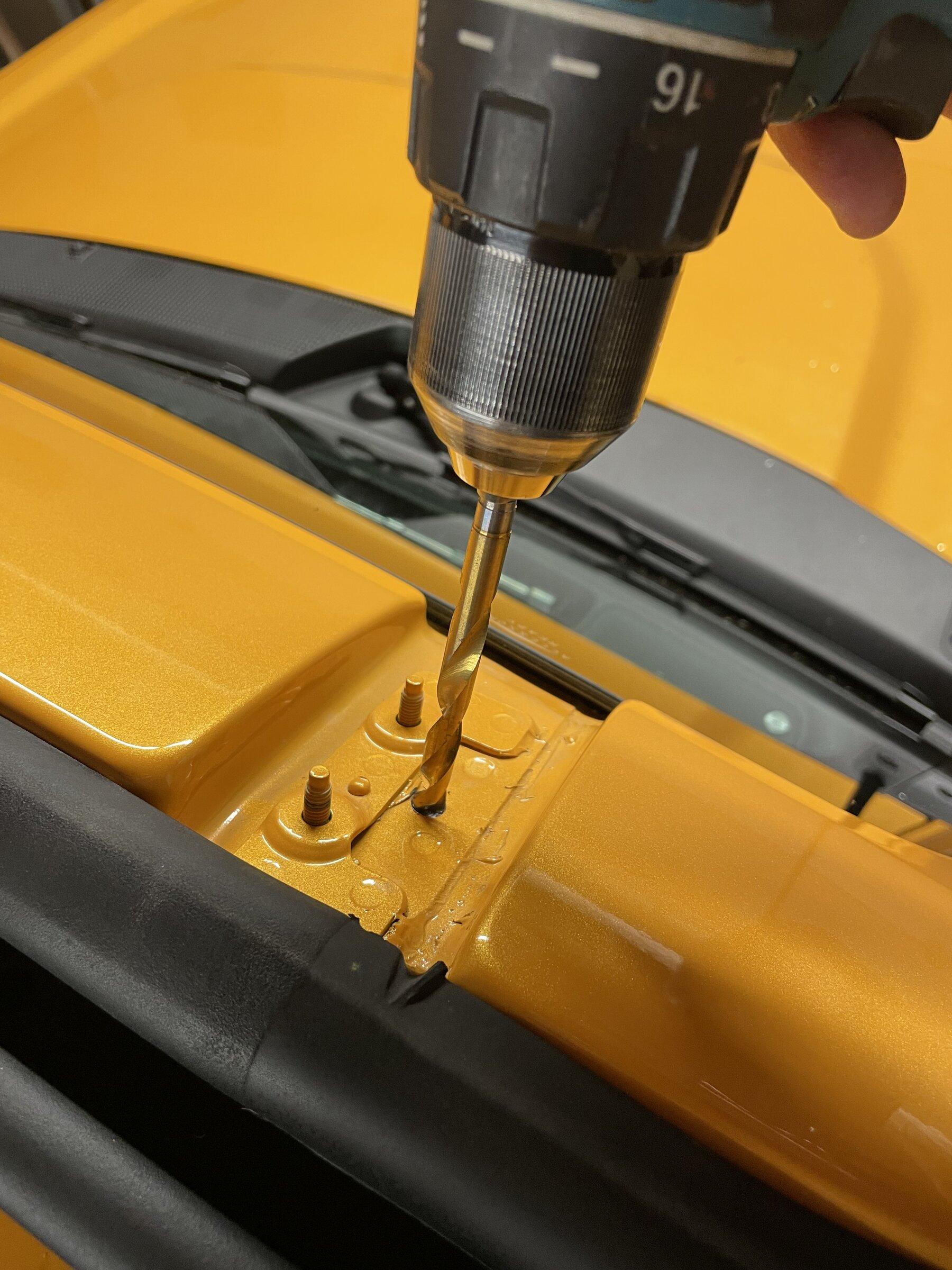

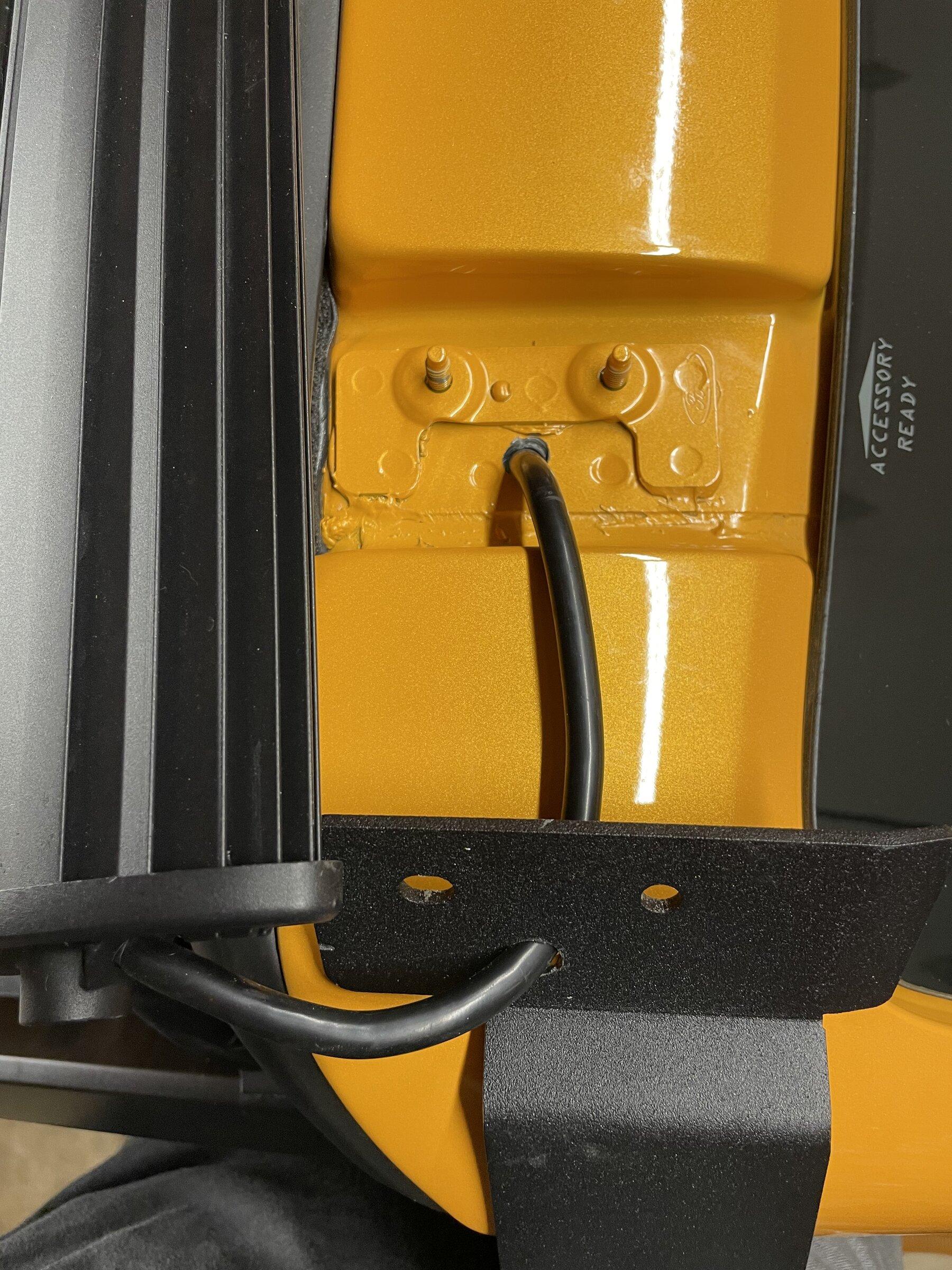

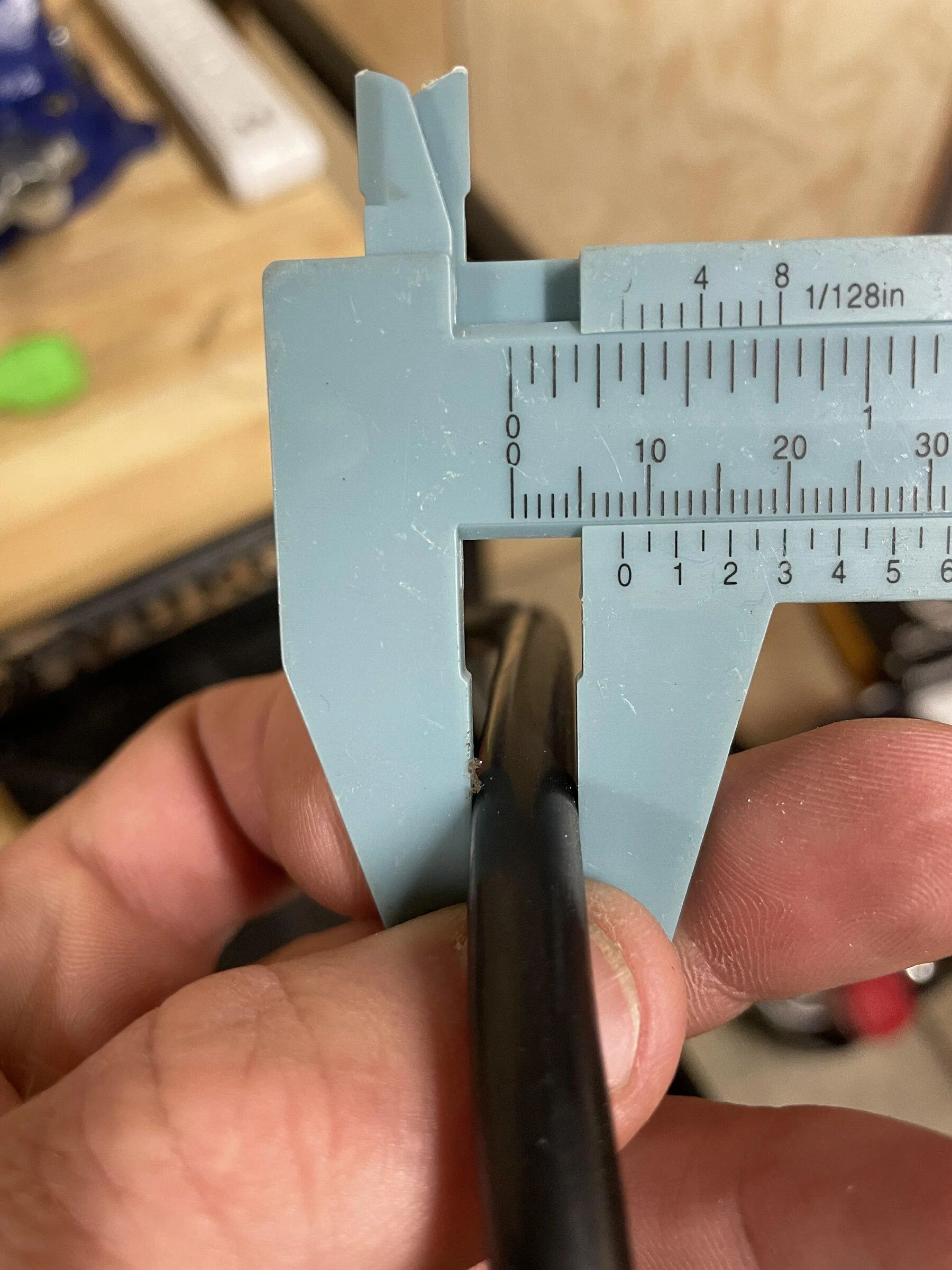

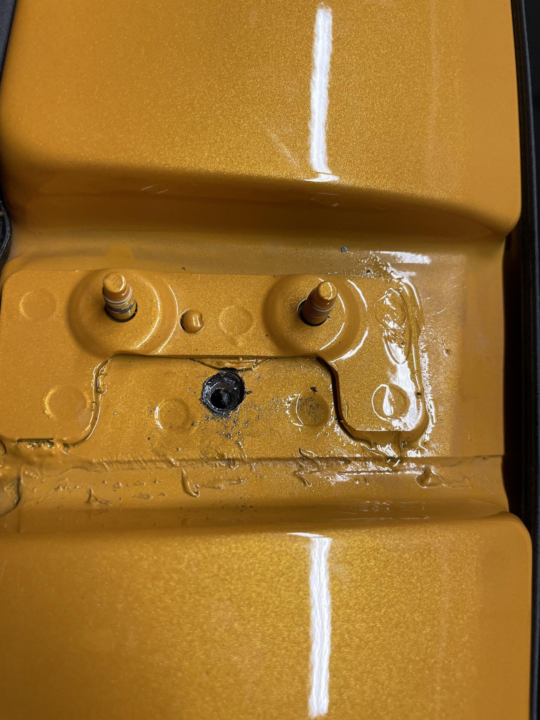

Now you need to feed the light bar's power cable into the cabin. Unfortunately you need to drill through a few layers.
Be sure to drill the size of the full cable with the secondary shield, don't strop to the individual wires to reduce the size of the hole. This is important to ensure friction never rubs a hole through the wire and causes a short. I probably should have drilled just a tad larger, but I was more worried about staying water tight.
Ford Bronco Sunny B: Build Tracker IMG_6220
Ford Bronco Sunny B: Build Tracker IMG_6222
Ford Bronco Sunny B: Build Tracker 67350212073__10A46A52-543A-4B80-9A3E-744316A37C2B
Ford Bronco Sunny B: Build Tracker IMG_6229
Notice that if I had gone a tad higher then I could have avoided that partial layer.

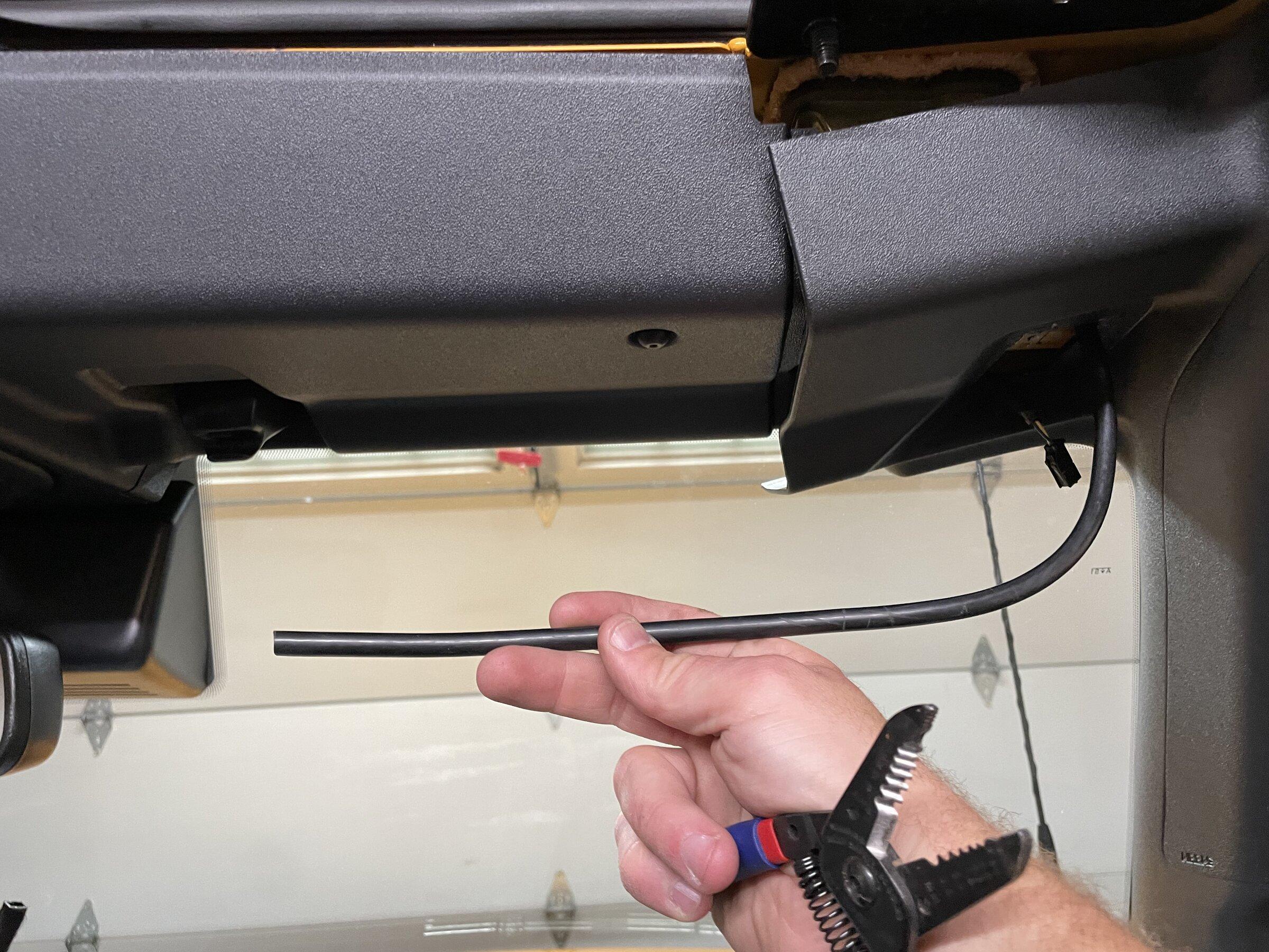

Now fish your power wire through. Mine came in a really long cable with a fancy waterproof connector on the end. Just cut that off, and run the wire through the hole into the car. Leave about 6" to be sure it's not pulling tight when you mount the bar.
Ford Bronco Sunny B: Build Tracker IMG_6231
I left a little extra length to be sure no wire were stretched tight, because plan to do a lot of bouncing around with this thing.
Ford Bronco Sunny B: Build Tracker IMG_6233

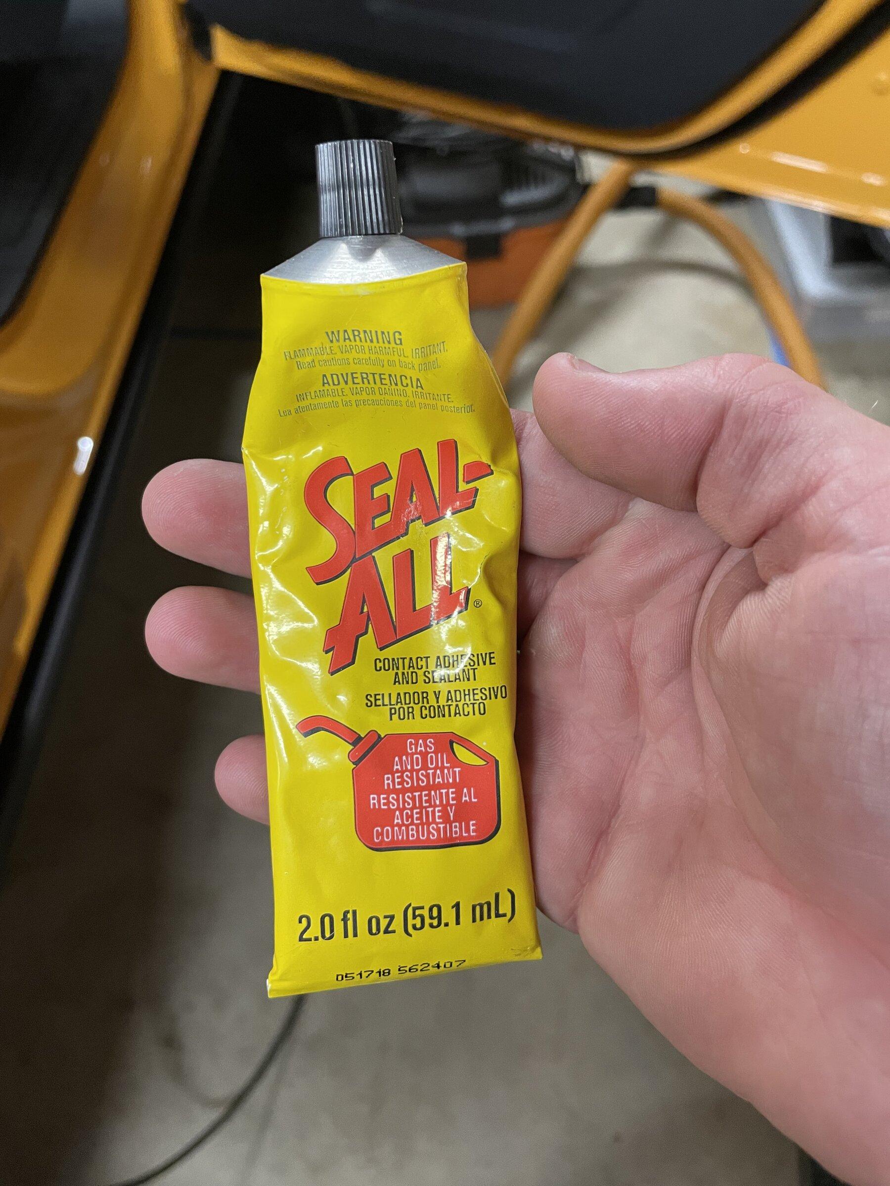

Then cover it in a nice silicone or urethane sealant. I had a few random things, and decided to try this one.
Ford Bronco Sunny B: Build Tracker IMG_6232

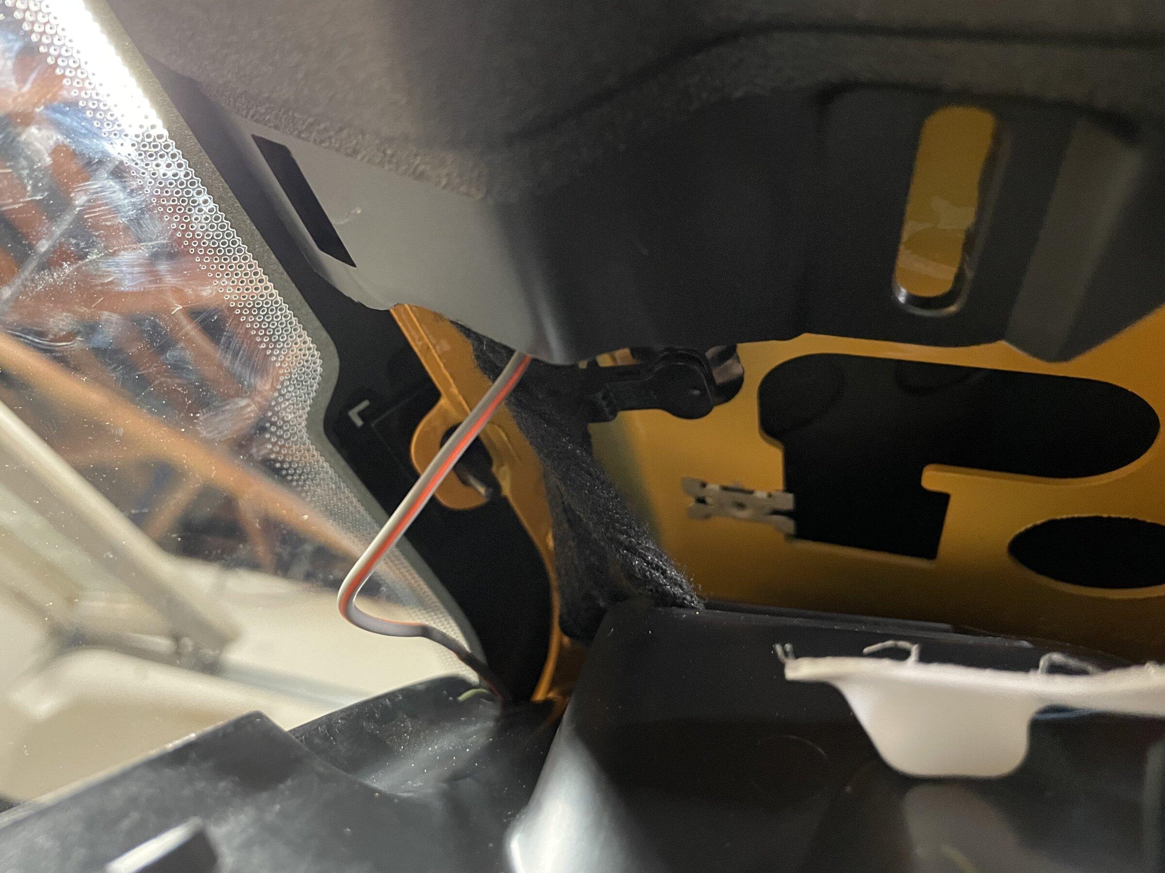

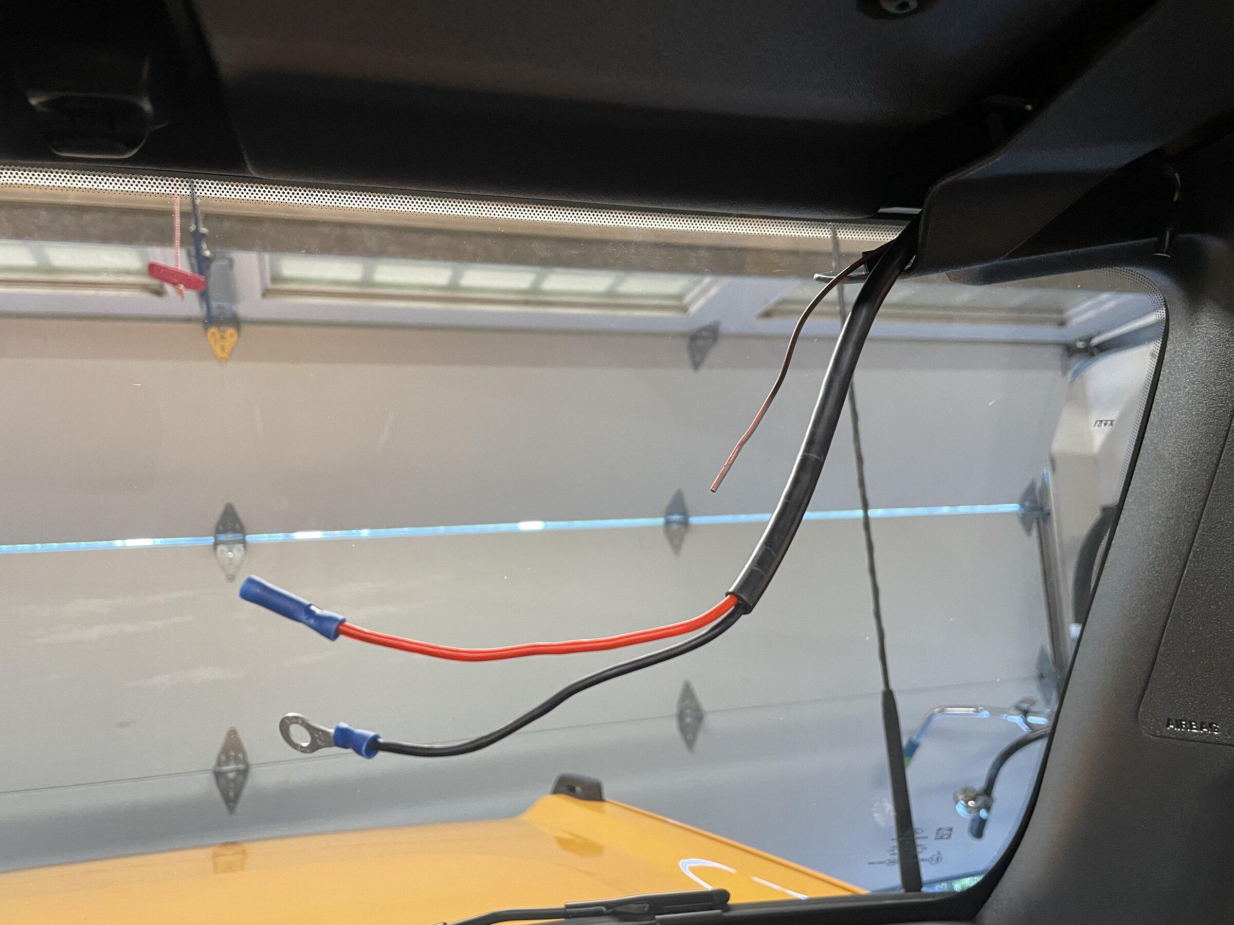

Then you'll need to fish out the grey / orange wire (looks more red to me).
Ford Bronco Sunny B: Build Tracker IMG_6219
I had to use blue crimps because my light was a higher gauge.
I should have checked that the cable Ford provided was a sufficient gauge for the current I'm running...
But I used a butt crimp for the power (grey/orange), and a ring thermal crimp for the ground. I probed the bolts and the black coating didn't seem to impede the conductivity. I just unscrewed the nearest screw under the molding and put my ground there.
Ford Bronco Sunny B: Build Tracker IMG_6251
