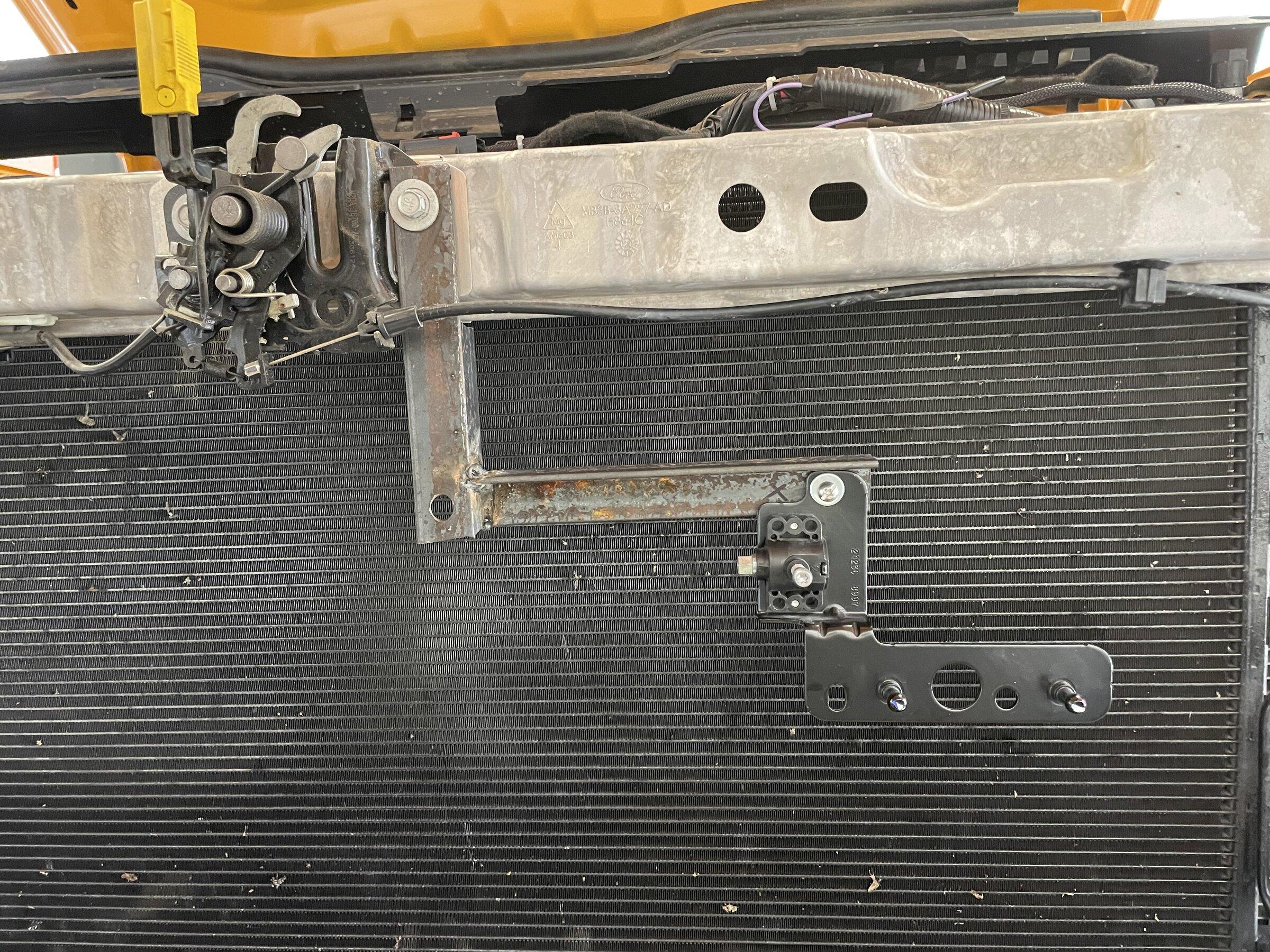

Since I didn't see a way for this to work for everyone easily, I found some random angle iron and welded a relocation bracket for my ACC sensor. I'm sure there are many ways to figure this part out, good luck!

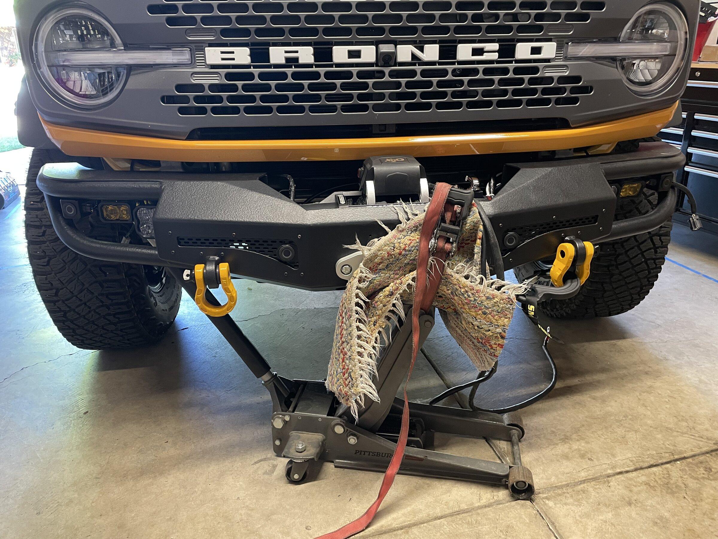

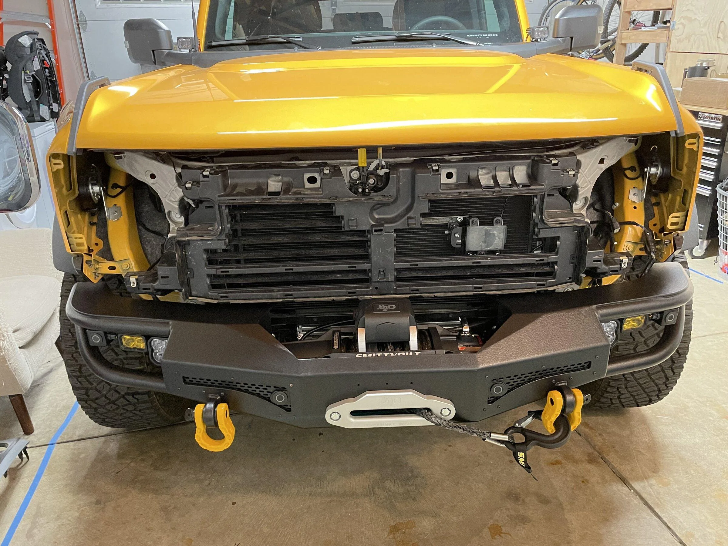

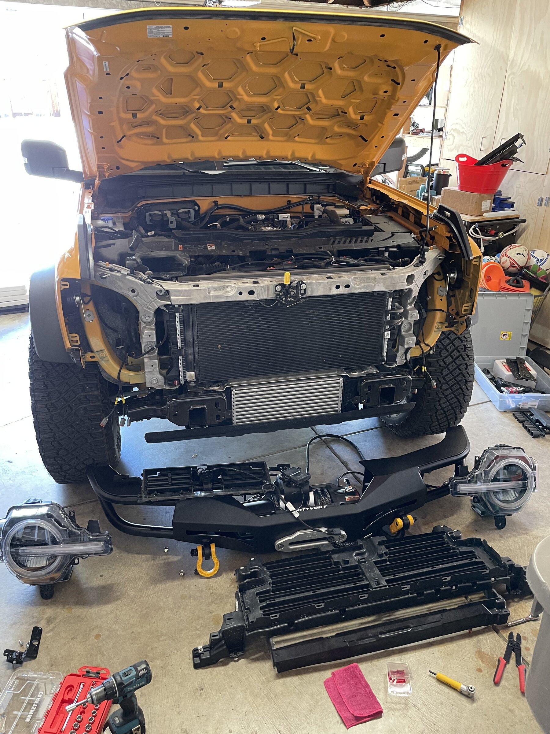

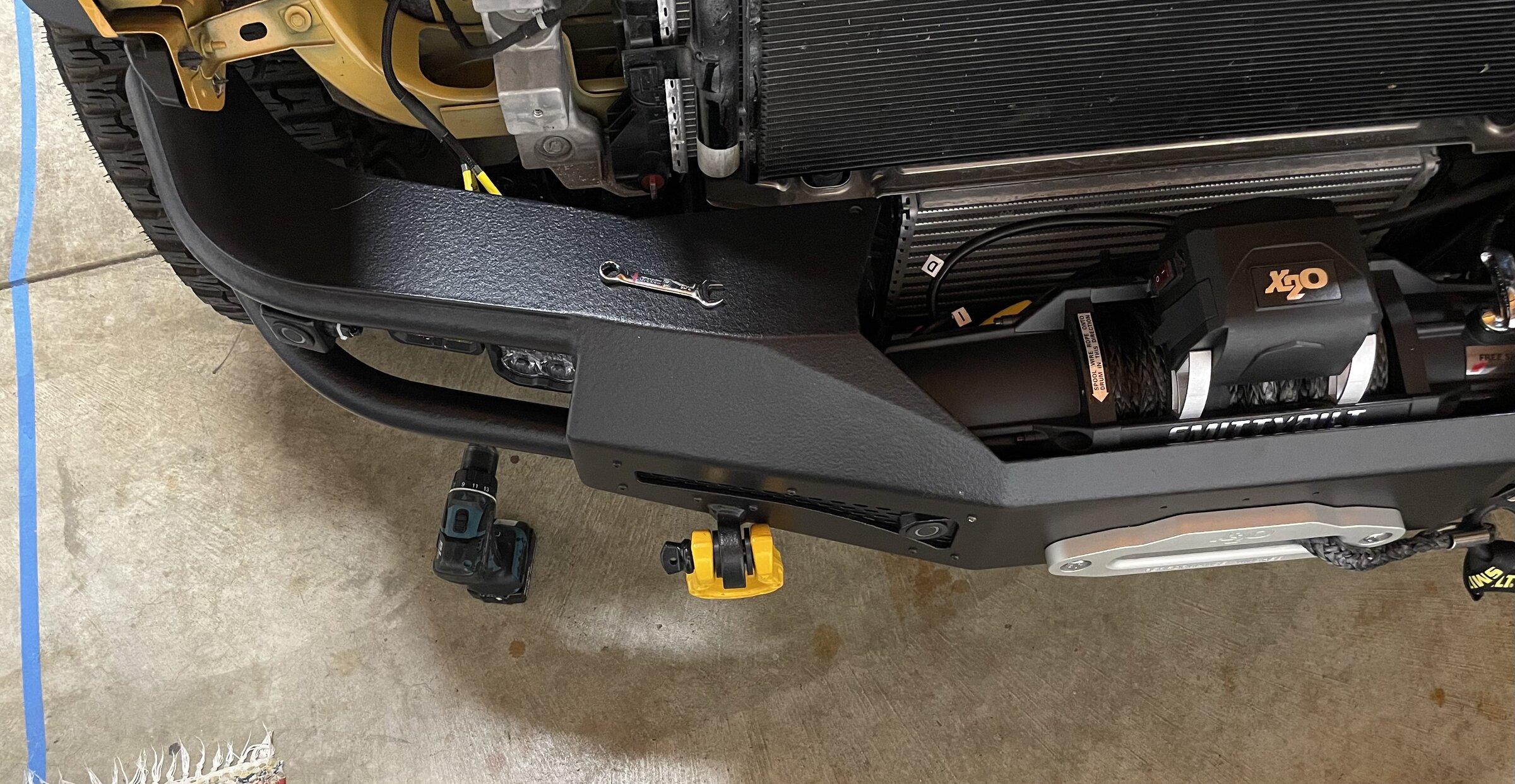

Now pop everything back together, and prep your bumper to be installed. This thing is heavy, and even more so with the winch and such so you'd be better to have three people for this step.
If you don't have two friends around (which was my case) here's an old trick I used to swap transmission by myself without a lift. You can get the bolts in finger tights like this, and then use the jack on each side to get the gap you want between the bumper and car panels before fully tightening.
Ford Bronco Sunny B: Build Tracker IMG_6600

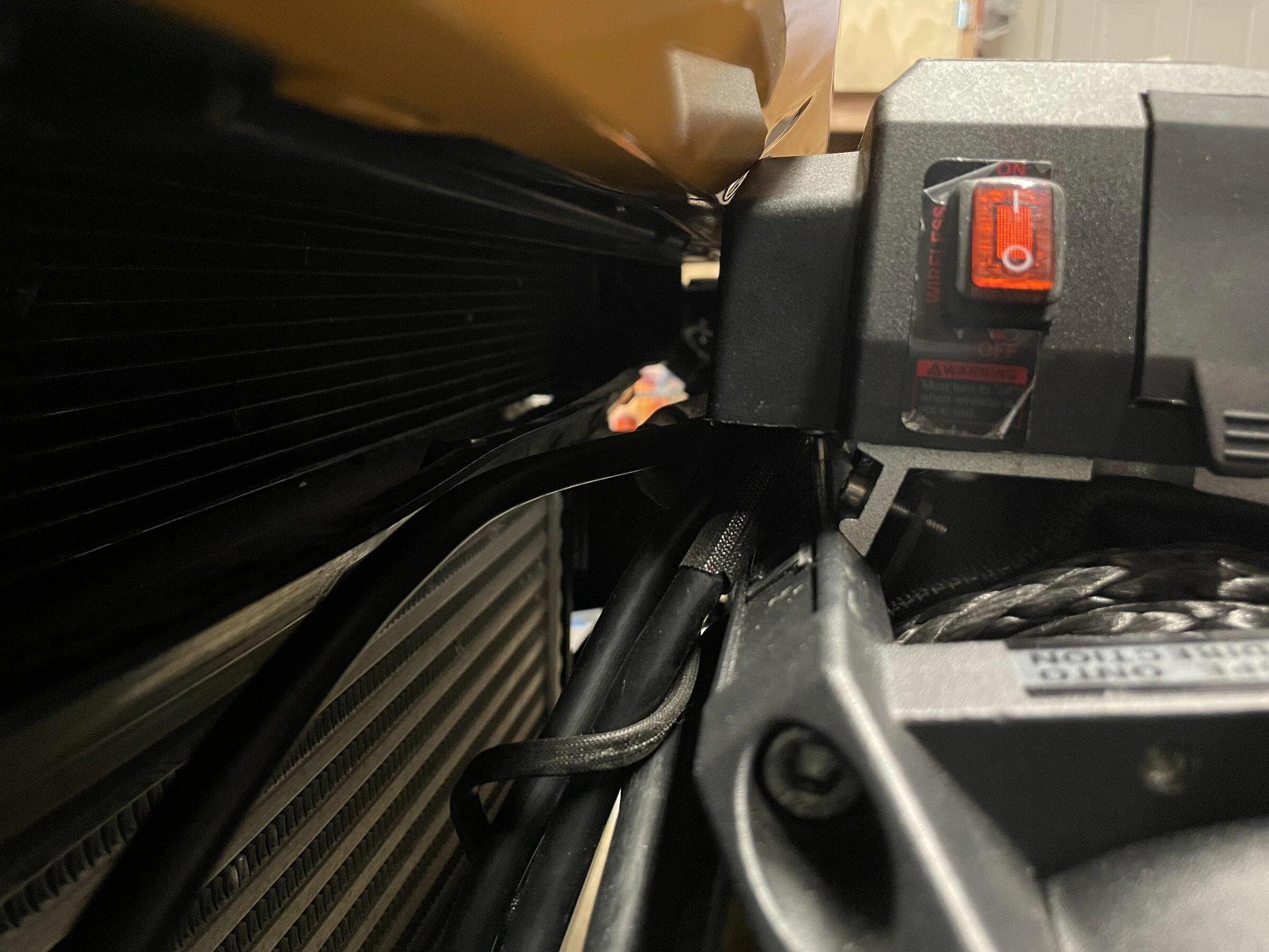

I didn't want a big gap between the bumper and car, and wanted to keep ground clearance / approach angle maxed, so I kind of smashed the winch into the panel below the grill. This is what you call self-clearance.
Ford Bronco Sunny B: Build Tracker IMG_6601

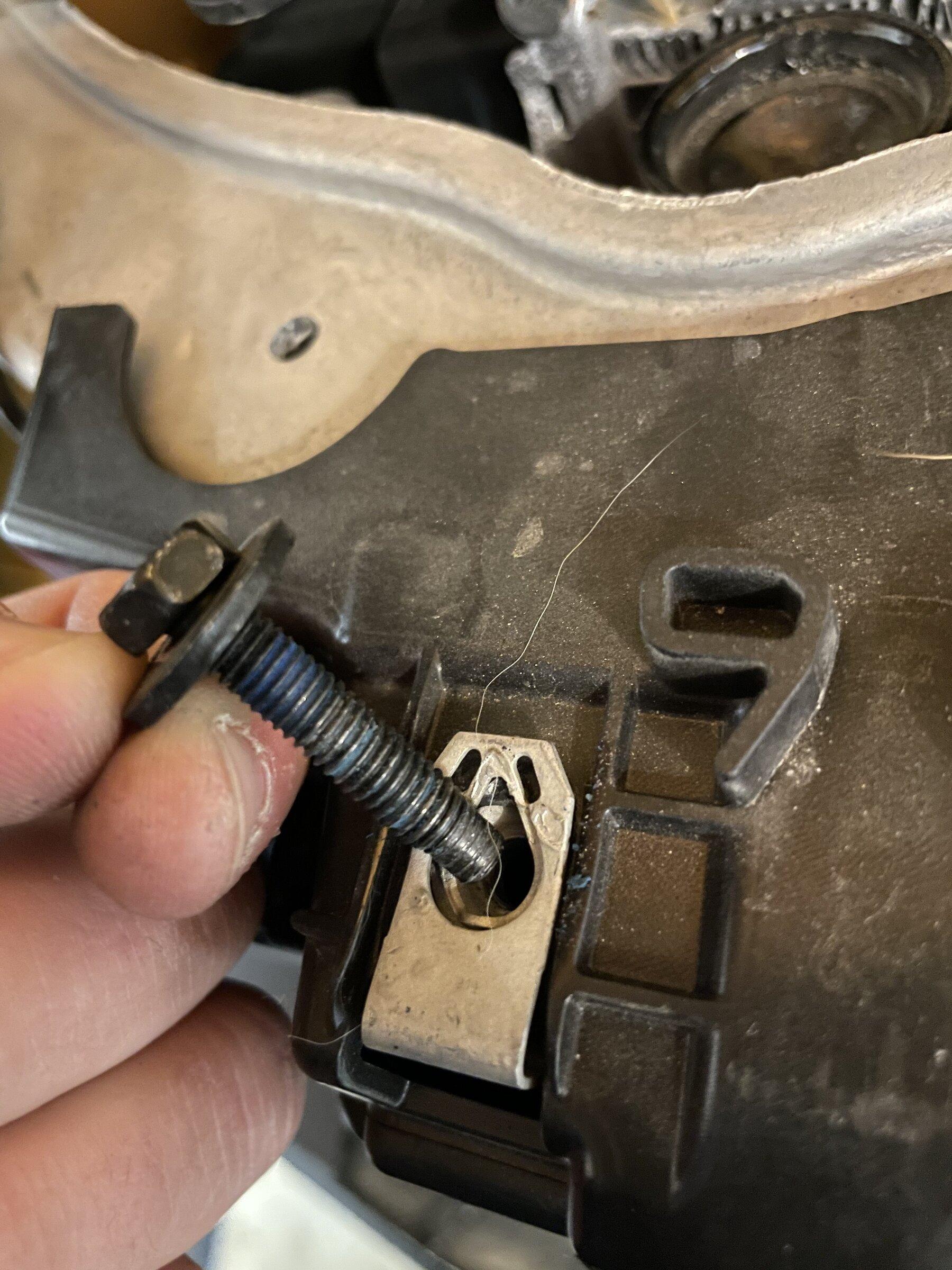

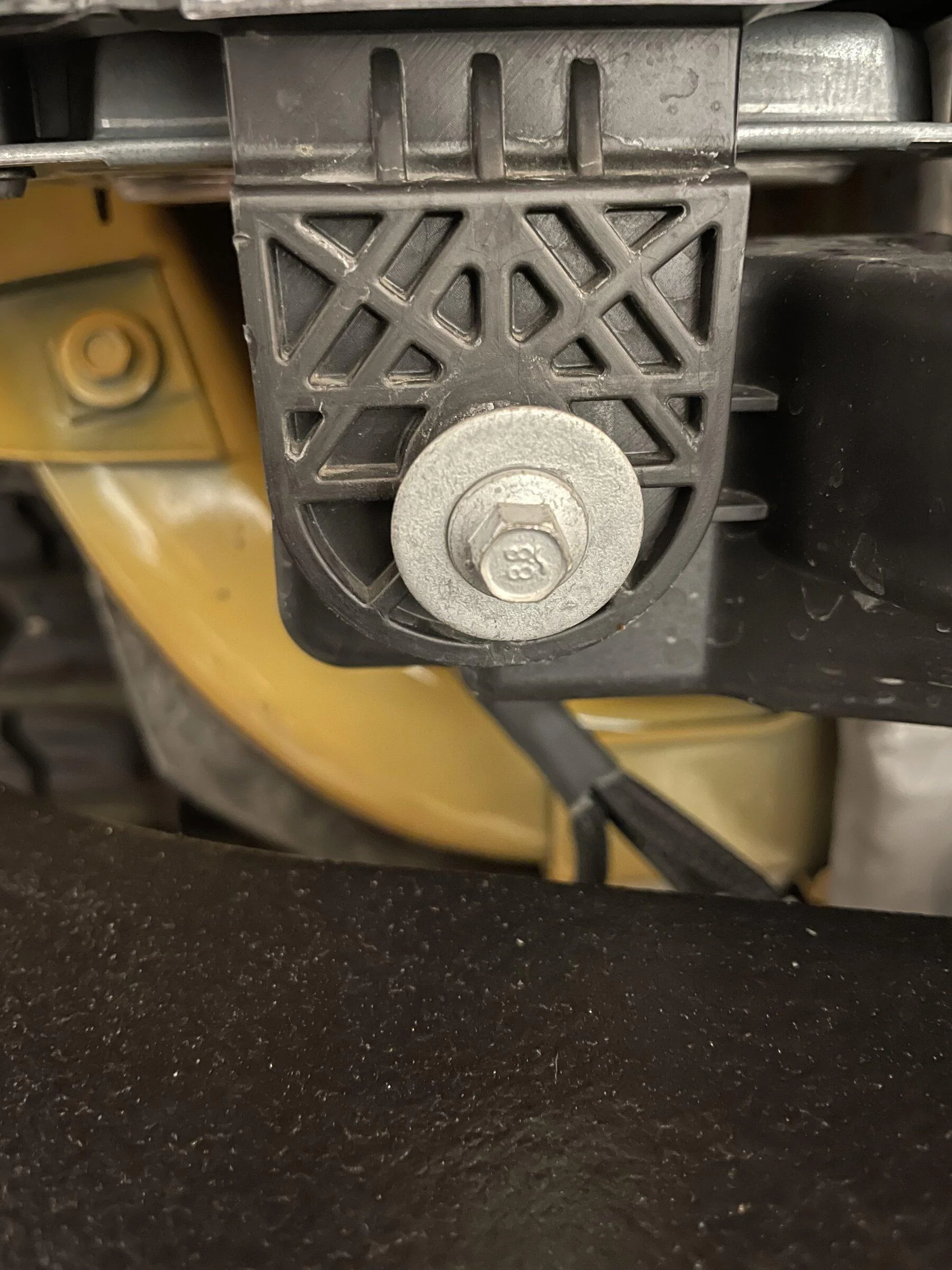

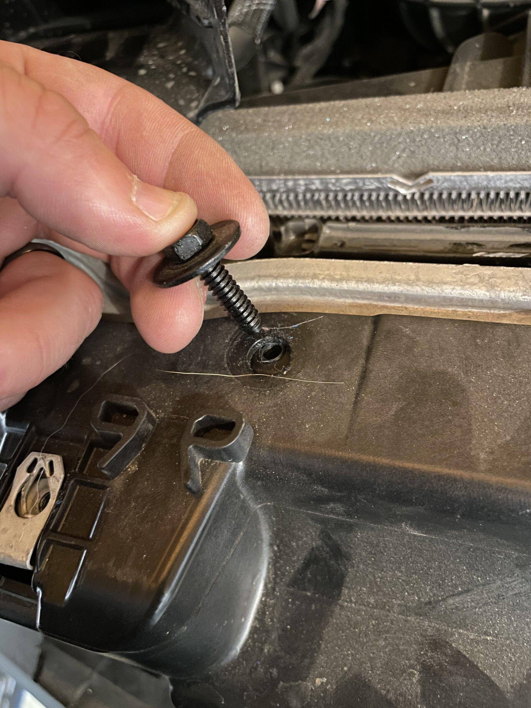

If you took the front end off and you're wondering what screws go where now, here are some tips.
The left is for metal, the right is for plastic, don't put the plastic screw in the metal hole or things can get messy.
Ford Bronco Sunny B: Build Tracker IMG_6634
The plastic thread pattern is to hold the radiator shutter to the frame of the car.
Ford Bronco Sunny B: Build Tracker IMG_6636
and the metal with blue 'temporary hold' loc tight.
Ford Bronco Sunny B: Build Tracker IMG_6635

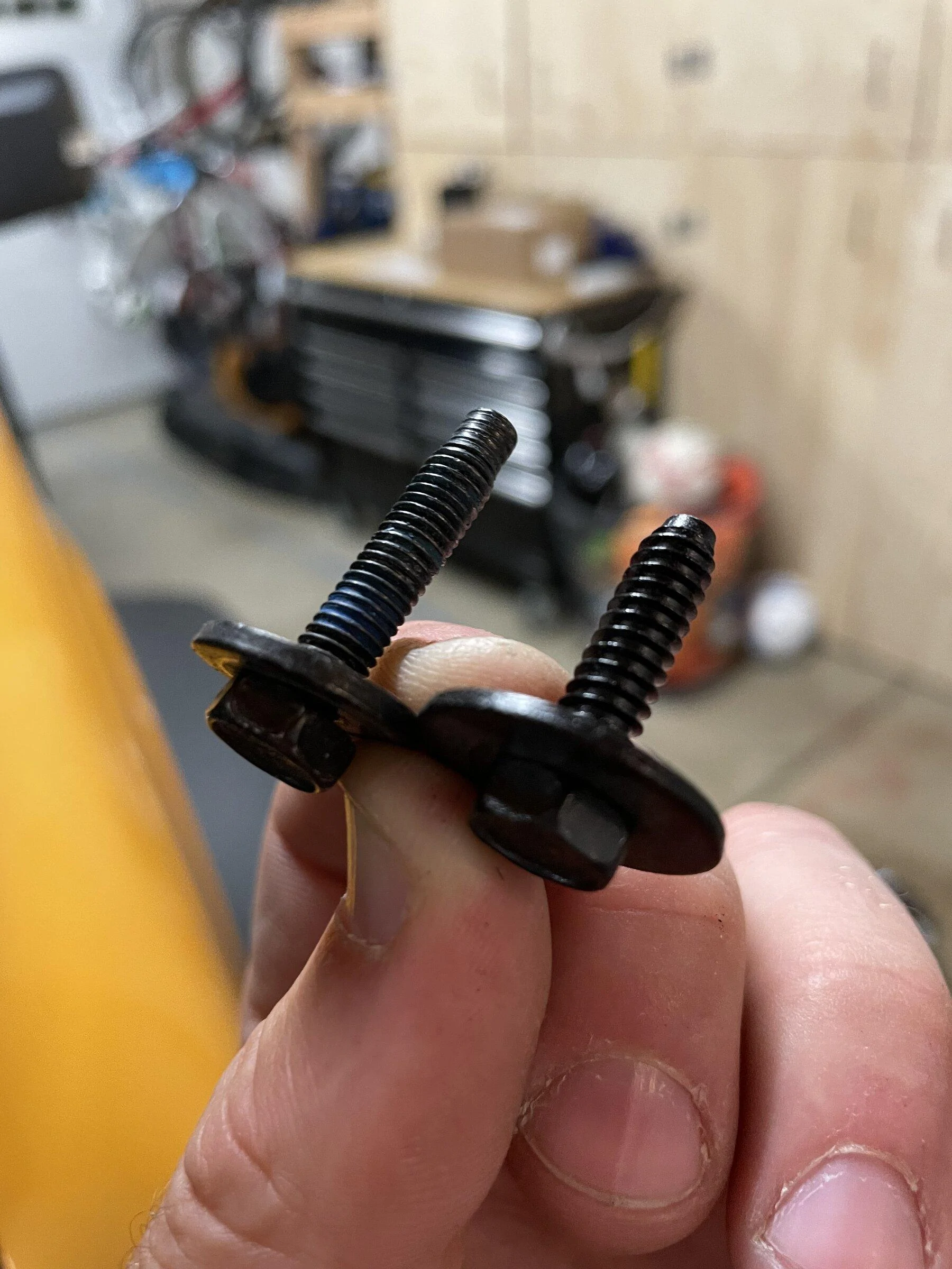

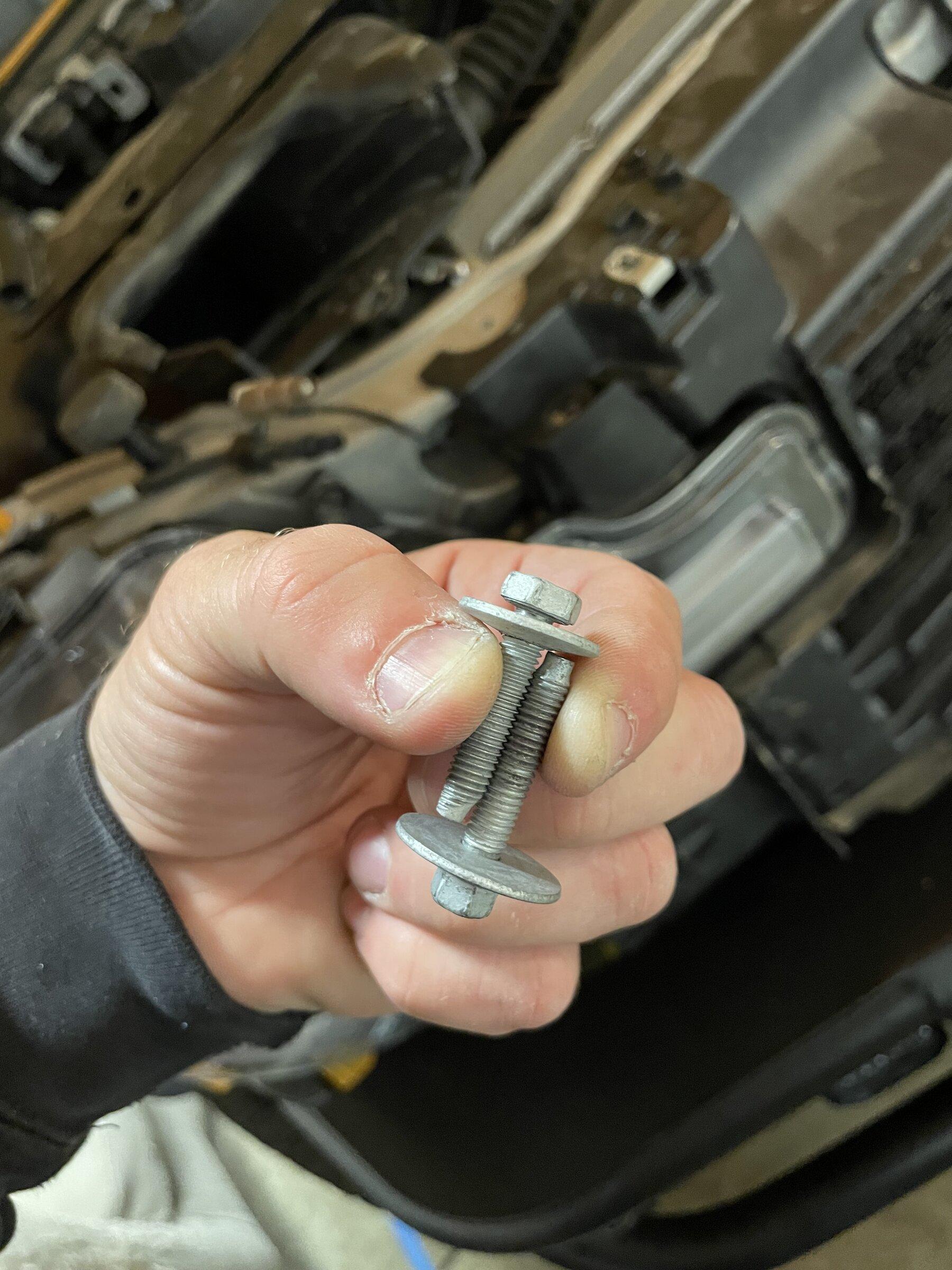

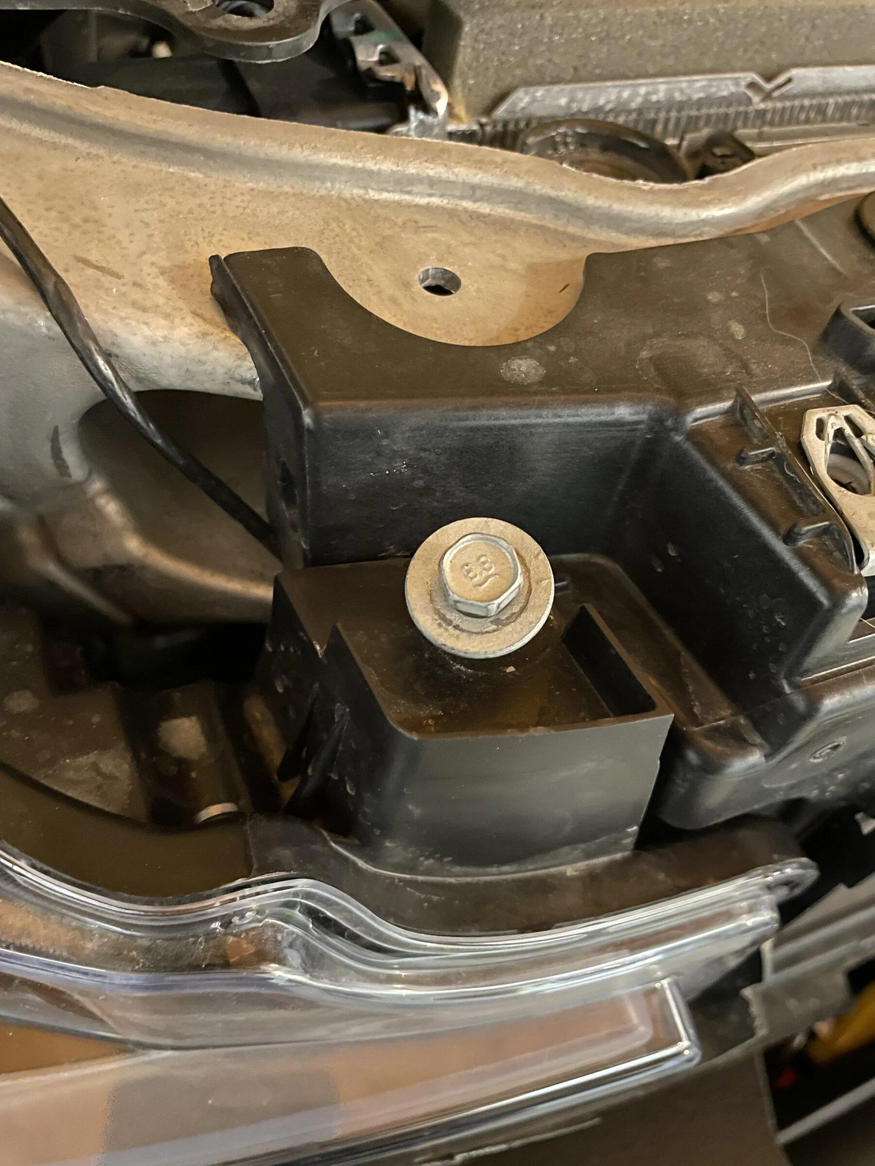

Next are the headlight screws. They're the same thread but the longer one has the 8 mm head, and the shorter one has the 10 mm thread.
Ford Bronco Sunny B: Build Tracker IMG_6637
The 10 mm short bolt goes up top
Ford Bronco Sunny B: Build Tracker IMG_6638
and the 8 mm longer bolt goes on the front.
Ford Bronco Sunny B: Build Tracker IMG_6639

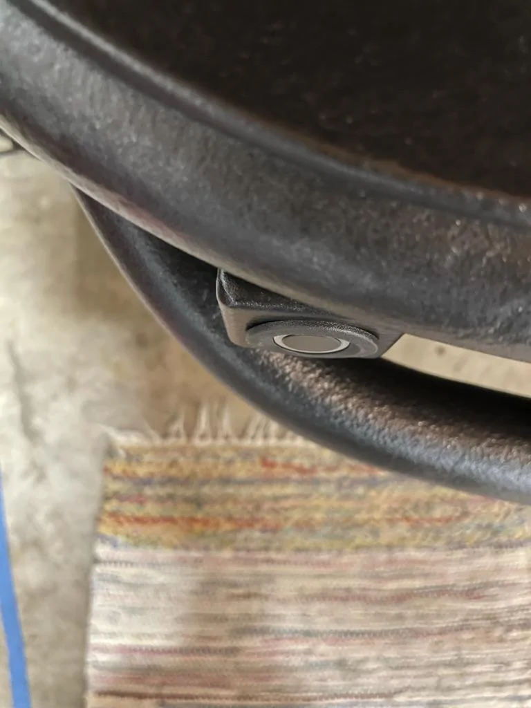

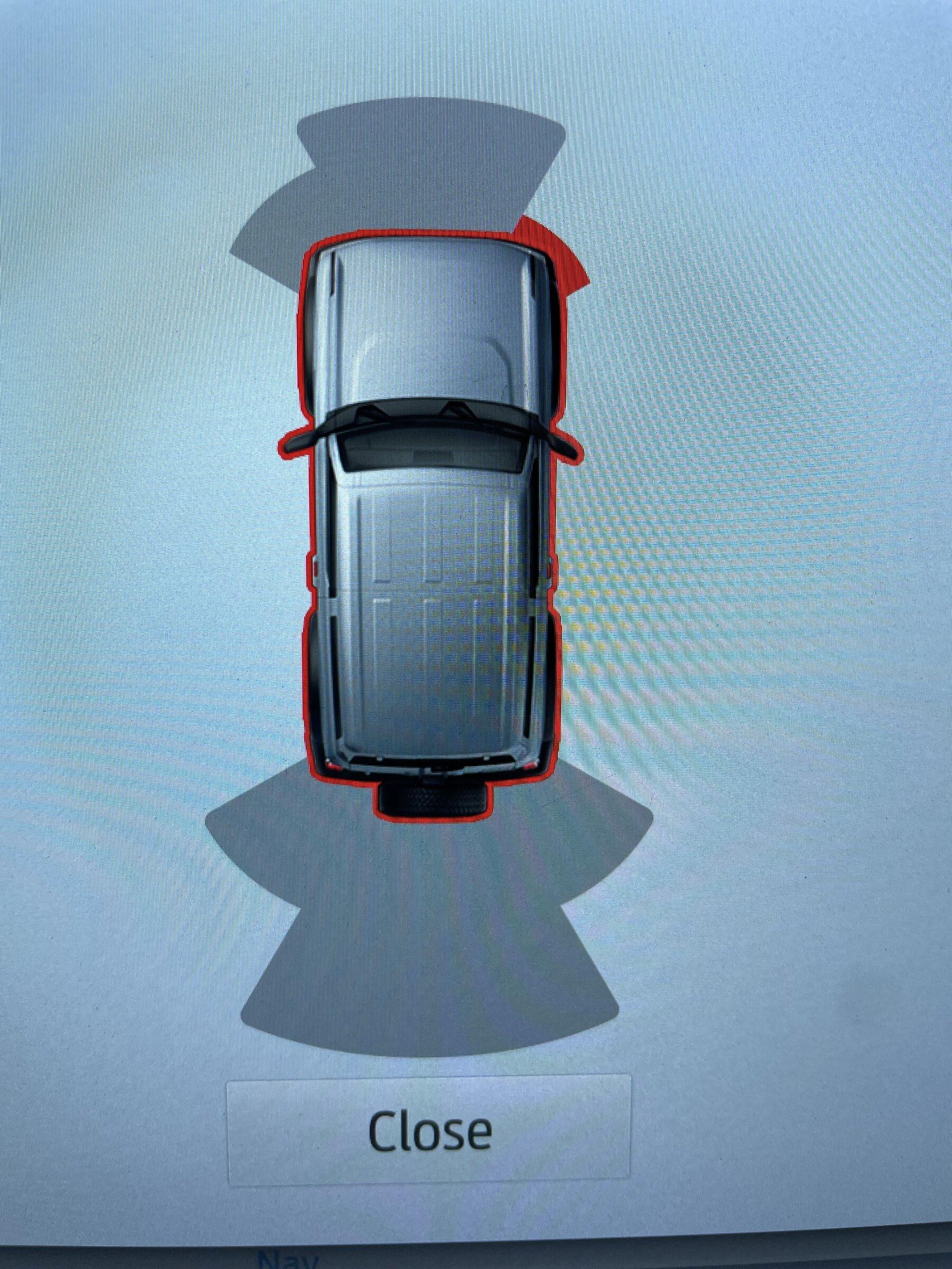

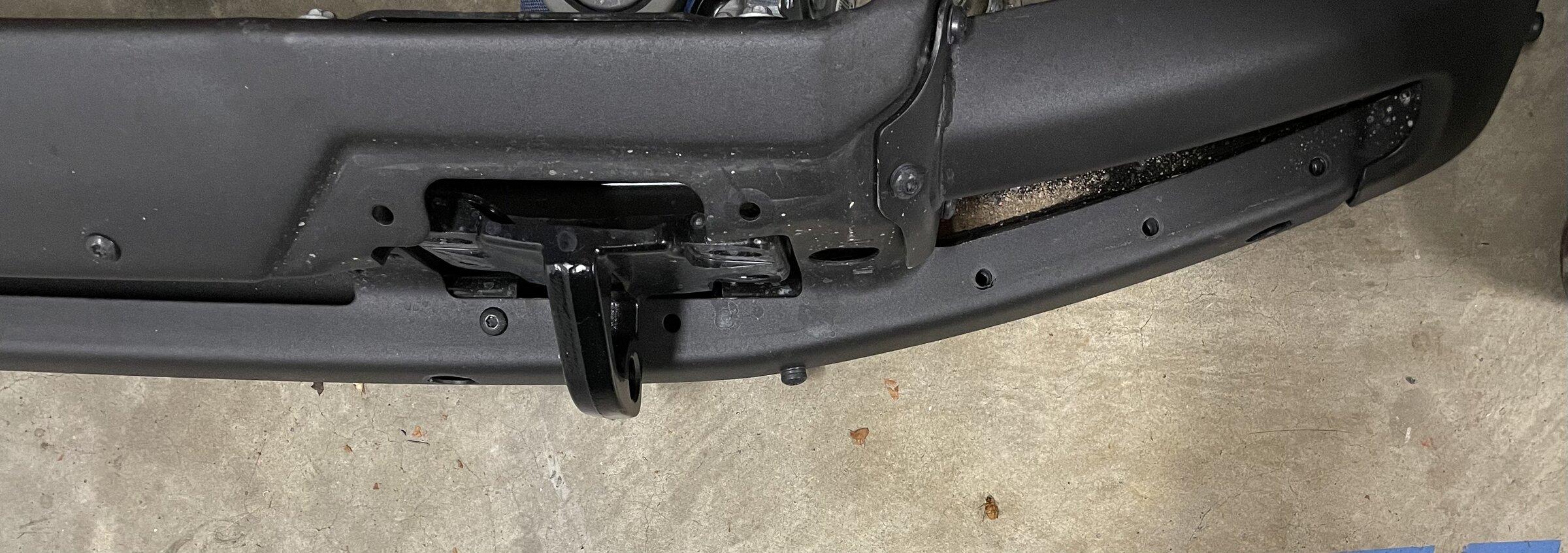

For the parking sensors
- I checked the spare plug, and it indeed was just a spare plug that you can cut off
- I checked the resistance of all the wires to the sensors and they were all good. Note that one of the wire is ~350 ohm to a common wire (probably ground I guess).
- I swapped the sensors to see if the issue stayed or followed the sensor, and actually the problem went away.
The solution was to point the sensors out a bit more. I believe they were seeing the nose of the bumper. Now they've been working well and without issue.
Ford Bronco Sunny B: Build Tracker IMG_6663
Here's the old bumper
Ford Bronco Sunny B: Build Tracker IMG_6657

I got the ACC mounting hardware, it was meant to be included but by mistake left out.
Ford Bronco Sunny B: Build Tracker IMG_6651
I mounted it on the right side since I already had the wire there. Push it back to be flush with the frame, helping to keep it straight and not point to the side. You can adjust the rotation top to bottom.

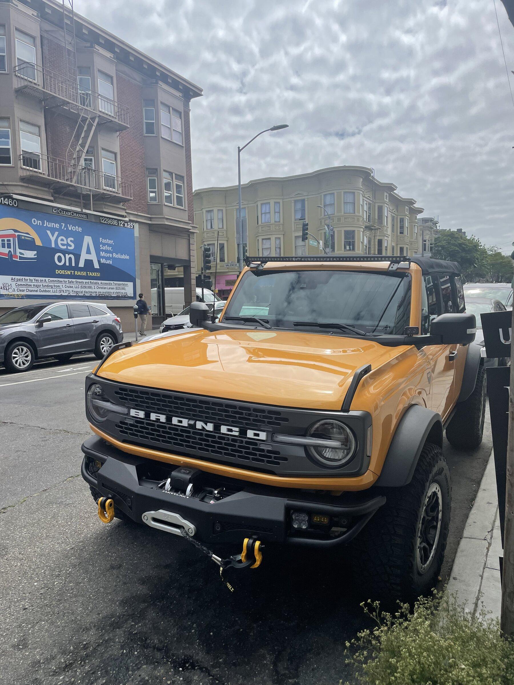

With the new mounting bracket, and the removed shutter blades, the ACC kind of works now.
I took a 10 hr trip before this and didn't have any problems with the ACC at all. I've driven about 5 hrs so far in the last few days and I don't use the ACC much because it keeps doing weird things.
It is annoying that it will randomly say I'm about to hit someone, but otherwise I'm just glad to have everything back tougher. I'll mess with this more next week, doing family stuff all weekend.
Was calling in the mission district today.
Ford Bronco Sunny B: Build Tracker IMG_6824
