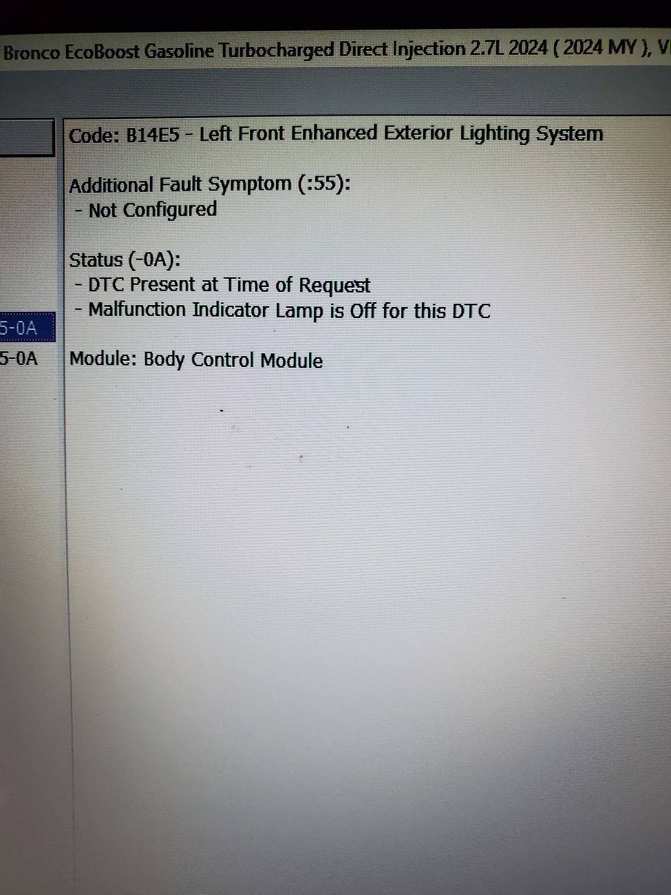

Question for the guys that installed signature headlights, does Forscan show the attached fault code? My research says the only way to get rid of it is with FDRS. The headlight LED modules need to be programmed to the bcm.
