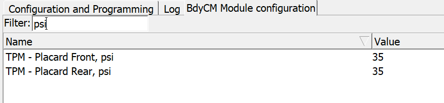

I know I’m old (63) but I’m in the habit of looking at the tire Squash every time I walk out to my trucks, if the tire looks low I check it, fill it and look for anything potentially in the tire, so TPS not needed…. Since I off-road in my F350 as well as my bronco i lowered the TPS warning light and beeper to 20 psi in my F350 (using FORScan). If I could turn it off or lower the TPS light to 15 PSI in my Bronco I would be happy…. and that looks doable in FORScan.
Brian_B
Sep 14, 2023
65
8,886
15,833
Central CA
I did just that with mine - set at 15. Light doesn't go off until around 12 or so? So I can still see if I get a flat, but my typical off road pressure at 15 doesn't set off the light.
