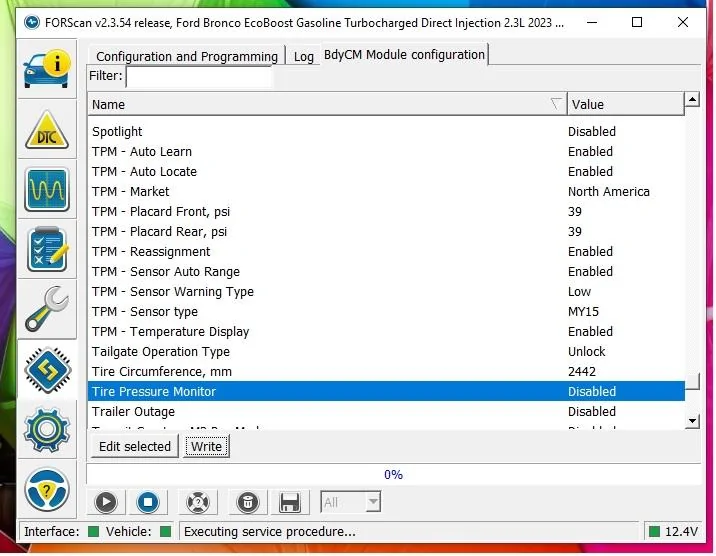

Has anyone figured anything on disabling the tpms with FORScan?

It's easy to do, it's in the BCM module. You just need to look.
figured It out I think. So this should not set off any lights or warnings if I have wheels with standard non tpms valve stems, correct?
thanks for the help. I’m just learning the FORScan

Have you or anyone else in this thread re-enabled TPMS after disabling? I disabled mine since I didnt have time to take my old wheelset to a shop before setting up and testing the new ones. I left it disabled for about 10 months and just did a teardown during my tire rotation to put TPMS back in and re-enable. After enabling, I got nothing... just a TPMS fault and no values for any tire. Install was easy, not sure what I could have messed up. Maybe I missed another step in forscan

I turned it off for a day just to see what happened. When I checked the tpms on the dash display and in ford pass, I just had dashes with no numbers. I reactivated it and it displayed everything ok.
I was just getting prepared to do this with my new wheels and was contemplating using regular valve stems Vs tpms sensors.

I hope this works. I just installed some 37's on my Battle Born Wheels yesterday. I had bought 5 sensors from Tire Rack that I thought were factory Ford, but they came loose in a bag. The first one I pulled through the wheel and right before it seated the brass threaded end snapped off. I ended up just putting rubber valve stems in all five wheels as I didn't want to break more sensors.

Thanks, mine came back eventually. I didnt need to go to a dealer or anything, I think just just needed some miles after reactivating the DID to wake up and start reporting correctly.
