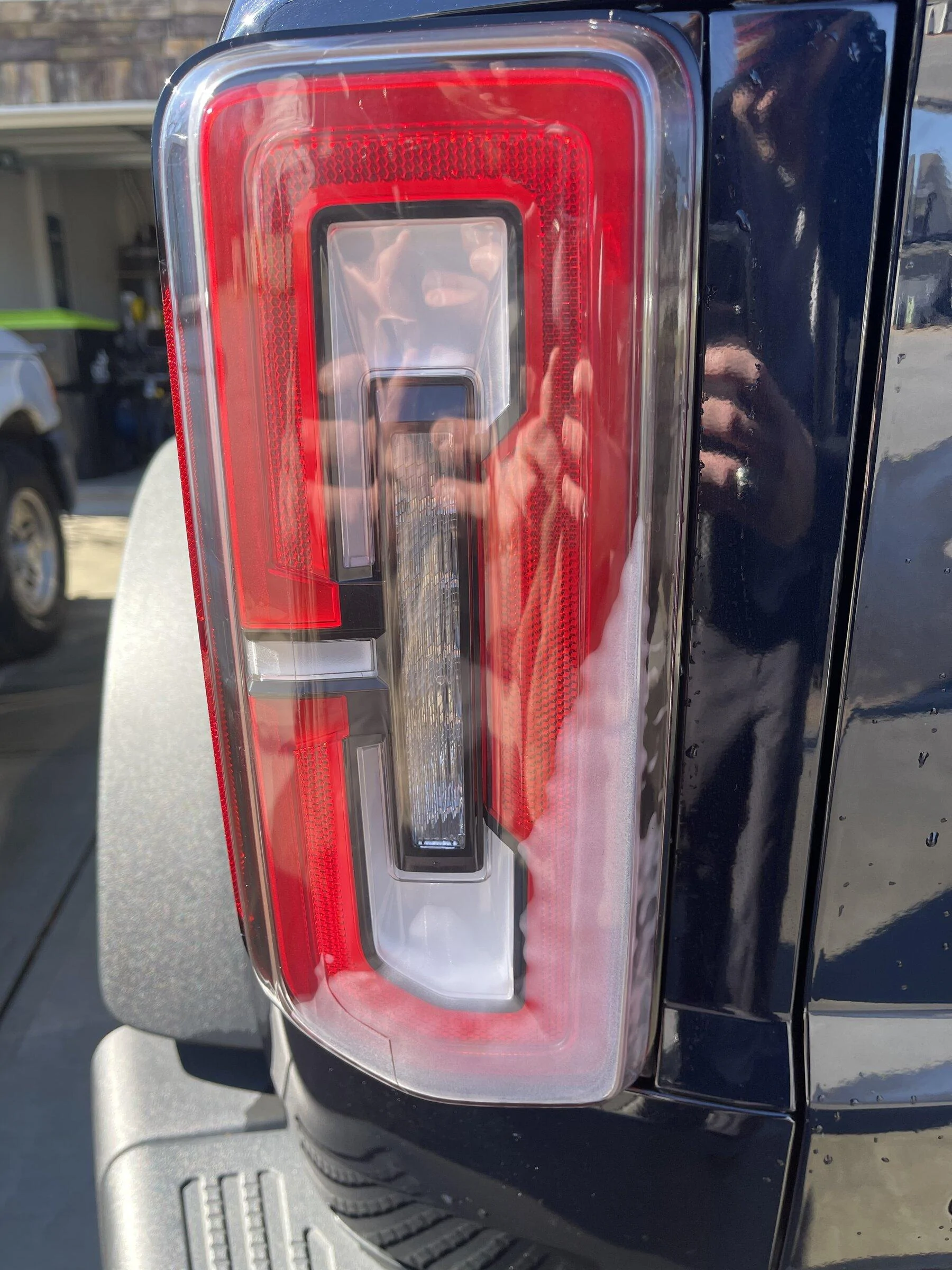

Anyone else have taillight condensation? Is it just something you have to live with? No big deal, just wondering. Here’s mine. You can see condensation in the bottom, right corner.

I rememeber reading that is to be expected. I don't remember where I saw it, but i'm sure I did.

I noticed a bit in my LR the other day. It is normal. Will come and go as the lamp assemblies are vented to atmosphere not sealed.

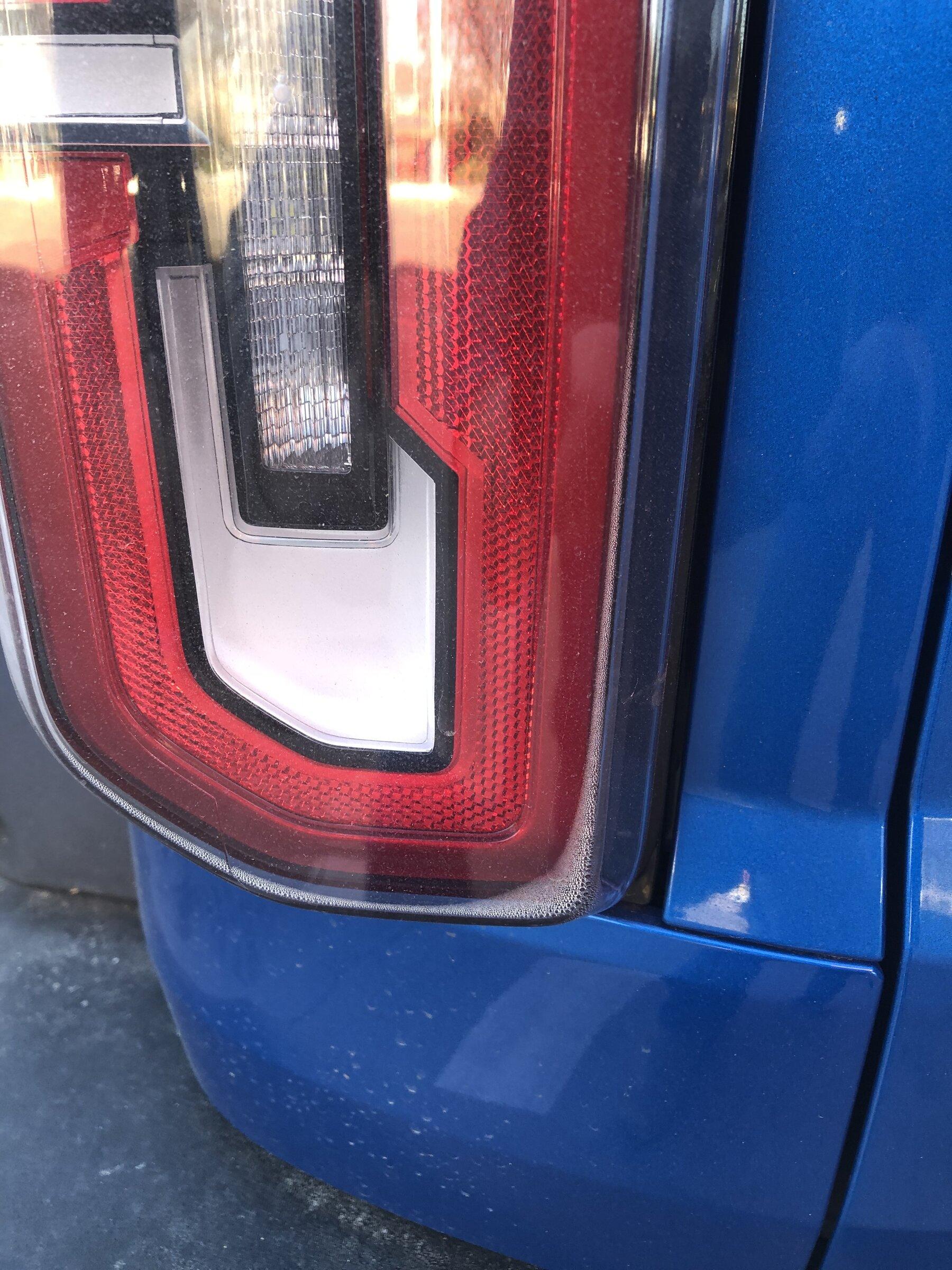

Had this issue today. How long does it usually take to go away on its own?

Jacob it is normal, check out page 94 of the manual. Up to 50% of the light being covered in fine condensation is normal. It says usually up to 48 hours before it clears is also normal. No I am not anal, why would you ask that? Doesn't everyone read the 562 page owners manual?

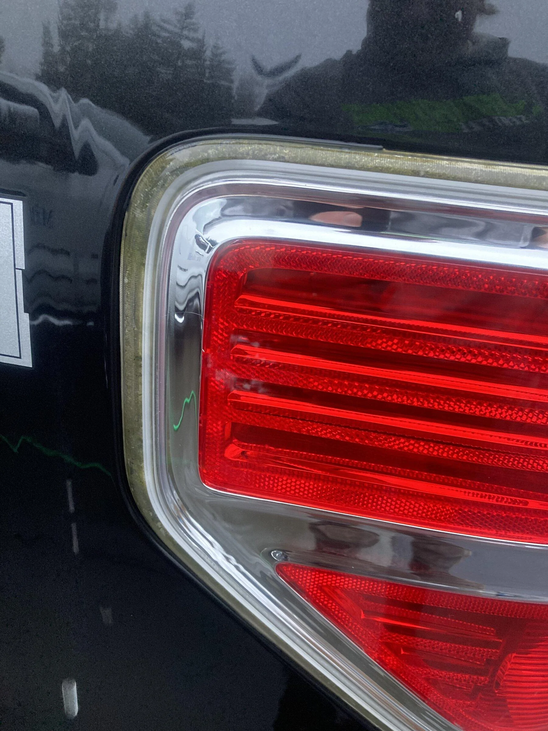

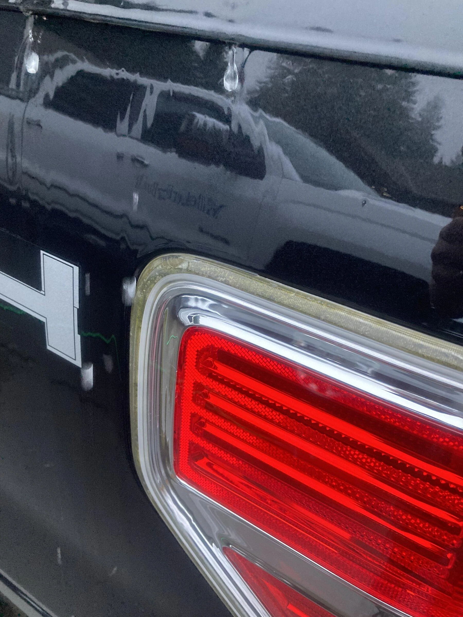

Here is pictures from my f150 taillights today. The condensation has turned into green mold and mildew. And not any of my other trucks or vehicles have done this. Just Ford.

you should pull the light assembly and see if it is just around the outside of the housing? Might be able to clean it up.
