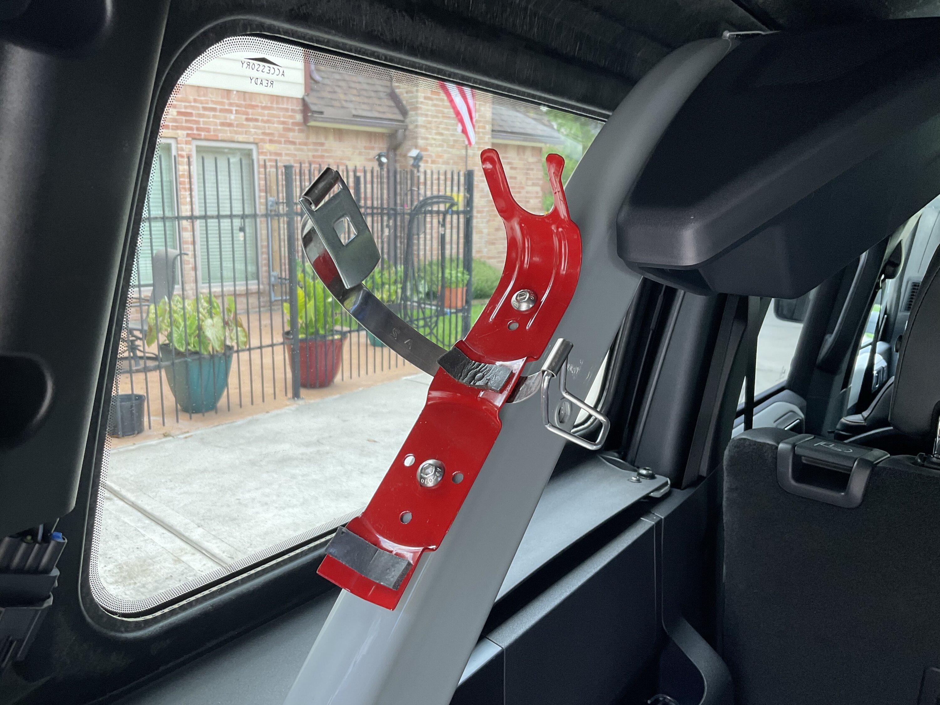

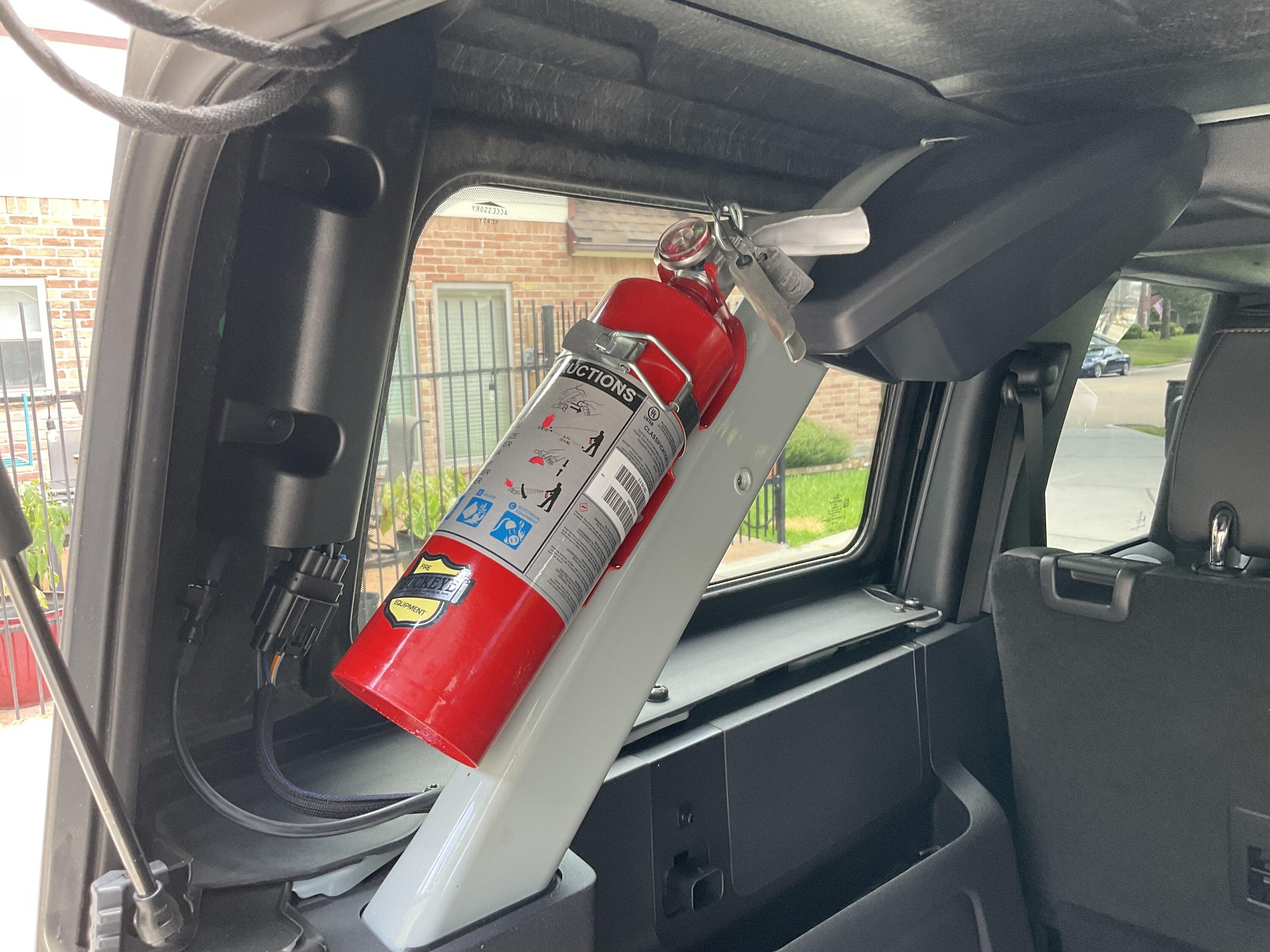

Also, what're yall bolting to the cage back there? Anything cool?
Share those ideas.

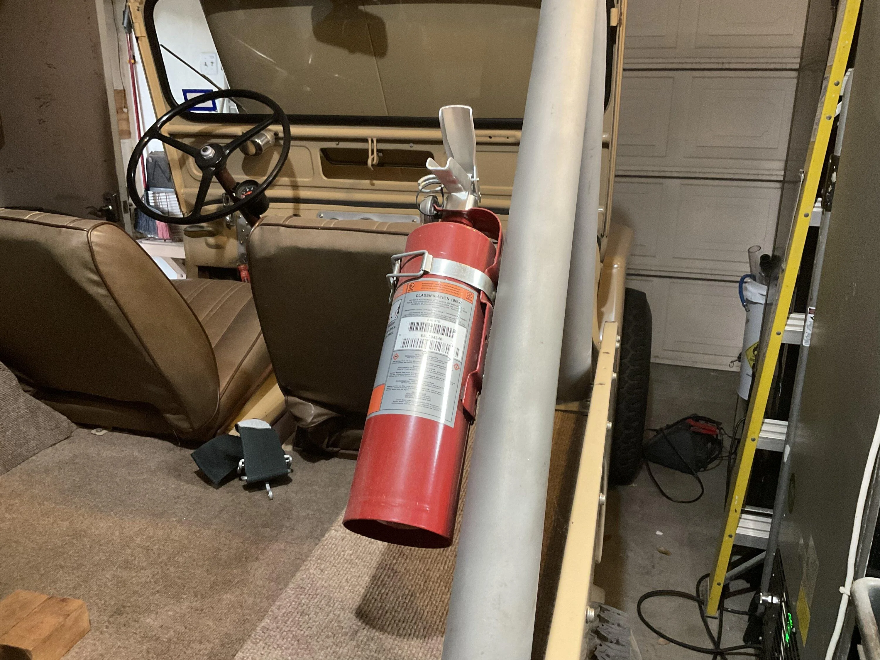

Dig the idea. I would add a couple Velcro straps though. That will vibrate loose eventually.
Though I don’t get off the road much in it anymore, the one I have mounted on the 50‘ Willys, on its side, has held up for many, many, many, many years. The Willys stiff suspension (or lack of it) and the concrete streets here in Houston pound the crap out of it!
