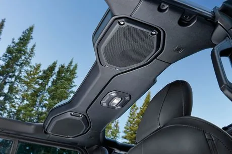

I doubt the change to a lumpy cage was for crash protection. Masses being equal, it's hard to beat a circle for strength.
NVH or the cost of packaging accessories would be my guess. With customer expectations going up, the number of layers or bulk of the NVH management materials could have demanded more surface area for support -- or perhaps the volume of electronics being incorporated into the cage meant more volume/surface was desirable to hide/protect it when the top was off.
