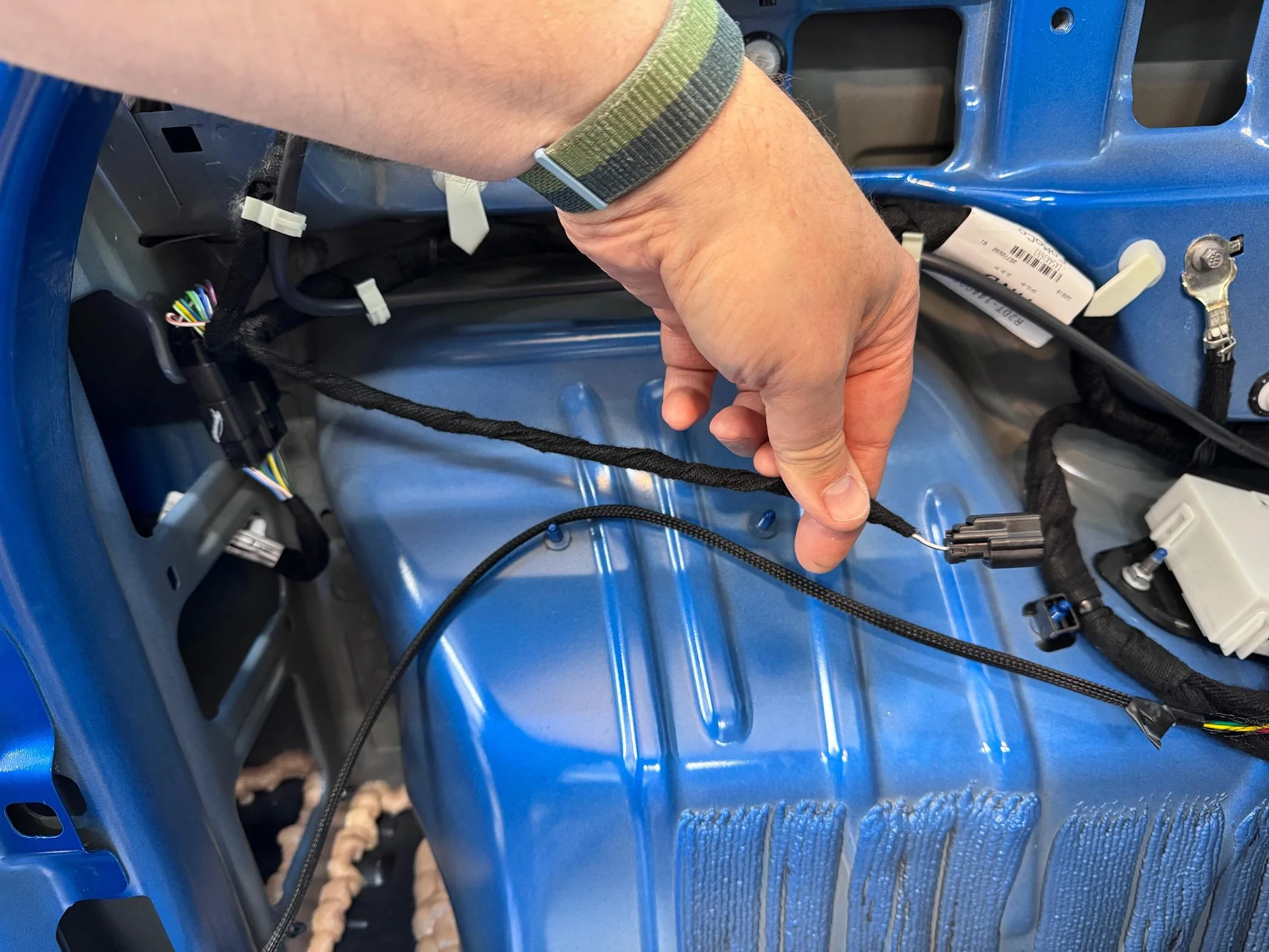

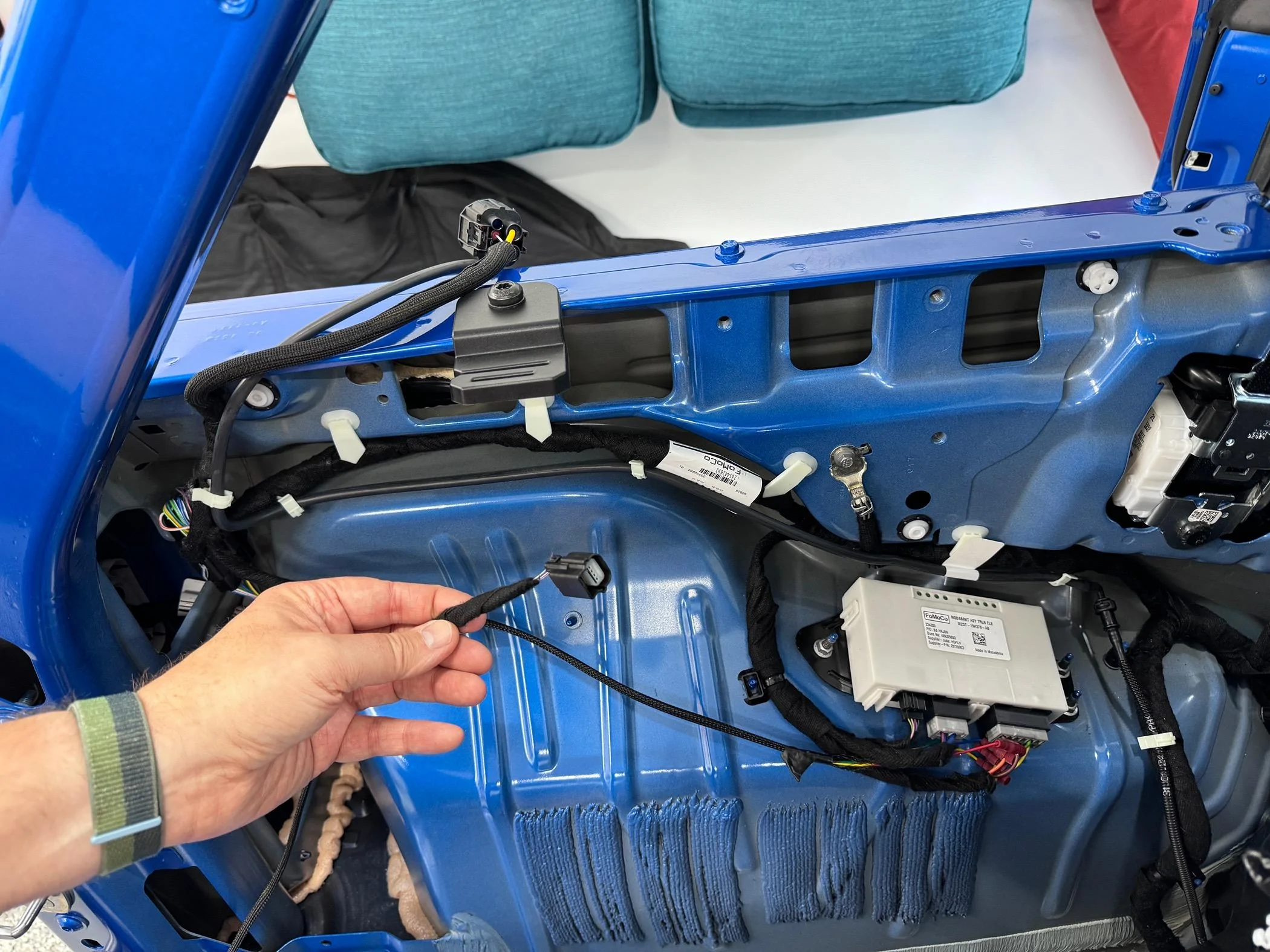

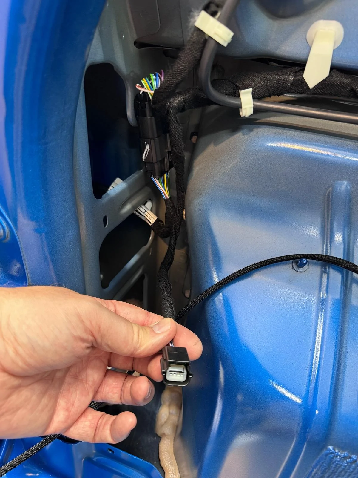

I have a 24 wildtrak lux and I am putting in a third break light in the spare wheel. So I’ve done all the stuff to the tow box on the drivers fender and starting to put everything together but now I have this extra connection. What is it? Where is it go? It doesn’t reach the fender tow box and I can’t see an empty slot near the tail light. Help

I don't recall if the driver side rear trim has this but check the removed trim panel for a PATS antenna connector.

Trying to remember if there is an antenna attached to the panel that that goes to. Been a minute since I had mine apart.

Awesome. That was it!

It’s weird because I didn’t remove that plug so I wonder if it was loose is that for the Key fob door handle?
There are several of these antennas in the vehicle in different locations. PATS utilizes these including the FOB.

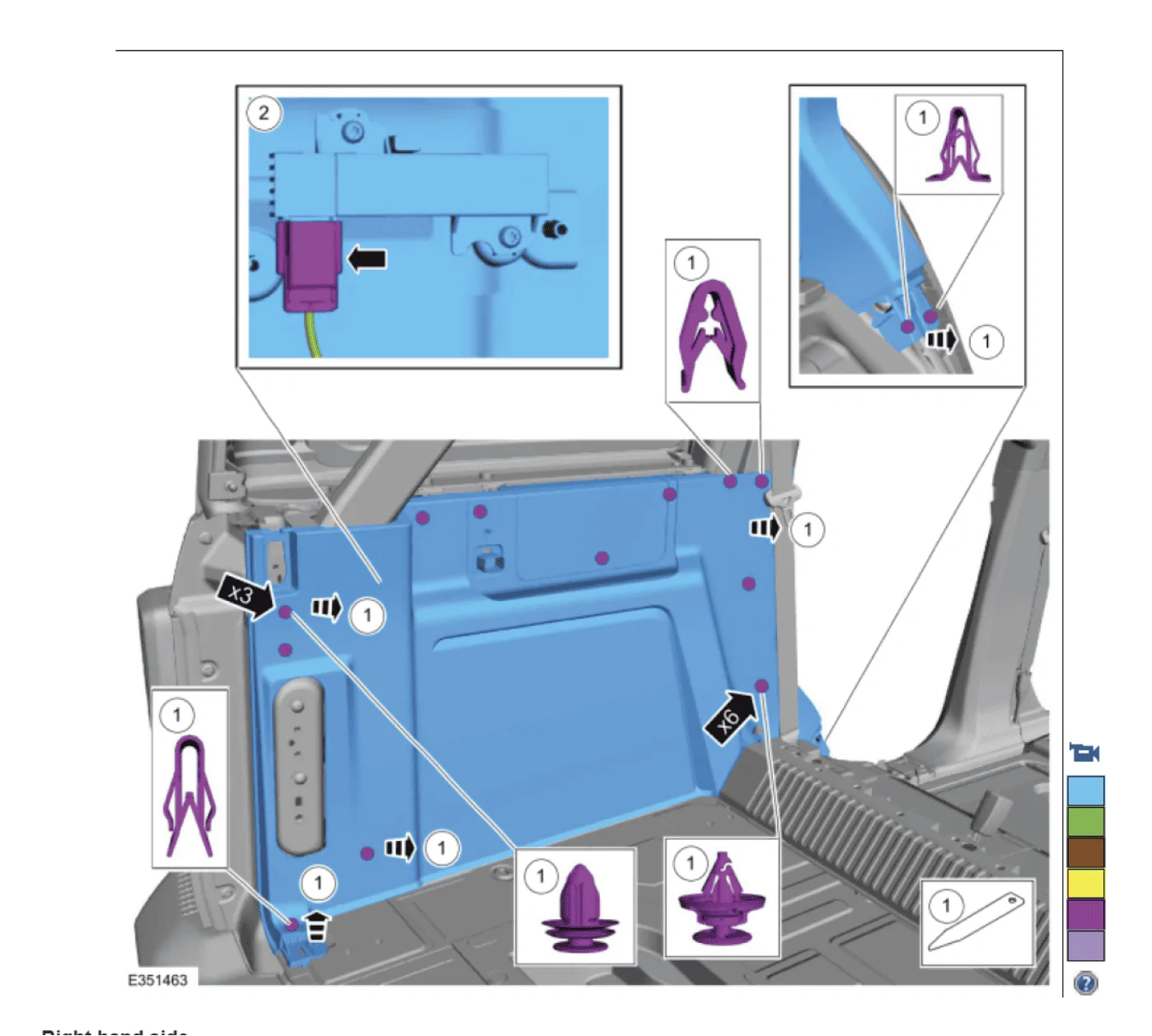

Where can I find illustrations like this?
They're indispensable for the DIY folk. These are part of the service manual (workshop manual). It can be purchased stand-alone or temporary on-line access can be purchased. 72 hour access is ~$30.
