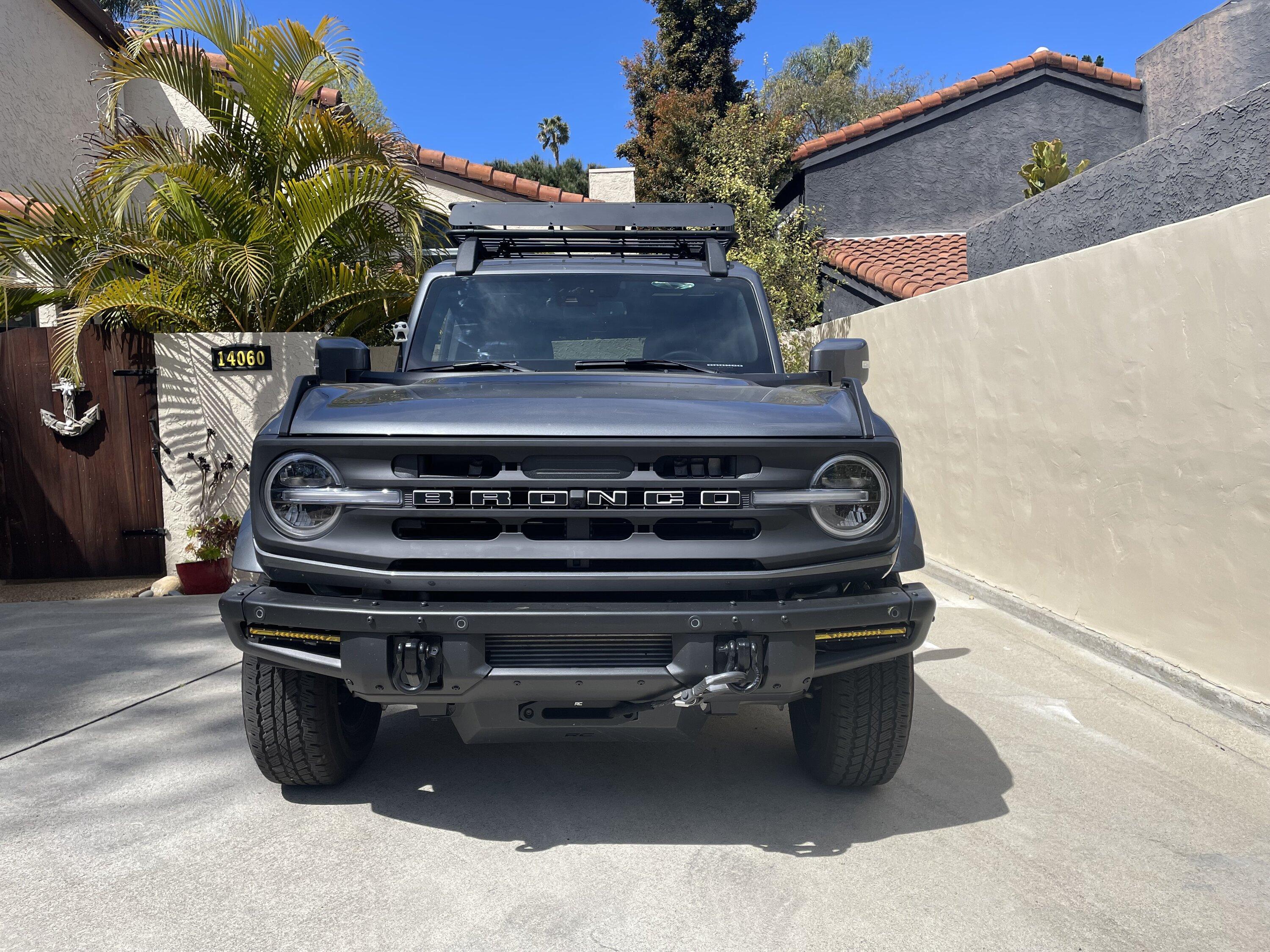

Here is an example Rough Country Hidden Winch with a Whipple IC
Where did you put your heat exchanger? And did you have to shorten your lines to it/cut off the brackets on one side? And you do not have shutters for your OEM cooler, correct? I am stuck with the motor/shutters and associated wires that I imagine would throw a code if I messed with them. I am leaning towards the Rock Hard bumper which, although not as appealing as the setup you have, provides great approach angle and retains ACC/IC/proximity sensor locations. How do you reach your spool level?

The installation documentation covers all of the modifications required. With the installation of the Whipple IC the shutters were removed. My bronco doesn’t have adaptive control, yet it still had the plastic assembly in front of the IC, which I took out to further increase airflow.
For the Engage/Release lever access, that is one of the major deficiencies in the RC design, but I developed and easy solution which is documented in this forum.
the shutter motor itself is still connected, but pulled the wiring harness and motor back into the engine compartment and tie wrapped out of the way. Still looking at a way to bypass the need for the motor to be connected and not cause an error.

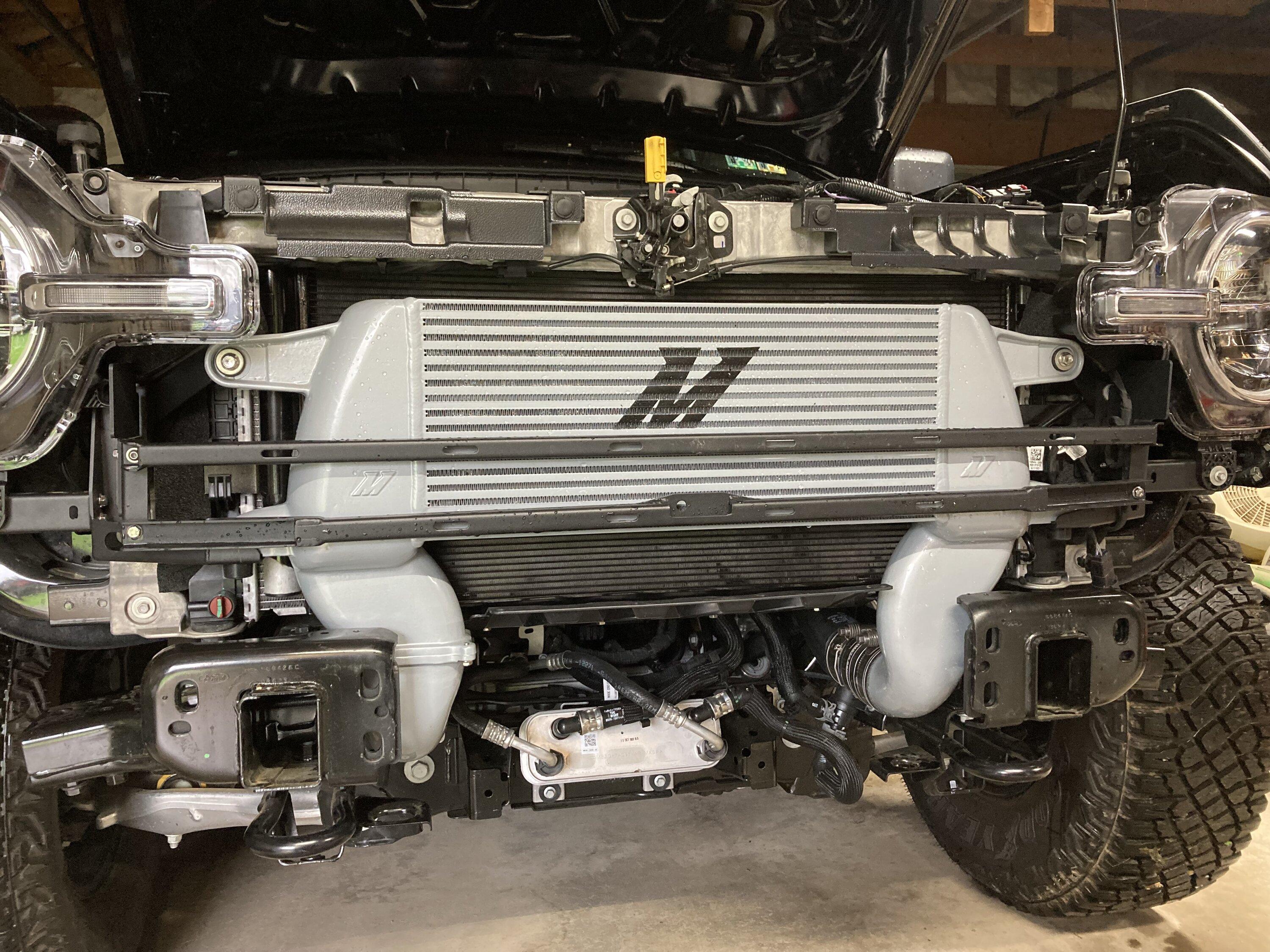

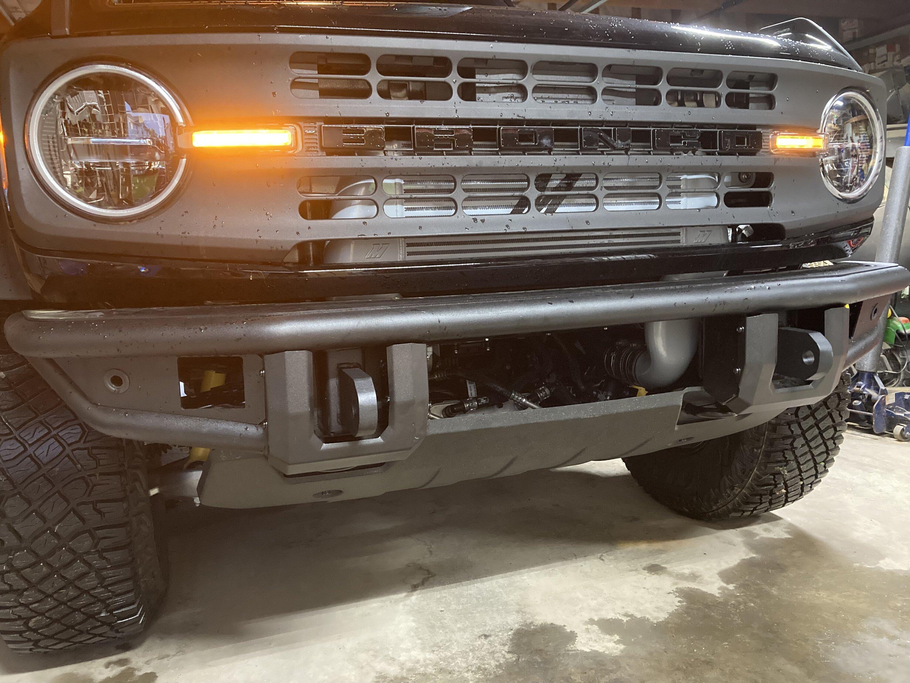

Pretty much any winch that isn't mounted like the Everglades winch, block what Ford says "Do not block".
Very true, unless you get this………

And yes I get the whole block the radiator thing but you have to remember also that if you block the intercooler the ECM will detune the Bronc if the inlet temps rise. Blocking the intercooler will make the intake temps rise. It is a catch 22 scenario. I chose to go with the more power idea. Since installing the IC I have not seen elevated coolant temps but I do not live in AZ. I live in PA and this year has been a weird one. Not as hot as usual. It has been humid and in the upper 80's all summer though.
