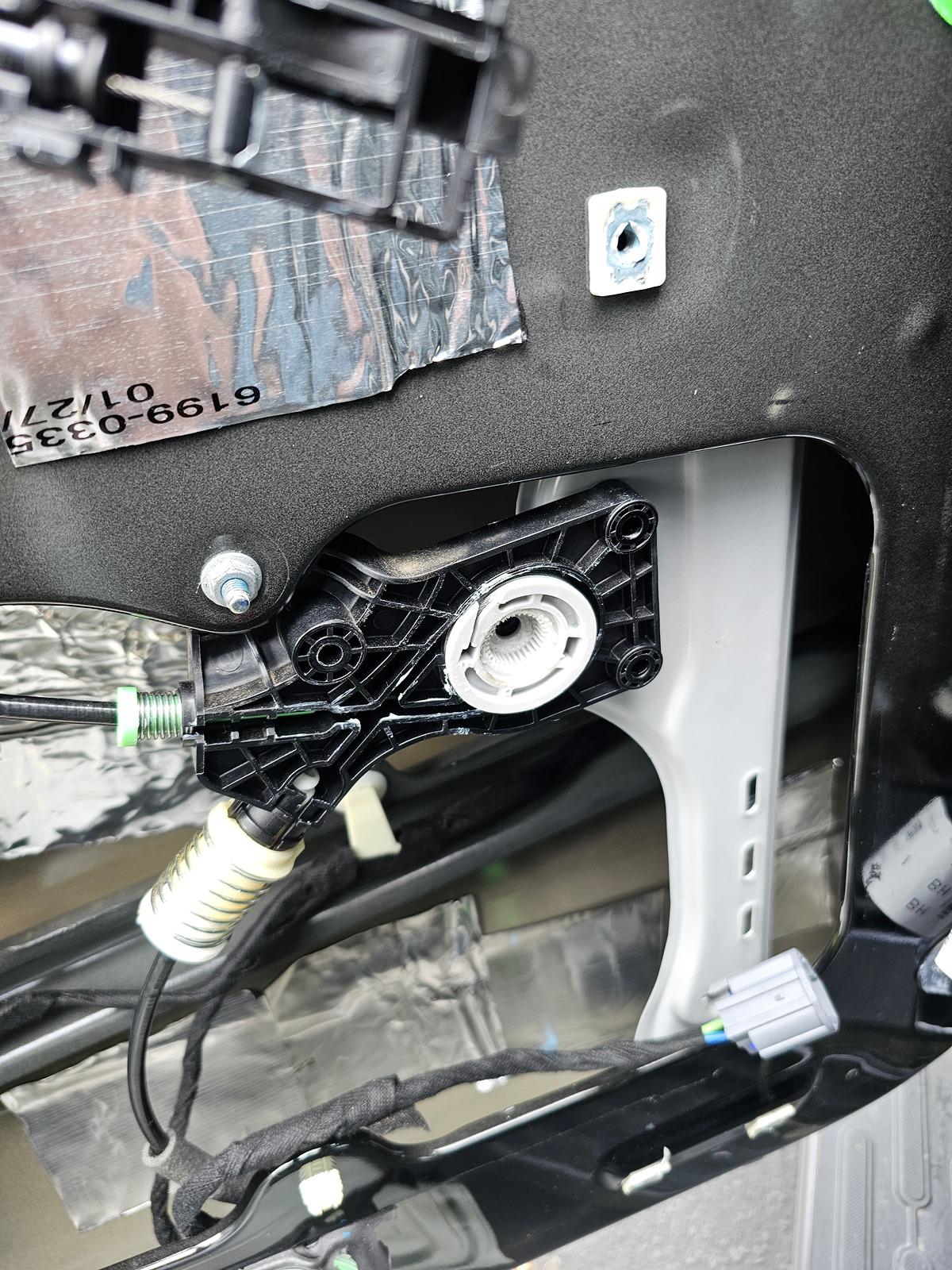

If anyone ever has this same issue, I was able to manually lower/raise the window by doing the following:
  1. Remove the door panel cover
  2. Remove the water shield (gasket is reusable)
  3. Remove the 3 screws holding the window motor to the piece with the cables running through them
  4. Pull the motor away from the winding gear mechanism that has the cables around it
  5. Lift/lower the window to the optimal position
  6. Place the motor back in place to hold the gears in their position
  7. Tighten everything back up and secure in place
Just finished doing this to lower my window a bit until the new motor comes in
