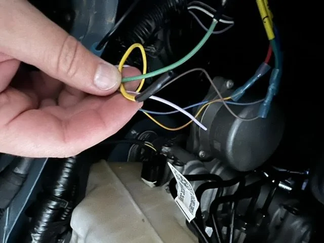

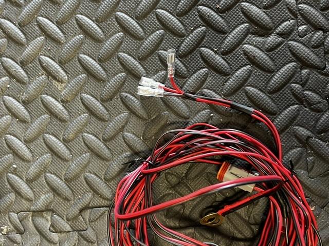

Can someone give me some direction on how to connect this wiring harness to an open aux switch cable? TIA!

You don’t need most of that wiring mess, just the plug and a few feet of the wire. Snip the rest off, wire the red to the aux wire and the black to ground.
