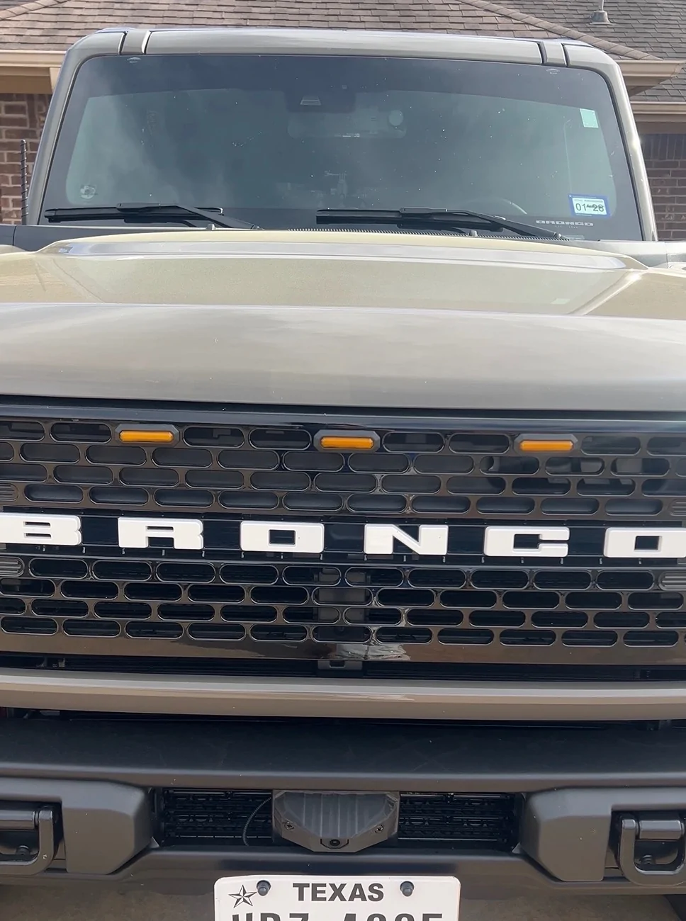

Got mine "for Xmas", mounting the front cam per the pic. It does stick out a bit, but you can angle it down for off-road, then back to horizontal for street driving. Ive got blue loctitie on the screws and shrink wrap on the connector.

Grill is definitely the cleanest look and like Wolfbox mentioned you do get some adjustment using the screen to get a better downward angle. I have mine mounted to my winch plate so can’t comment on the grill location from first hand experience. But seen plenty of people on here who have done it that way.
