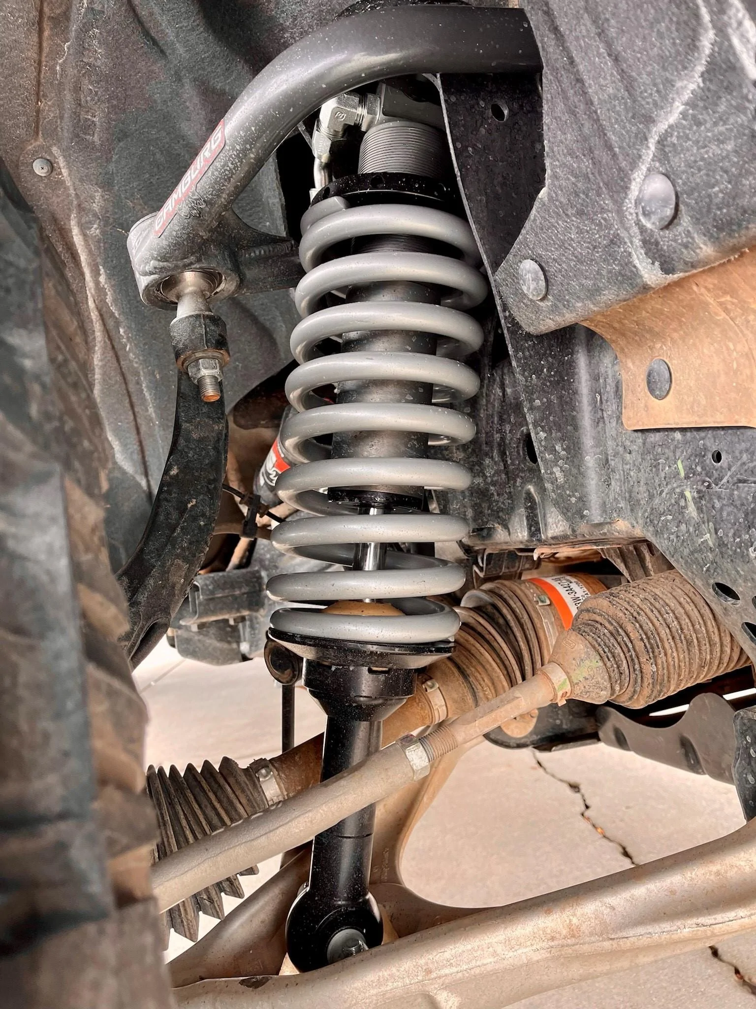

Hello Everyone! If you are thinking of picking up some new shocks and are considering going with Fox I would think again before you buy! For a little background I have a 2021 Bronco Badlands and have had it since August of 2021. When I purchased my bronco the first thing I wanted to do was put a lift on and bigger tires for off-roading. Around November of 2021 I got the opportunity of purchasing a set of Fox 2.5 Performance coilovers that everyone has been waiting forever for. At first I was in love and didn't know any different with how shocks worked or the performance involved. I was always told Fox and King are the best so go with them.
Well over the last year or so I have been riding on those fox coilovers and let me tell you, DONT WASTE YOUR TIME OR MONEY ON FOX! I know that may be a hot take but the fox coilovers have been nothing but terrible to ride on on road and off road. They are not smooth, they are noisy, they dont adjust very well, and they wore out extremely fast. Don't get me wrong i'm not trying to hate on fox and what they do, but the product they made for the bronco is not what I had expected. I was always told they make top of the line stuff but I was sure wrong.

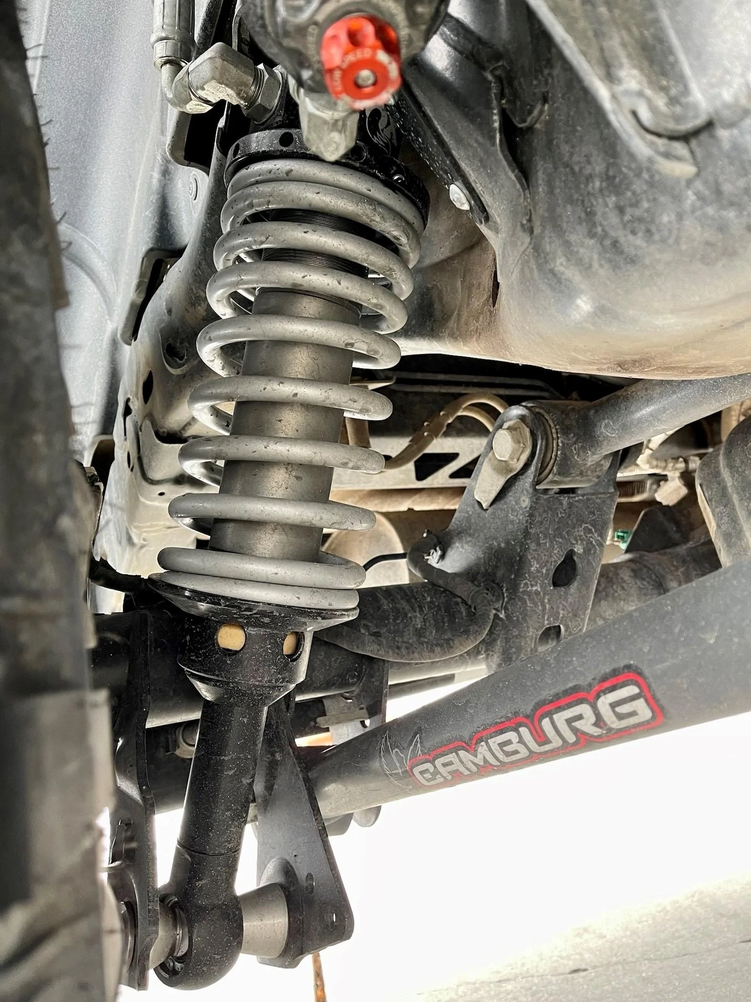

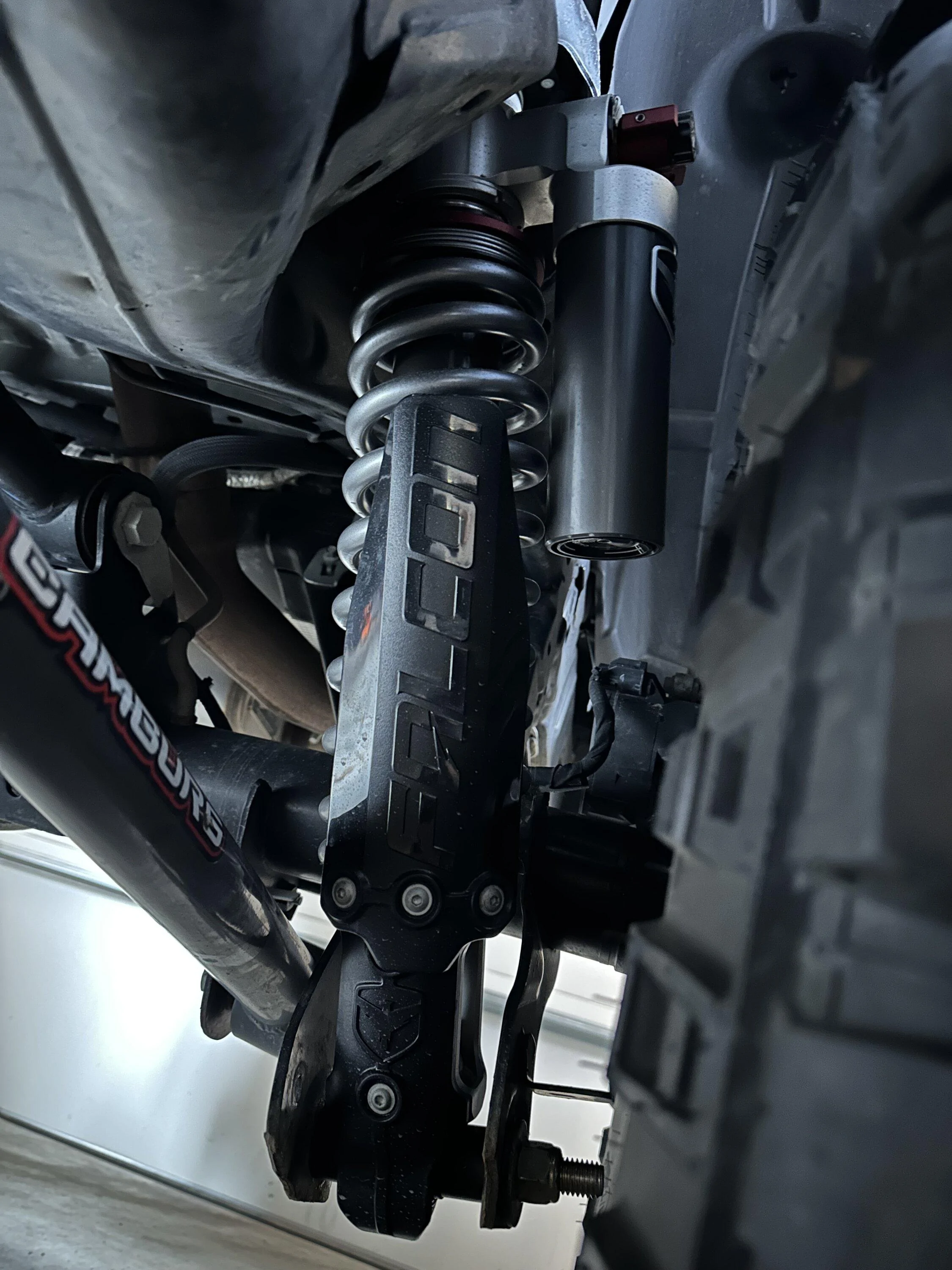

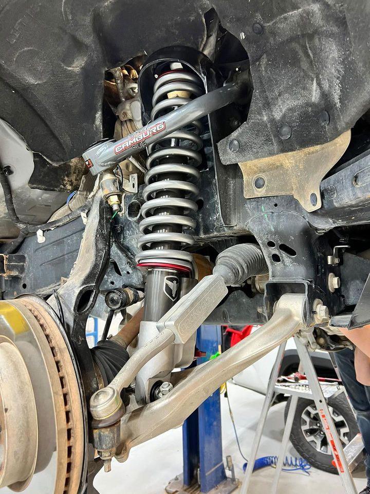

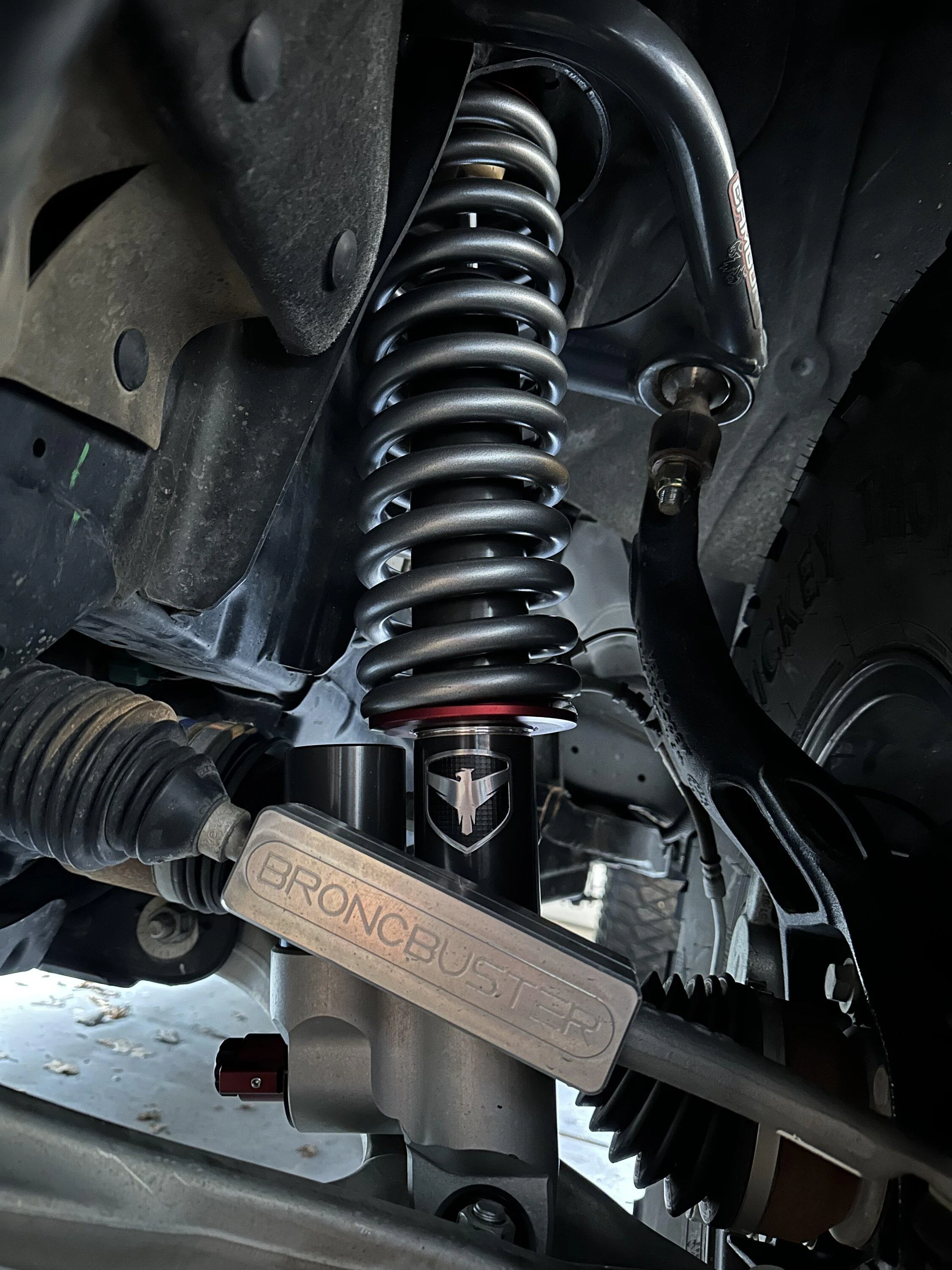

In the pictures below you can see the differences between the fox and falcon kits. You will see the adjusters and how much more travel you have and droop with the falcon kit as it is on the lift. The falcon kit is made by Falcon Shocks and Teraflex suspension. They are local to where I live in Utah and very big in the Jeep world. Anyone who has their kit on a Jeep will tell you they are amazing. I am here to tell you the same. I would consider getting them over any other brand. A full kit from them is way cheaper then going with Fox or King. here's a link to the kit: https://teraflex.com/2021-bronco-3-...h-3-3-falcon-fast-adjust-coilover-shocks.html
Falon makes a fantastic kit and they are way ahead of the game! I haven't had the opportunity to go off-roading very much yet because Utah is still getting tons of snow but I am very excited to go out and test more. I trust the team at Teraflex and Falcon! They will not let you down and they will be there for you no matter what. If you want the most bang for your buck and want the most performance overall I would go with Falcon! If you have questions let me know below!

I got them from RTR. Loren Healey posted on his Instagram story that they were available and I jumped on the opportunity to get them.

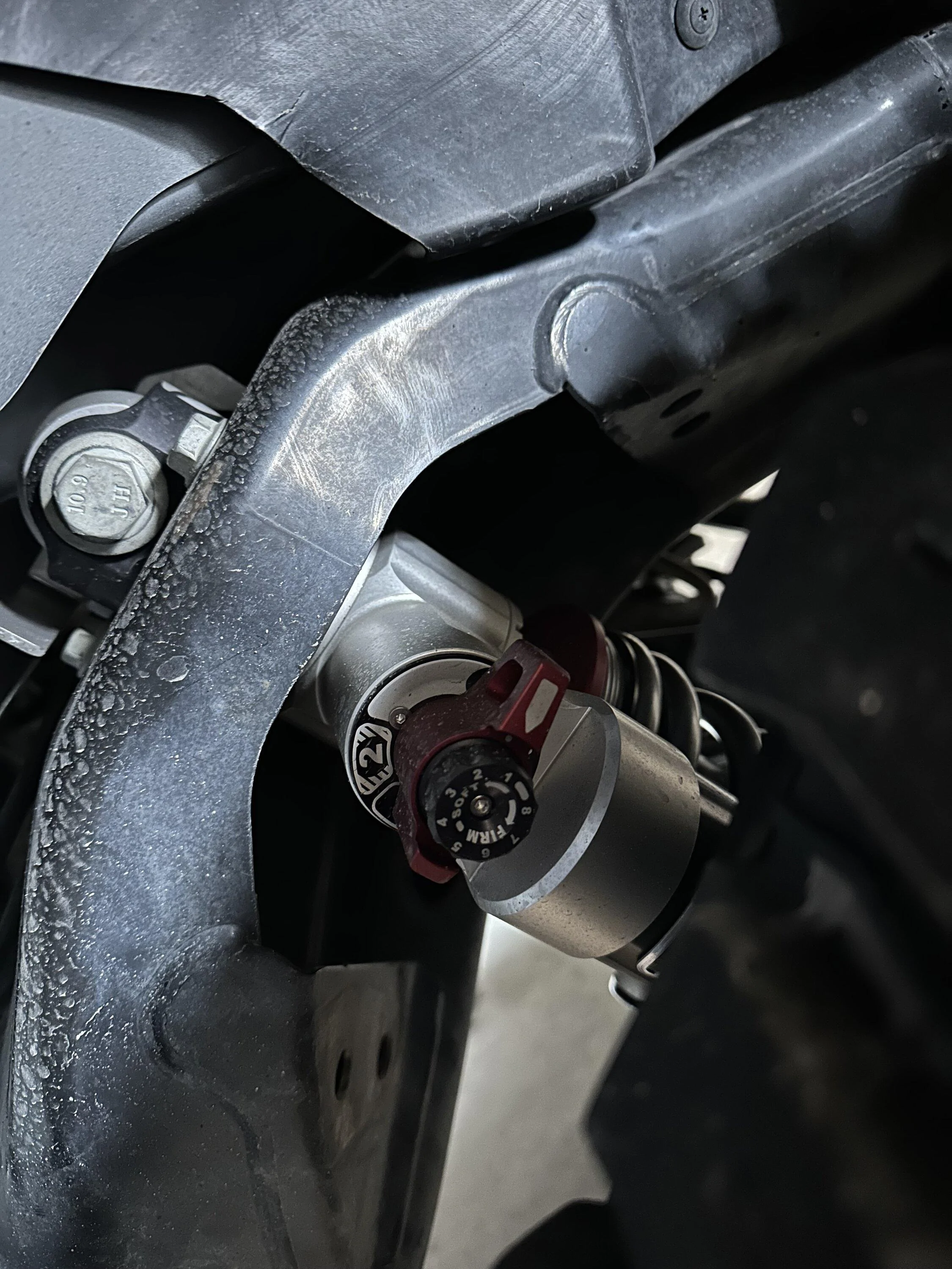

The reason I ditched the fox shocks are because of the ride quality. The adjusters on the shocks wouldn't work anymore and when i talked to fox directly they offered me no help. they told me to clean them and if that didn't work i would need take them off and mail them to them on my dollar even though they were under warranty and they had no answers for me other then that. The actually DSC adjusters wouldn't work. i didn't do anything extreme either on the shocks. Went to Moab and adjusted them as instructed and for some reason they no longer worked after i adjusted them. the preload on the spring wasn't good either. As you can see on the back shocks the travel is terrible. I got them that way. Never took them off or messed with them to ruin the ride quality. just simply went off-road and did on road driving.
I've got about 5k miles on the new falcons and have been in falcons own mule bronco and experienced how amazing they are off-road. I hope this answers your questions. I know your company is big with fox. Like I said I'm not trying to bash fox. i know they make good shocks but i was just extremely disappointed in their bronco product they released.

Well that explains a lot. These shocks were terrible! They would bounce up and down and would bottom out even on the smallest bumps. The dsc adjusters were basically cemented on. Wouldn’t even turn. There were a lot of issues with the shocks. I even took off the DSc adjuster knobs and it was all rusted out. Really really bad. My question is why would they sell to the public pre production units! That is terrible!
I purchased them from rtr and paid full pricing. That Shouldn’t have happened. I don’t have a part number or at least can’t find one on my purchase order. The DSc adjusters are one issue and no I didn’t add any preload because I didn’t want to ruin anything on the shocks. All I can say is it’s really sad a company would sell pre production units without advertising it. I wouldn’t have bothered if i knew they were pre production.
