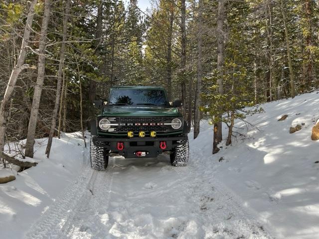

Sorry, been MIA due to work. What are you wanting photos of? Really can't see much once the covers are all installed.
Now I have a 3" Icon spacer/pre-load lift installed, so the photo below is at stock ride-height.
Ford Bronco Rough Country Hidden Winch Mount IMG_3763

Thanks for posting. Do you think this reduces your approach angle any?
